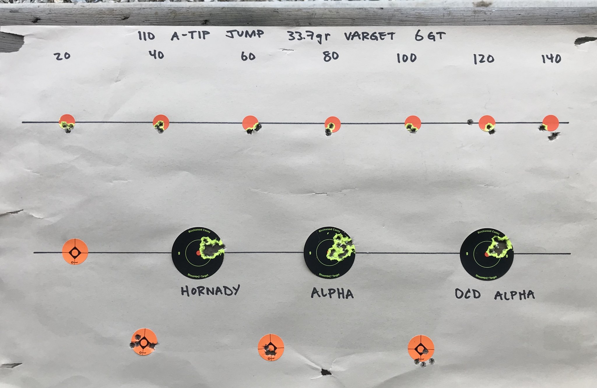

    I purchased a barrel’s worth of 110 A-Tips before the Berger 109s came out, and have been shooting through them this season. Based on the advice of some people already using them, I started at 0.025” jump and haven’t touched them in 800 rounds. They have been shooting awesome and the box value G7 of 0.304 has gotten me hits out to 1375 yds without truing.
    I was hoping SAC would spoon feed us some jump test data on them like they did for the 105 Hybrids haha, but they haven’t released that data yet. I have been time crunched this season, but had some leftover ammo and a free afternoon so I did a quick test on my own. Granted, it’s only at 100 yds but the results are still very promising.
    Specs:
    - Factory AX action
    - 24” Bartlein 5R .237
    - 8 to 7.25” gain twist
    - TBAC 6.5 Ultra 7
    - Alpha virgin brass, CCI450, 33.7gr Varget
    - 2775 fps (don’t ask...my barrel has slowed down ~50fps in the first 800 rds)
    - 2.015” BTO when new. Measuring ~ 0.045” throat erosion after 800 rds using Hornady comparator tool (so likely not perfect)
    - Using “GAP spec” reamer with 0.273” neck and 0.120” freebore
    Here are the results. Anything from 0.020” to 0.100” jump is absolute money. Had some weirdness at 0.120” and 0.140”, can’t say for sure they weren’t fliers due to being impatient with suppressor mirage, but I wouldn’t jump them that far based on what’s going on at the shorter jumps.
    For reference, the top orange dots are 1/2”. The lower orange dots with the black diamond are 1”. And the black shoot n sees are 2”. Those had pressure test rounds comparing 3 types of 6GT brass spanning 3gr of Varget.
    I’m open to debating the cost vs benefit of the A-Tips against a 105/109 Hybrid, but for me they shoot so damn well and the G7 is a real 0.30x, so they are worth it for how little I shoot in a season (will be about 1100 rds total). If I was shooting 3-5k rounds a year like a lot of you, the $0.65/bullet price would get harder to swallow. And for as much praise and critiques the 6GT has received, it has shot lights out for me all year so I can’t complain there. I don’t think I’ve ever got a fast Bartlein and this barrel is no different. I always shoot 24” suppressed so I lose some speed to the normal 26-28” barrels, but I always seem to be 50-100fps slower than everyone I read load data from. I can’t explain why I went from 2830fps to 2775fps with the same load in the first 800 rounds, other than the temp going from 75F to 45F, and my opened 8# jug of Varget absorbing moisture in my basement. I usually use 1# jugs for that reason.
    Can’t really get any feel for vertical spread at 100. If you can repeat the test at 300 or farther it could have some merit.
    40 thou and 80 both look like they string vertically and would look way worse at distance. I wouldn’t say your node is from 20-100 at all.
    I agree. I might try to repeat the test in a couple weeks after my last match this weekend.
    Can’t argue with 1/4 moa and no POI shift across 0.080” of jump though.

    You absolutely can get a feel for vertical at 100yds.
    There is zero need to shoot at distance other than to check BC consistency and true data. Unless you are shooting a static distance like F class and are tuning for positive compensation.
    For practical purpose, 3 shot groups @100 are perfectly acceptable for seating depth assessments and such.

    Have at’er if that’s enough data for you to determine your jump node is from 20-100 thou.
    What’s funny is not once in my original post did I say “the A-Tip jump node is 0.020 - 0.100”. I said jumping from 0.020 to 0.100 is money. Meaning look at the target. If you think 5 consecutive groups at roughly 1/3 moa with no POI shift shows in any way that the A-Tip is jump sensitive, then I’m not sure what magic bullet you’re shooting instead.
    I shot 3 shot groups instead of 5. So what?
    I shot at 100 yards instead of 300, 600 or 1000. So what? I was looking for POI shift with varying jumps, just like the SAC tests are doing. The fact that they group well in addition to that is icing on the cake. Mark Gordon says in his test results that his jump testing isn’t to necessarily yield the best groups; rather the best POI variance in a ~0.020+ jump window.
    You’re also giving me a lot of credit for my group shooting skills to ascertain the vertical spread at distance based on a bunch of (IMO) pretty decent groups. Did I mention they were all shot consecutively with a bipod and rear bag without waiting for my suppressor to cool down? Maybe you can shoot infinite 10-shot groups at 600 that are 1/4 moa but I don’t know that I can.

    Could a 1/4 MOA rifle with a 40 fps ES and a tuner have less vertical than an identical 1/4 MOA rifle with a 20 fps ES and no tuner?
    I think for our purposes “nodes” and “load development“ is almost trivial.
    Modern components being so good + chronograph quality + practical target size really takes the need for nodes out.
    IMO, the biggest reason for nodes in the past was the possibility of charges not being perfect as well as not being able to get a super accurate velocity. You needed a node to make up for that margin of error with those two factors.
    I have yet to hear of anyone losing a practical target size match because they weren’t in a “node.”
    IME, nodes don't exist as most people think of them and how much of the load data/workup dogma suggests.
    Disclaimer: I've only tested this in a couple of different barrels, and only in 6.5 Creedmoor with 140 ELDM's. Things may be different in other circumstances, even if I doubt it.
    Without exception what I've seen is accuracy remains in a happy spot in a powder charge ladder, let's say .6-.9 MOA, until a point, and after that point, increasing powder charge increases group size. I have never seen dispersion come back in to a "high node", even when I go several grains over max published data. The single best group I've ever shot in my life was at 2650fps which printed 20 rounds at 1.01" at 200yd. Most stuff comes in right around 1 MOA +/- .3 MOA.
    As far as ELR goes, it is gambling. Hit probability on a 1 MOA target drops to unfavorable past 500yd with most setups. Beyond 1000 it's something like 5-20% in most situations for a 1st round hit. Past a mile, your best bet is to fire 5-10 rounds before you make any adjustment so you have an idea of how big the cone of fire is, and where it's centered first. From what I've seen you are extremely luck to get ES of under 35fps (I'm not talking about 5-10 rounds, I mean every single round you fire over 50-100 shots in a match, for example) in any rifle, and from a shoulder-fired rifle you're doing very well to have everything within a 1 MOA cone of fire. I would say .5-.75 MOA (again, consistently) is in the realm of excellence.
    If you believe you have a .25-.5 MOA rifle, shoot more rounds and you won't, I almost guarantee it. Even if you tell me your rifle is capable, but you aren't-- I start off doubtful that the rifle is capable-- but that aside, what does it matter if the rifle is capable and you aren't? You're still not holding the dispersion you want to/claim to.
    Vertical compensation is theoretically physically possible but I question the ability to reliably tune it. Having seen velocity/pressure spreads out of accuracy fixtures and pressure barrels, I find it very hard to believe that barrel tuners or 'tuning' powder charges achieves the suggested output to create a mechanical system that compensates elevation spread at distance. I could be wrong but I'm extremely doubtful. Both seating depth and barrel tuners are on my list of things to play with for large sample size testing.
    Another caveat that I have is I question the resolution of chronographs. Even Labradars. I've shot in fixed-screen Oehler setups with Labradars and Magnetospeeds all at the same time for the same shots and while they trend the same, the variance between each is different shot-to-shot, indicating a noise level of somewhere around 5-15fps (which I'm sure depends on conditions) that makes it hard to say with certainty that vertical spread at range does not coincide with displayed MV. That said, I tend to believe in Labradars the most, provided your muzzle blast is not moving the unit around.
    I usually start my loads off at 0.010" and it's worked fine mored times than not. I'm running the ATips in my 6CM with H4350 and 0.010" off and it's been a good thing. Just a thought...
