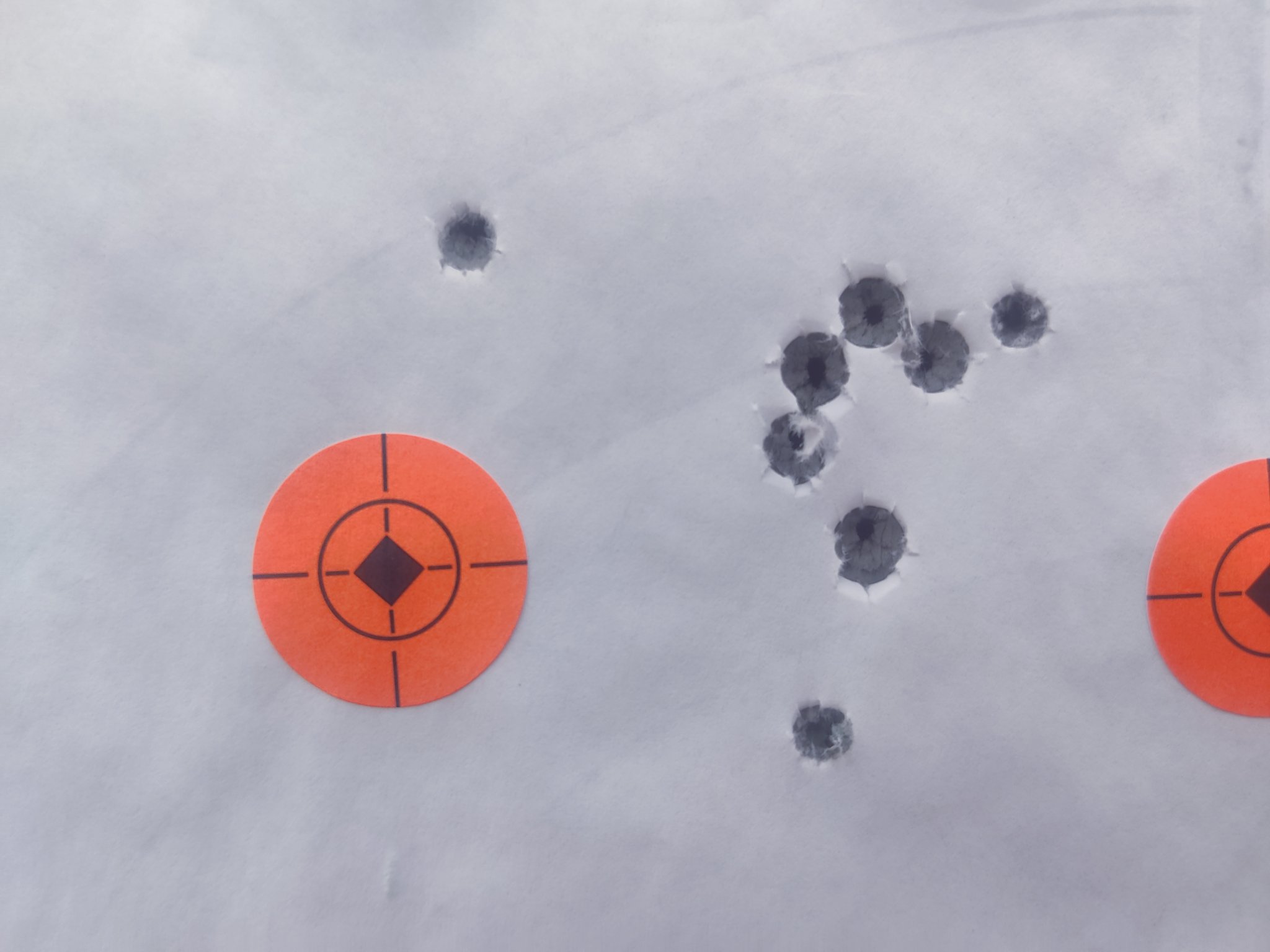

I tried the first batches of 140 RDF's, and they were terribly inconsistent. The nickname they developed, 'Random Damn Flier', is very apt. I think I have somewhere between 1,500-2,000 140 RDF projectiles collecting dust in my reloading room. Should've tried them out first before buying 2,000 of them :rolleyes:
At the end of the day, if you really want lightweight high BC projectiles (that have any semblance of consistency), the logical conclusion is to go to solids. But that introduces a whole different can of worms (chamber design, barrel nuances, cost, splash, etc).
