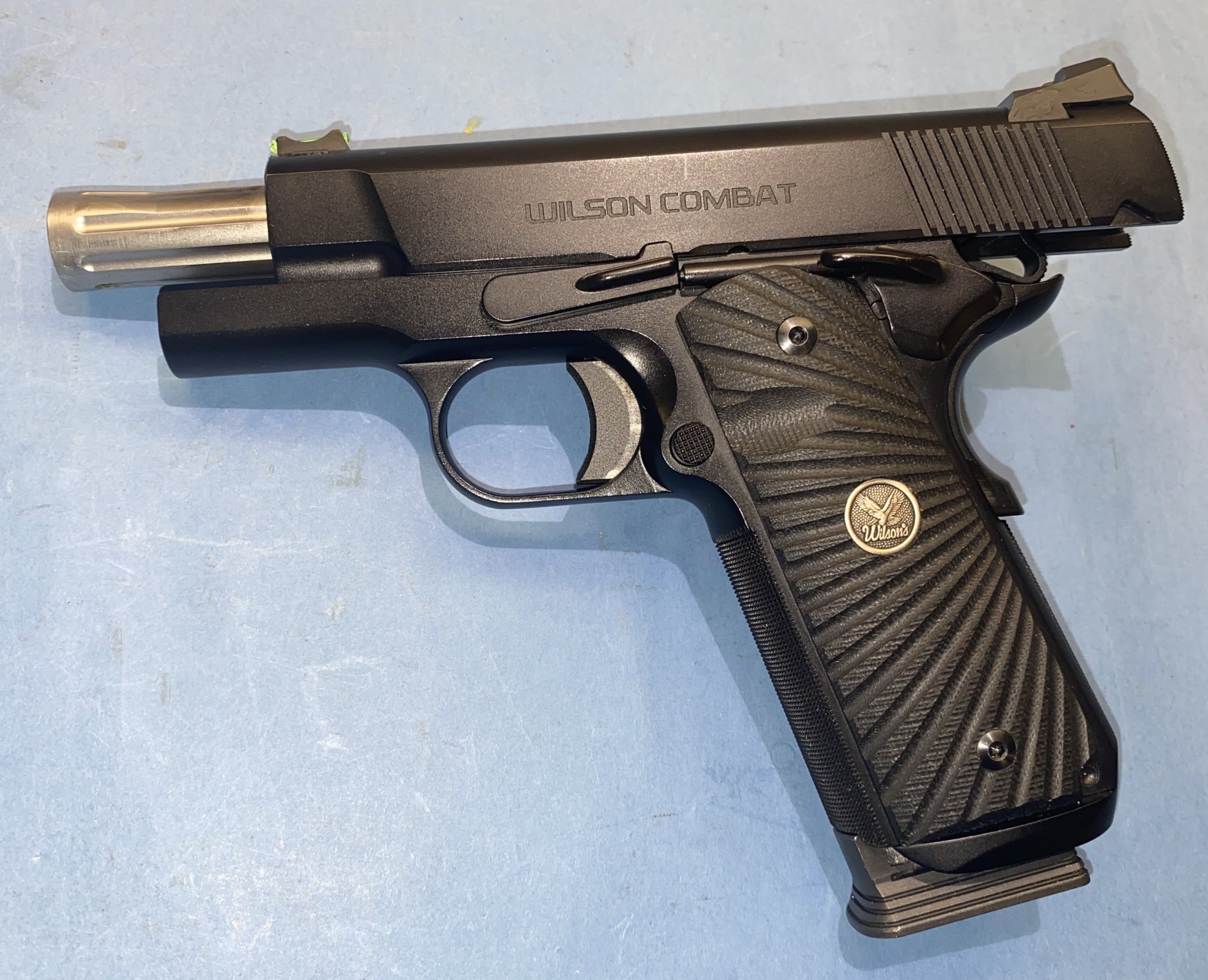

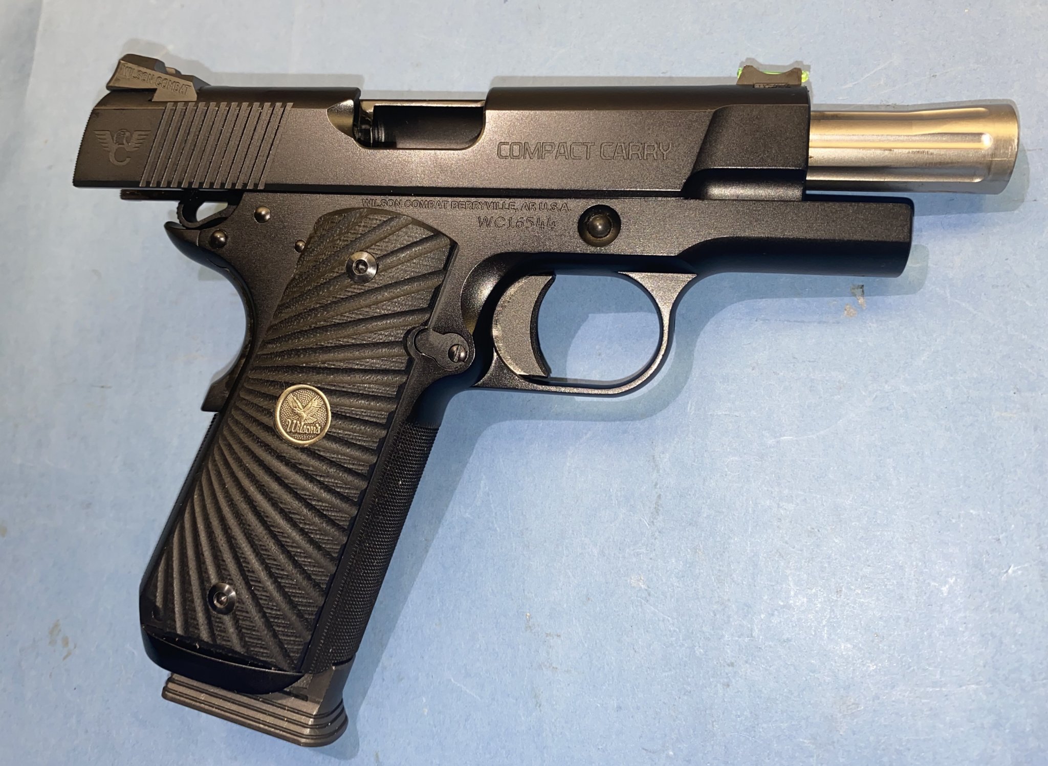

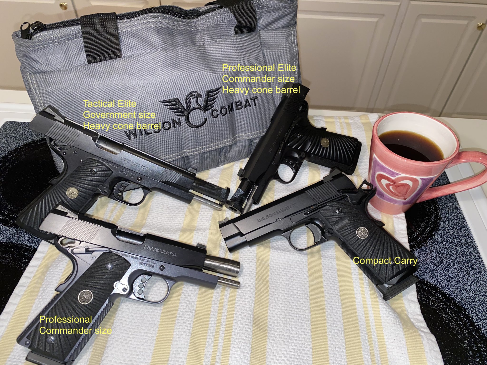

The 1911 Commander size is the 4.25" barrel. I really like the heavy "cone barrel" WC employs in both their full / commander size. I have their Compact Carry in 9mm, 4" with the bull barrel. Both are bushing-less, and do add a nominal front end weight, neither which will not correct poor shooting form any more than heavier tungsten guide rods.

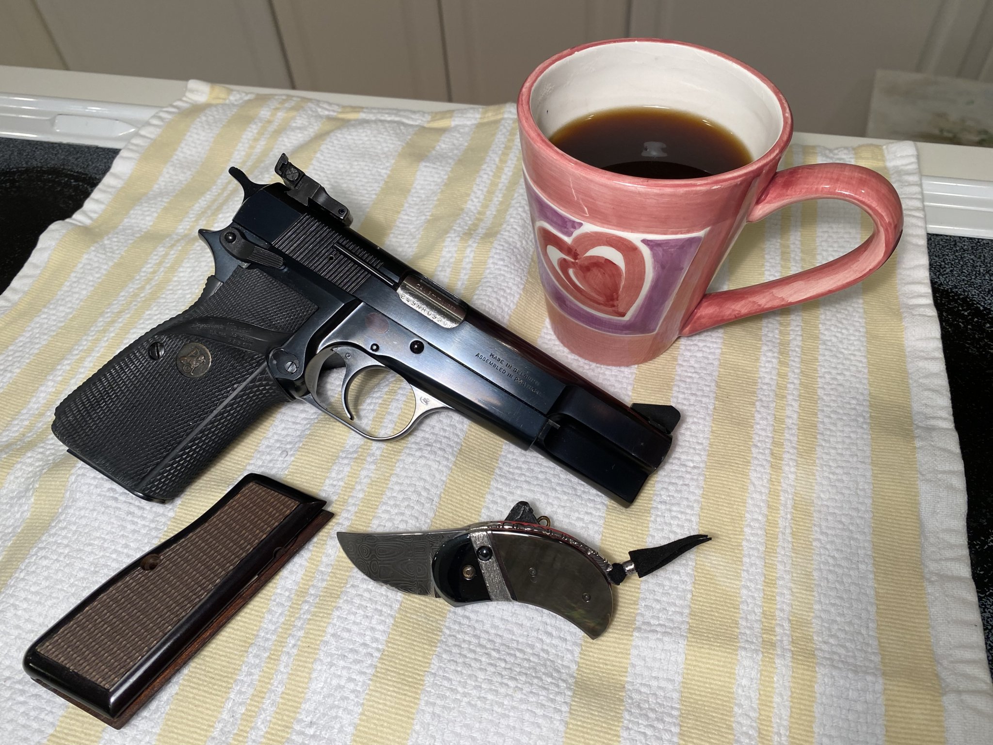

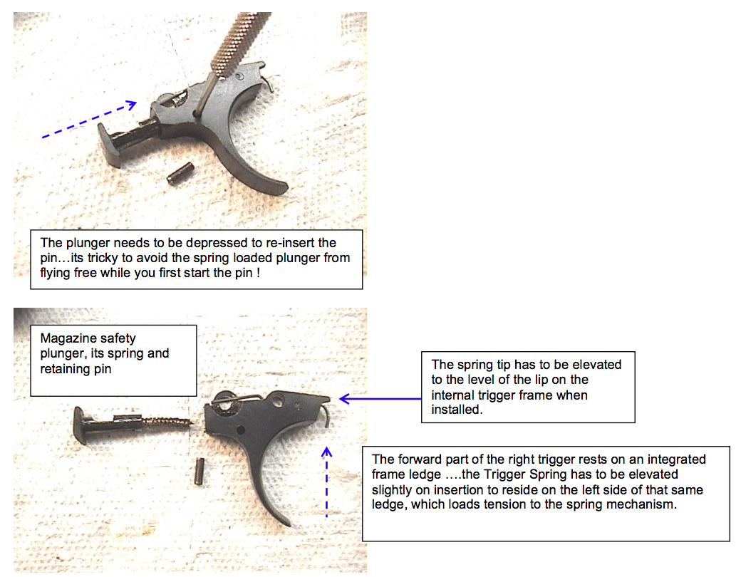

Seriously, the Hi Power fixed the 1911 issues, is double stack and sized for the 9mm ctg.
This Belgium 9 mm Hi-Power still retains its magazine dis-connector mechanism is often complained about cause of a ratchity trigger feel unless all the parts are smoothed over. Many have just removed the mechanism. The wooden grips are handsome but way to slippery for my hands.
