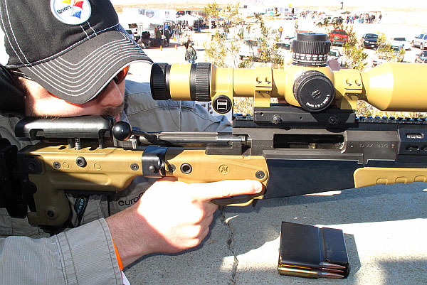

My .300NM rifle has a K624i scope with AMR reticle.
I think the AMR reticle is one of the best ELR reticles out there. I'm a bit surprised you don't see more people with them. Lots of elevation built into the reticle, with 0.2 mil graduations in both windage and elevation. You could shoot out to 2000 yards with just holdovers on this reticle if you had to.
Some vendors are still selling the K624i with AMR reticle. Unfortunately I don't believe the AMR reticle is available in the newer K525.
Reactions: LakuNoc
what is the dingleberry on the bottom?
That my good friend is the angel tear reservoir. The illumination operates off of them using a proprietary fusion process.
But no, it’s the battery compartment. I’d love to have one, if they came in CCW. Just can‘t do CW.
