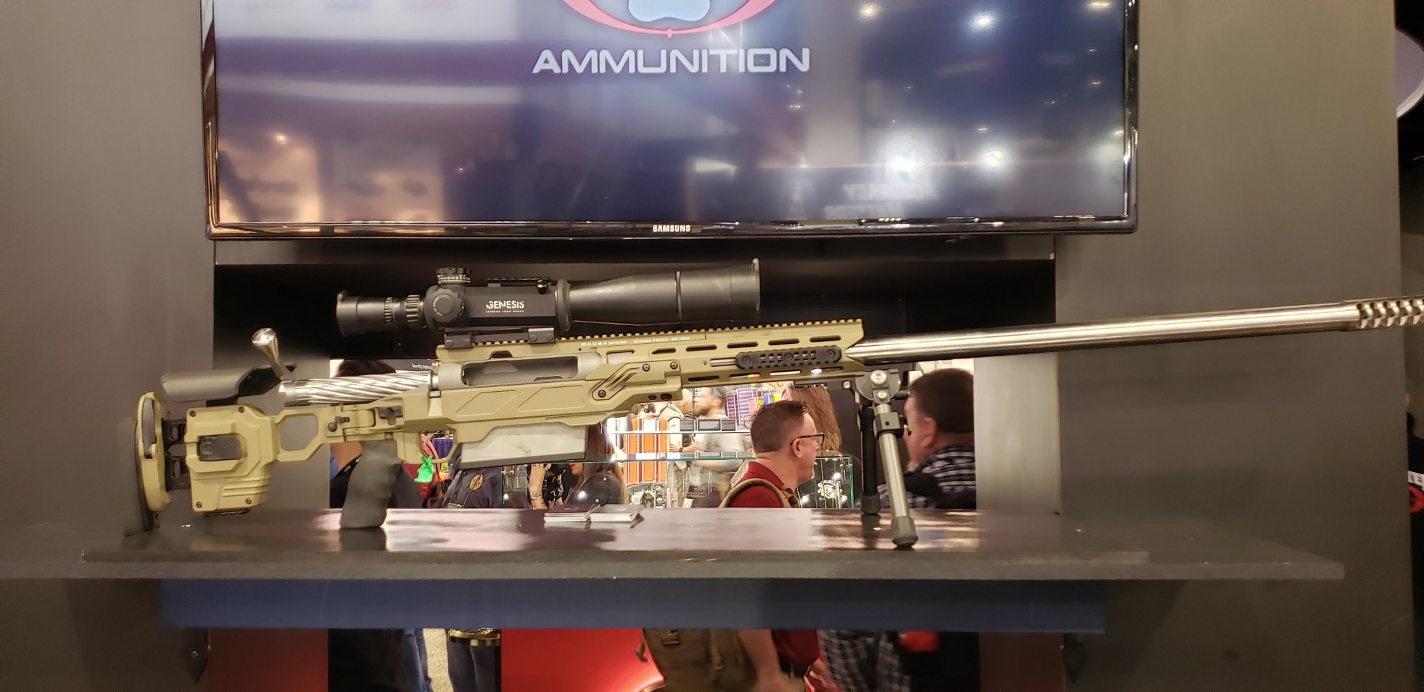

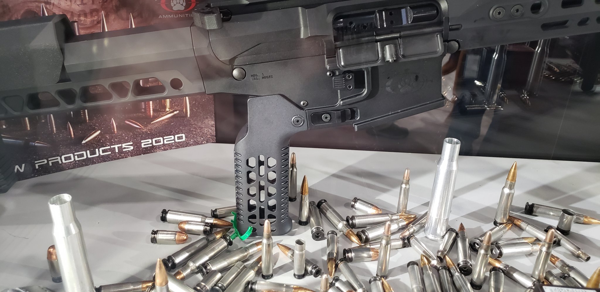

Not to high jack the thread at all but here are a couple of pics of one of the two rifles at the Blackwater booth and of the ammo/cases.
The other rifle was built into a bench rest type stock.
From what I was told the March 6-60x scopes have 400moa of total elevation travel. Scope costs $6k.
I seen some of the test data on the rounds that where fired and the data is real. Accuracy node was at 3350fps but they did hit 3500fps with it and accuracy was still good but was the best at 3350.

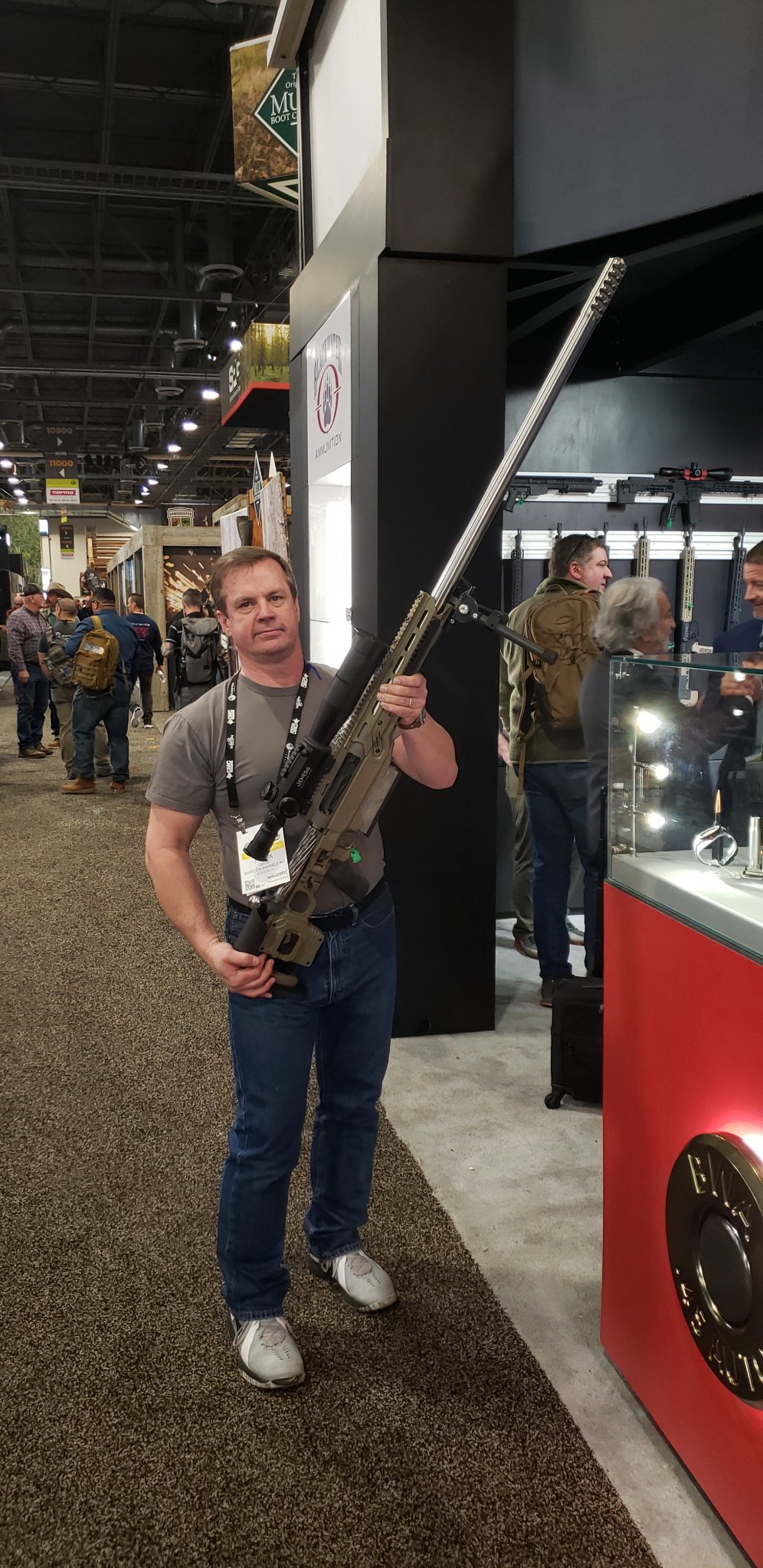

Sorry not really smiling in the pic! My feet where killing me at this point in the day. We we're covering a lot of ground in a short amount of time but the pic gives a size comparison of the rifle to a person. Think it weighed 44# if I remember correctly.
I'd have to look up the spec's to see exactly what we made the barrels to.
Later, Frank
