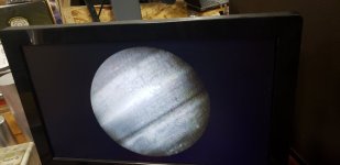

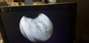

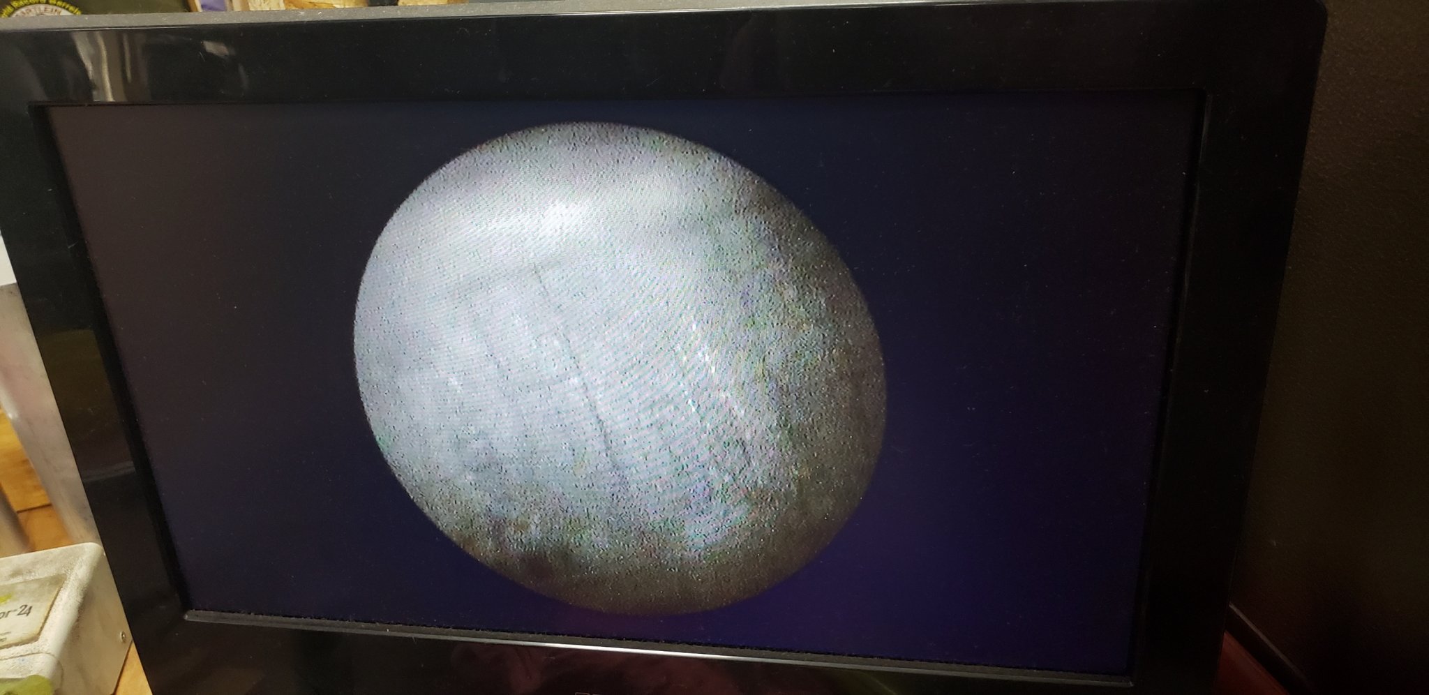

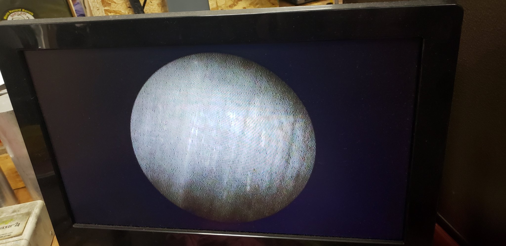

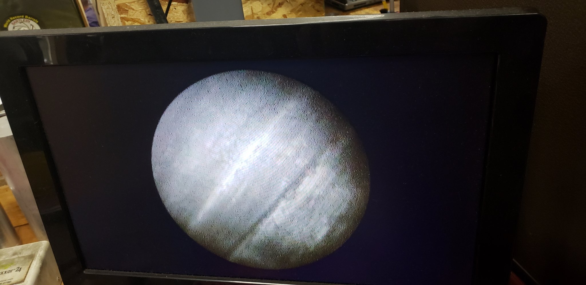

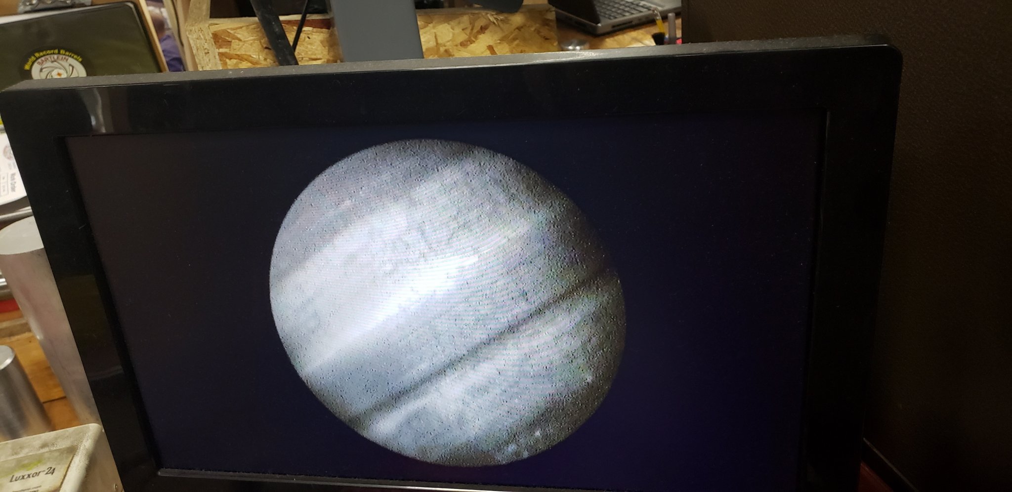

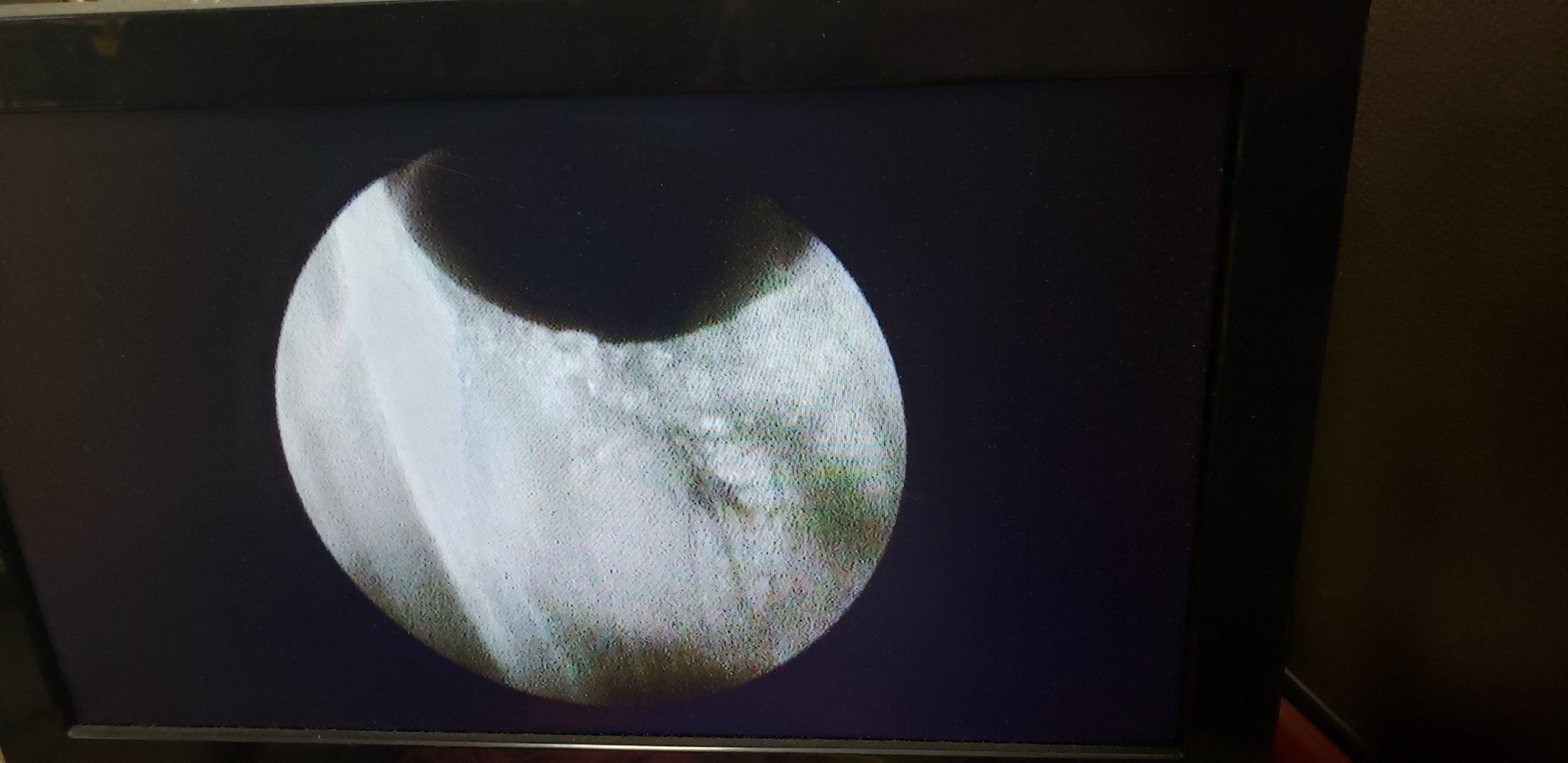

    Got the barrel in today. Five us looked at it. Gas port wear looked really nice. Throat wear is approx. .070". 2290 rounds fired in 6x47 lapua with it running velocities up to 3125fps. The crown was still nice and sharp at the edges. The throat for that round count looked pretty good. No chunks of metal gone from the edges of the rifling and the cracking was pretty decent looking over all. Had cracking but not as much as I thought it would show. Barrel came in dirty which is what I requested. Gonna clean it and take another look at it after cleaning.
    Reactions: 260284 and DarinC
    Any news/photos of how the clean barrel looked inside?
    Here are the pic's. Sorry not the clearest pics. First one is right at the case mouth. The next two are of the gas port area. The next two are of the throat/lead area of the chamber and the very last one is about 3" in front of the throat/lead area.
    Looks amazing!!!
    Reactions: Frank Green
    Like I said....it looks pretty good for the beating it took in my opinion. No chunks out of the sides of the lands etc...anywhere that we could find. The gas port wear looks really good as well. The cracking/heat checking at the case mouth and throat area....all looked better than what we usually see.
    Yeah, that looks pretty decent. Did the guy employ any bore polishing regime? If he didn't, that probably could have gone exceptionally long.
    No bore polishing per say.
    He did use a one patch with JB Bore Compound on it and would run it back and forth 10x (not the JB Bore Brite!) during cleaning every 300 rounds.
    That will help keep the carbon fouling in check but it's not polishing the bore per say and removing material (steel) from the bore of the barrel.
    We received the barrel in dirty. I told him I wanted to look at it dirty and I would clean it ourselves. I only used solvent. Then took the pictures.
