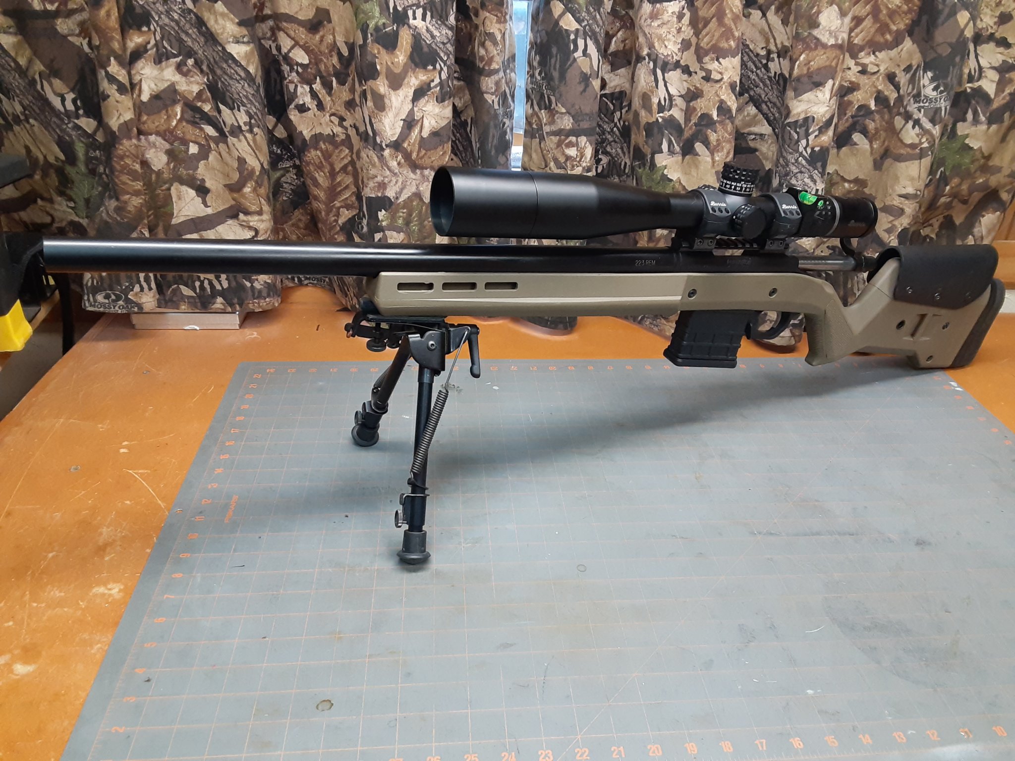

In a long barreled bolt gun (like the one shown above), 223 is very competitive with 308 out to 600 yards. At 800, 900, 1000, the 308 has an edge over the 223. On a very windy day at 600 yards, the 308 has a small edge over the 223. I enjoy shooting my ARs in F-class but found myself wanting a 30" barrel and a bolt action to be more competitive. I just received an extra bolt in 223 and a 32" krieger barrel just for mid-range F-TR. 223 is really fun to shoot. I'll stick with my 308 beyond 600 yards.

Nice rifle - is that what they call a "tube gun"?
