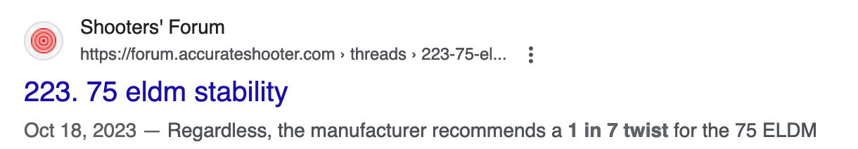

So I guess a million other guys can't read either...Hmmm weird how the hornady book says 8 twist is fine, Hornady techs say 8 twist is fine, and a million other guys shoot them in 8 twists just fine accurately out to 1200 yards. Now why is that? You're telling me they won't shoot in an 8 twist? Lol ok. I mean clearly they shoot decent enough, just not 1/4 MOA...
And FYI, berger states that the 85.5 will also shoot in an 8 twist just fine.
You don't need 7 twists for everything these days.

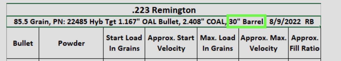

Here's berger's (unpublished) in-house load data for 85.5...guess why its unpublished...:ROFLMAO:
The reason nobody shoots the 85.5? It's too slow in 223 rem, which is why the data for short (ie normal) barrels isn't public. Even inside of capstone, nobody even bothered to pressure test it in sub-30 inch barrels...
In 8 twist, after you punch in slow MV+ 8-10% reduced BC, per Bergers own ballistic/stabilty calculator(s), you will find out the whole exercise is pointless.

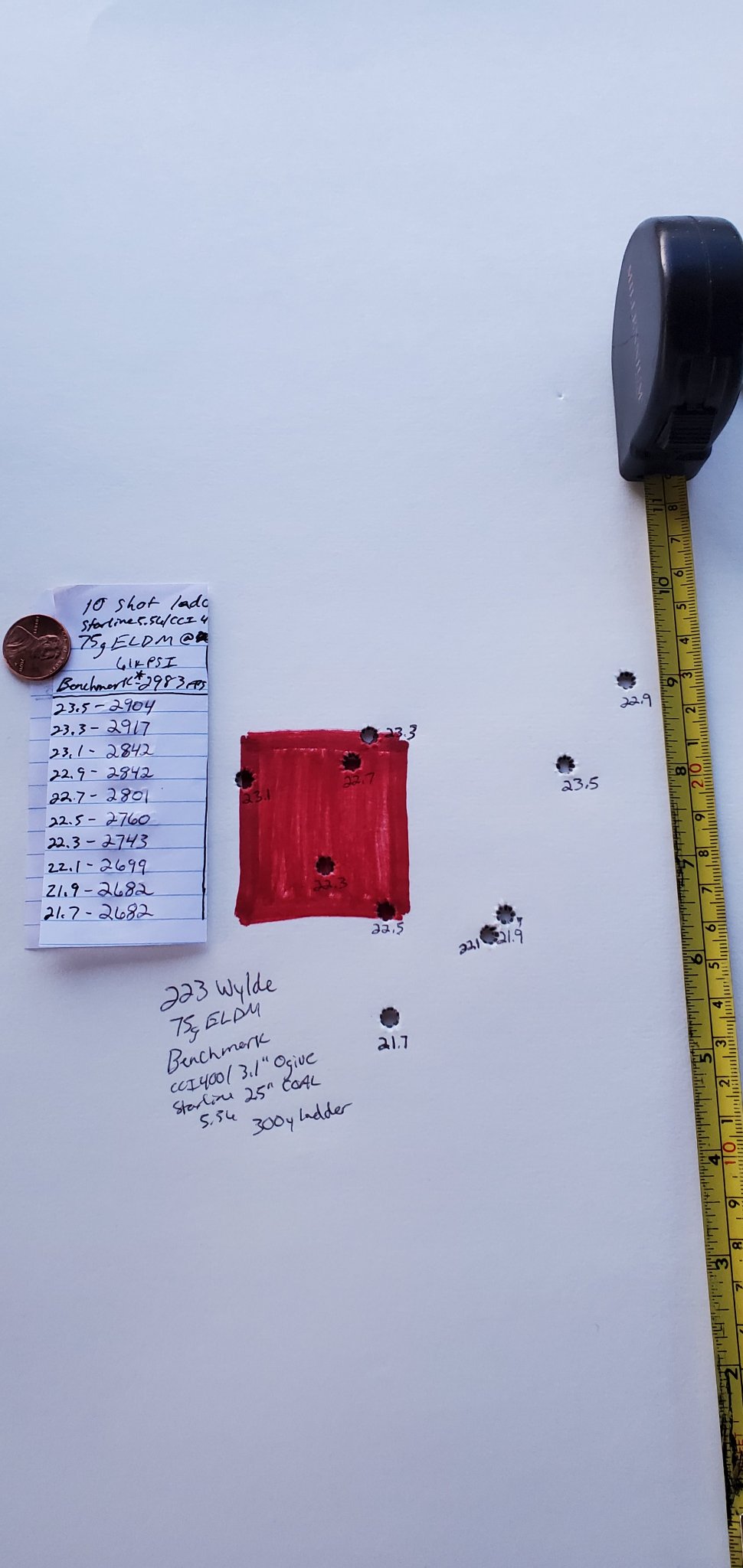

Here was the ladder test from Benchmark

Here's the ladder with 8208XBR and it did ok, but nothing spectacular. Maybe 23.6-23.8 shows a possible node around 2925fps or so, and those 2 shots landed real close to each other at 300 yards. This is the result from it. And I'm down to my last pound of it, and if I'm not mistaken they don't make it anymore? If anything I haven't seen it for a while either.

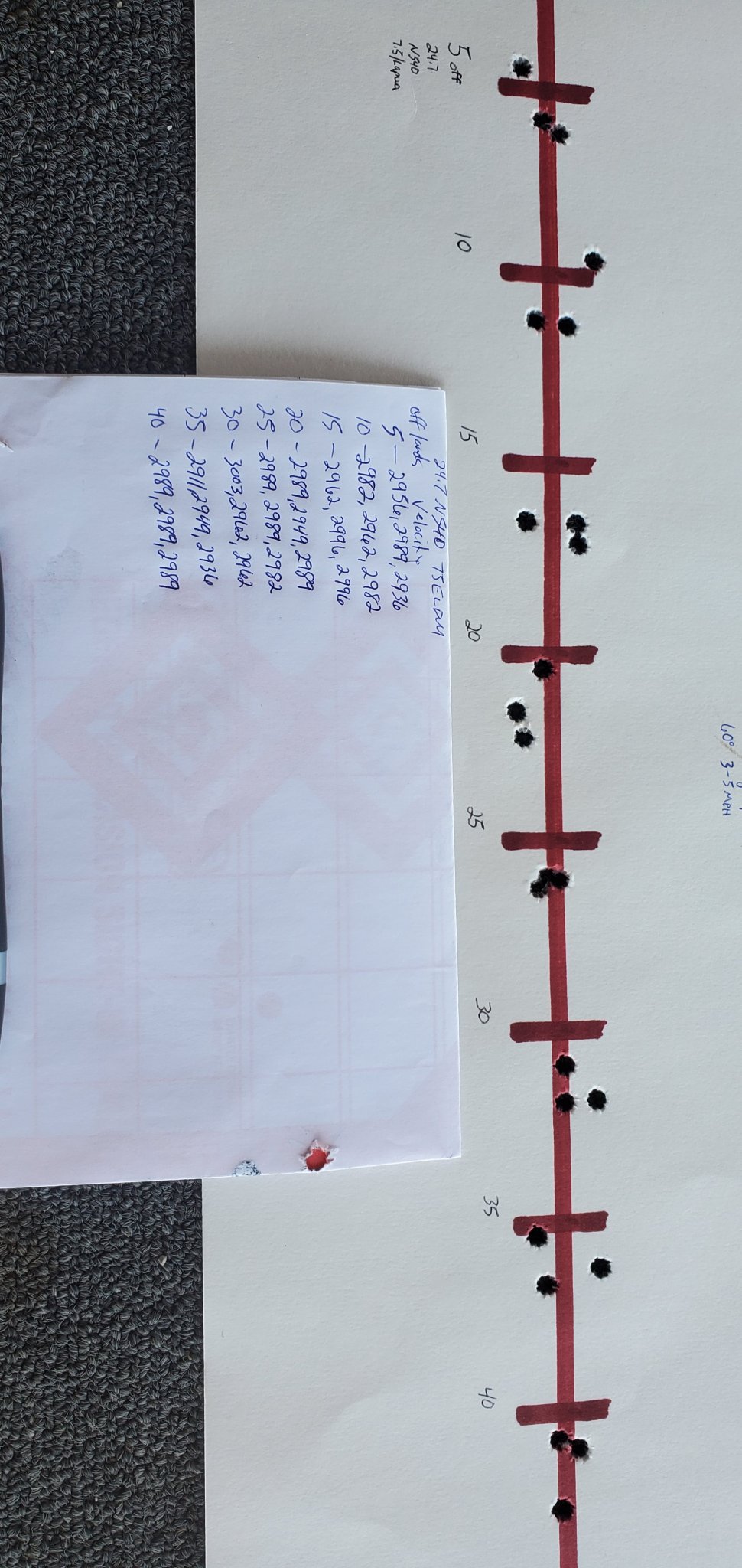

Ok, so just got back from the range with another seating depth test. Did 3 shot groups at 5 to 40 off in 5 increments. Hoping 25 off is repeatable as it's 1/4 MOA with an ES of 7.

I see a candidate for PRIMER SORTING
ES for all shots is 92fps.
Water line for 40 off looks good. ES and SD of ZERO. :)

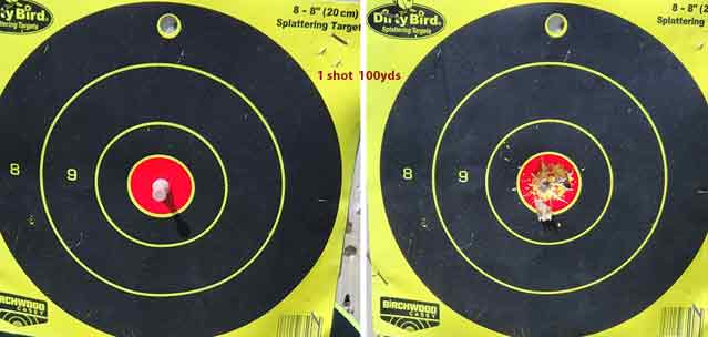

Here's a one shot group @ 100yds.
3016fps, ES = 0, SD = 0.

I'm not sorting primers lol. Never even heard of such a thing...
You don't think the seating depths have anything to do with the ES? Some of them were good, to decent, to crap, just kinda depended on the length really looks like. That one shot at 35 off at 2911 is what screwed it all up.
I'm gonna load 10 each up at 24.5 and 24.7 at .025" off and shoot a 10 shot group at 100 and see what they do. Will probably just go with whichever one shoots the best and call it a day. Getting tired of this load development already and want to start the real fun which is 300-1K dope confirmstion every 100 yards. And then it'll just be time to play and shoot.
