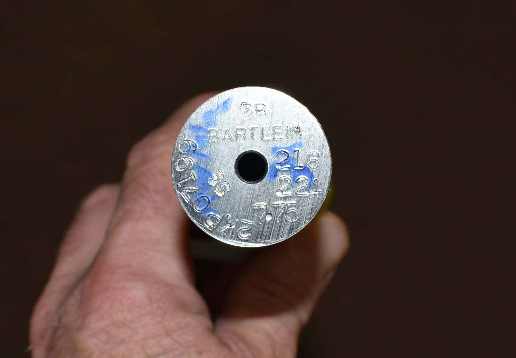

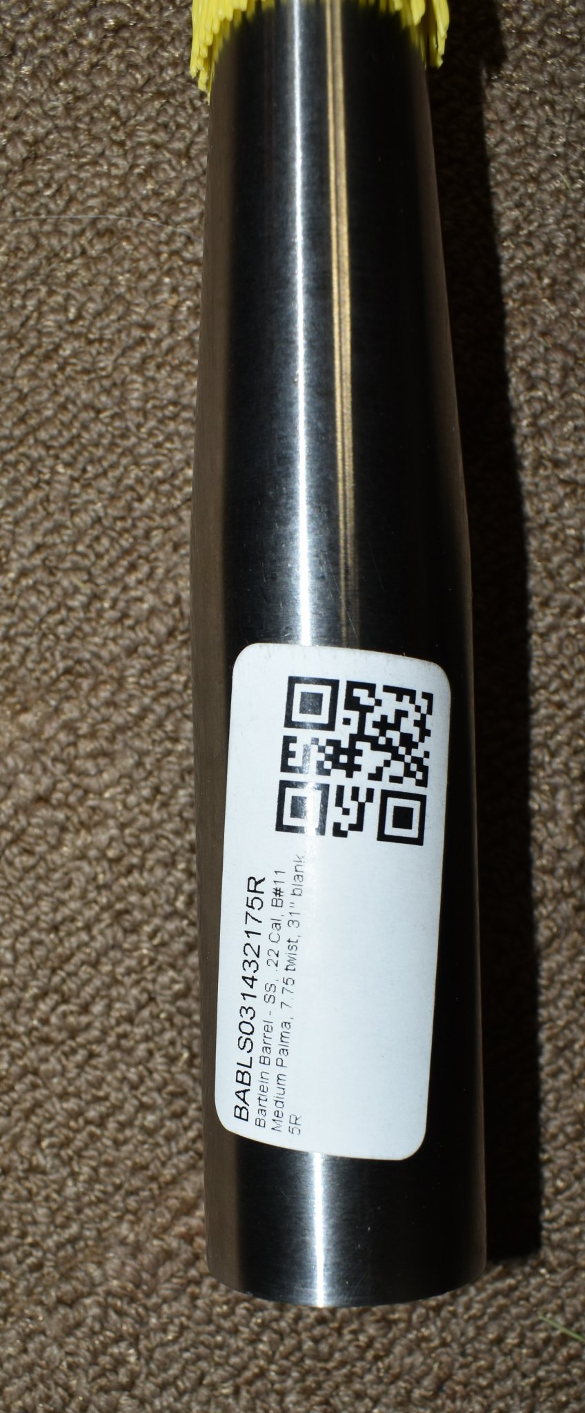

The barrel came in today. I don't see any 7,75 twist barrels listed on their website. Perhaps this was custom made for someone??
