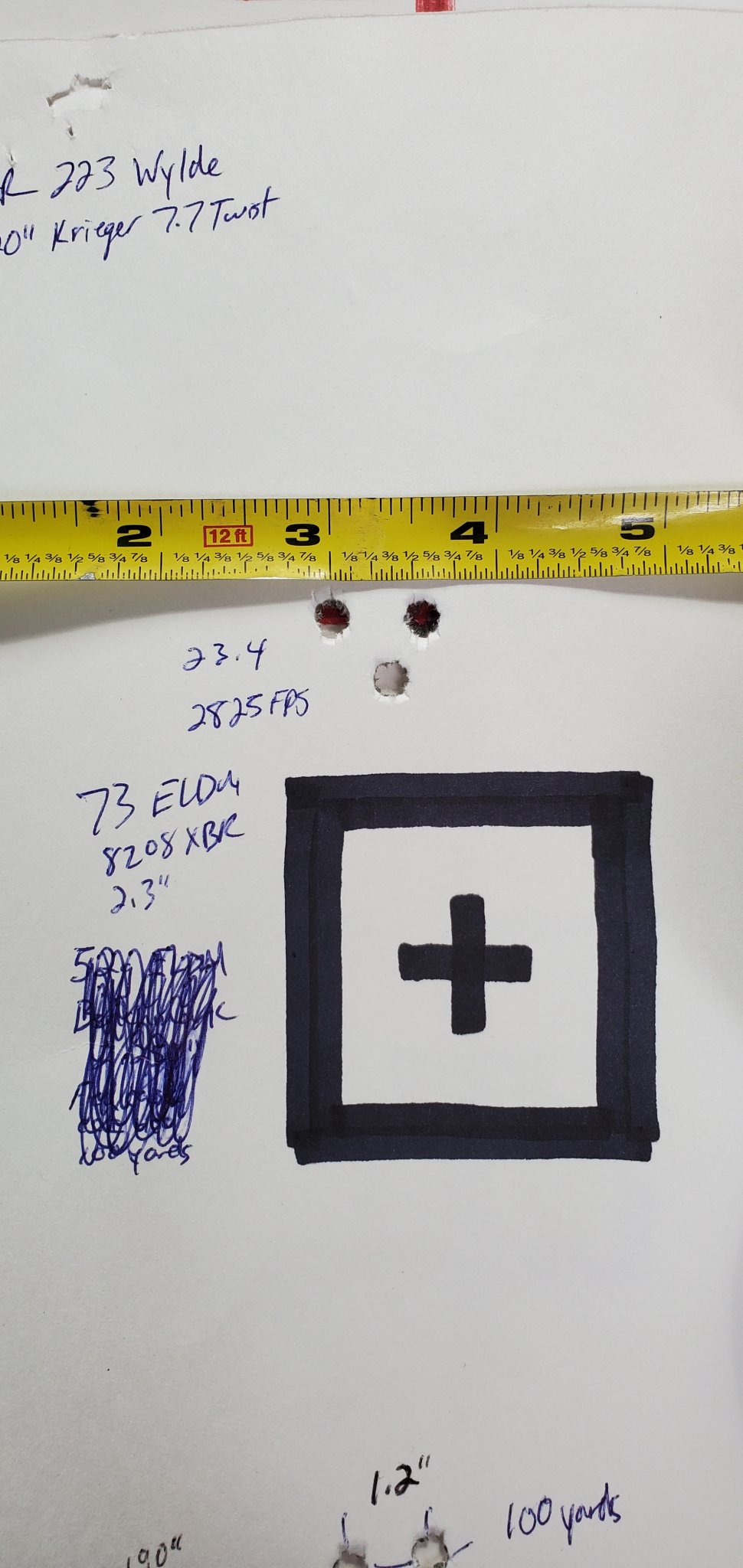

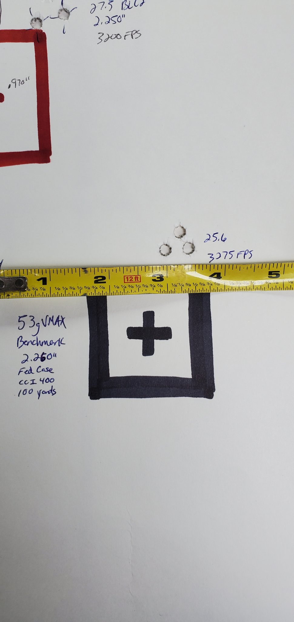

Finally got out to test a couple loads in my AR. Loaded up 53g VMAX at 2.260" over Benchmark and 73g ELDMs at 2.3" over IMR8208XBR. Both out of ASC mags. These were the winners from each. Not to bad for throwing some loads together. Probably won't change a whole lot. Bout as good as I can do with the funky 2 stage trigger and springy recoil of these ARs. The 53 vmax will make a nice truck/calling load for dogs, and the 73 eldms can play out to 800 on steel.

Both of your groups look nice but I would use a larger number of shots (I know you know that though). I can't remember when XBR8208 was ever a bad choice for finding a good load. Maybe not the fastest or most accurate combination but never a bad choice.

I just like the 53s for dogs since they are quite a bit faster/flatter. Don't have to worry about things out to 300. But they aren't the best for longer range either.
I'll load up 10 of each of those and then probably just shoot a 100 yard group and see what they do. If they're not to bad I'll just go with it.
