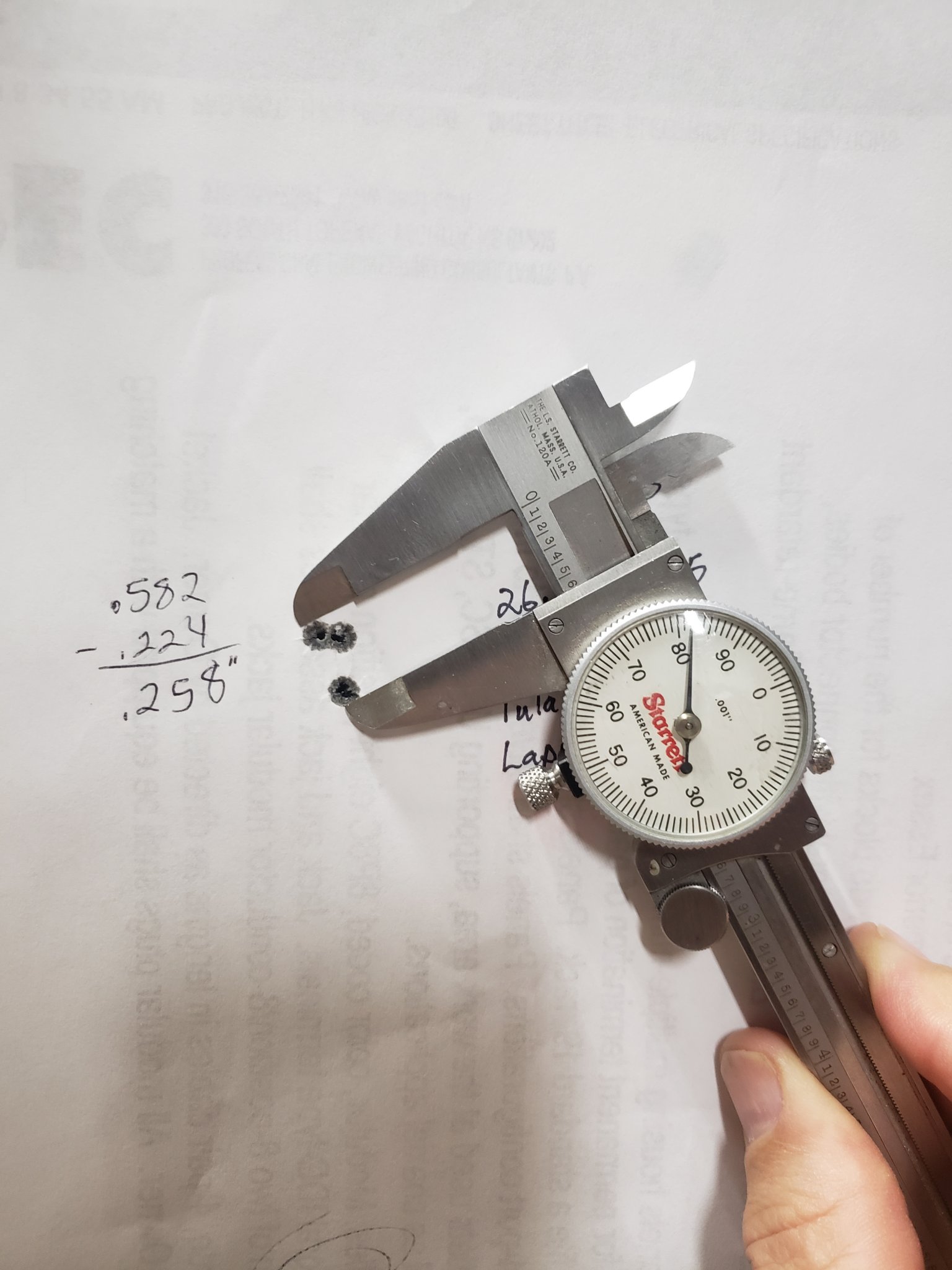

    I will be interested in seeing how it compares to my 22BR with the 88gr ELDM. I am almost finished shooting my virgin Lapua brass and will have to tweak my load for the once fired. I loaded up 10 in 1x fired and my velocity was about 45 fps less than the new brass. I am running a 26" Bartlein, so it should be a good comparison.
    I think barrel life will be the biggest comparison of these 2. How much powder you getting in there with the 88's?? I also like the cheap but nice brass of Starline as well. Testing will be interesting for sure.

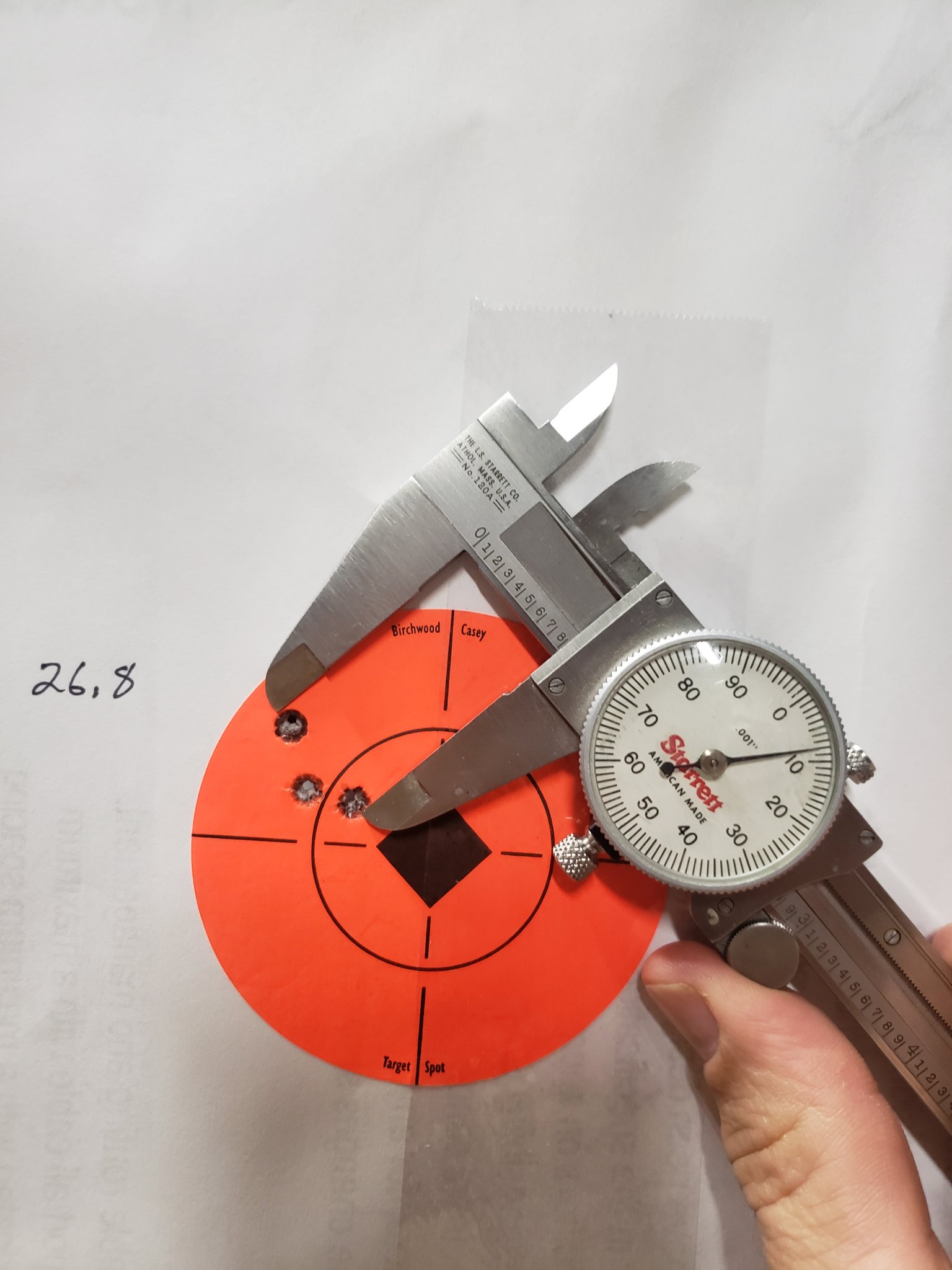

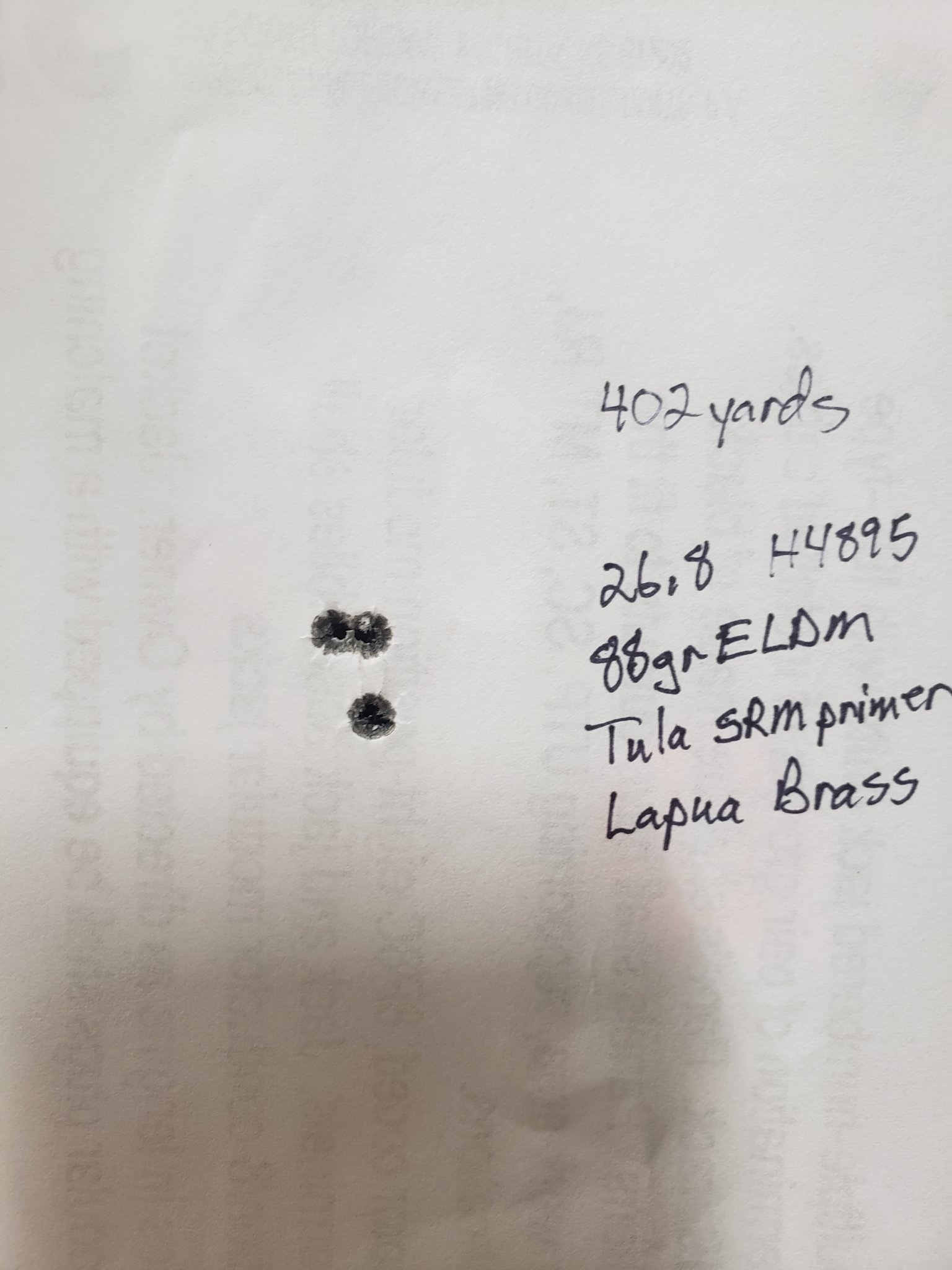

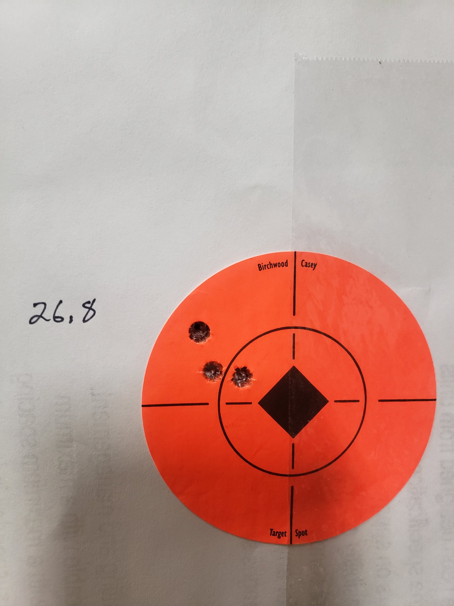

    I am using 26.9 gr of H4895 for 3000 fps and SD of 4. I will probably try 27 , 27.1, and 27.2 for my final load. I was keeping it mild as I shot in a Border War match last Saturday and the forecast was for rain.

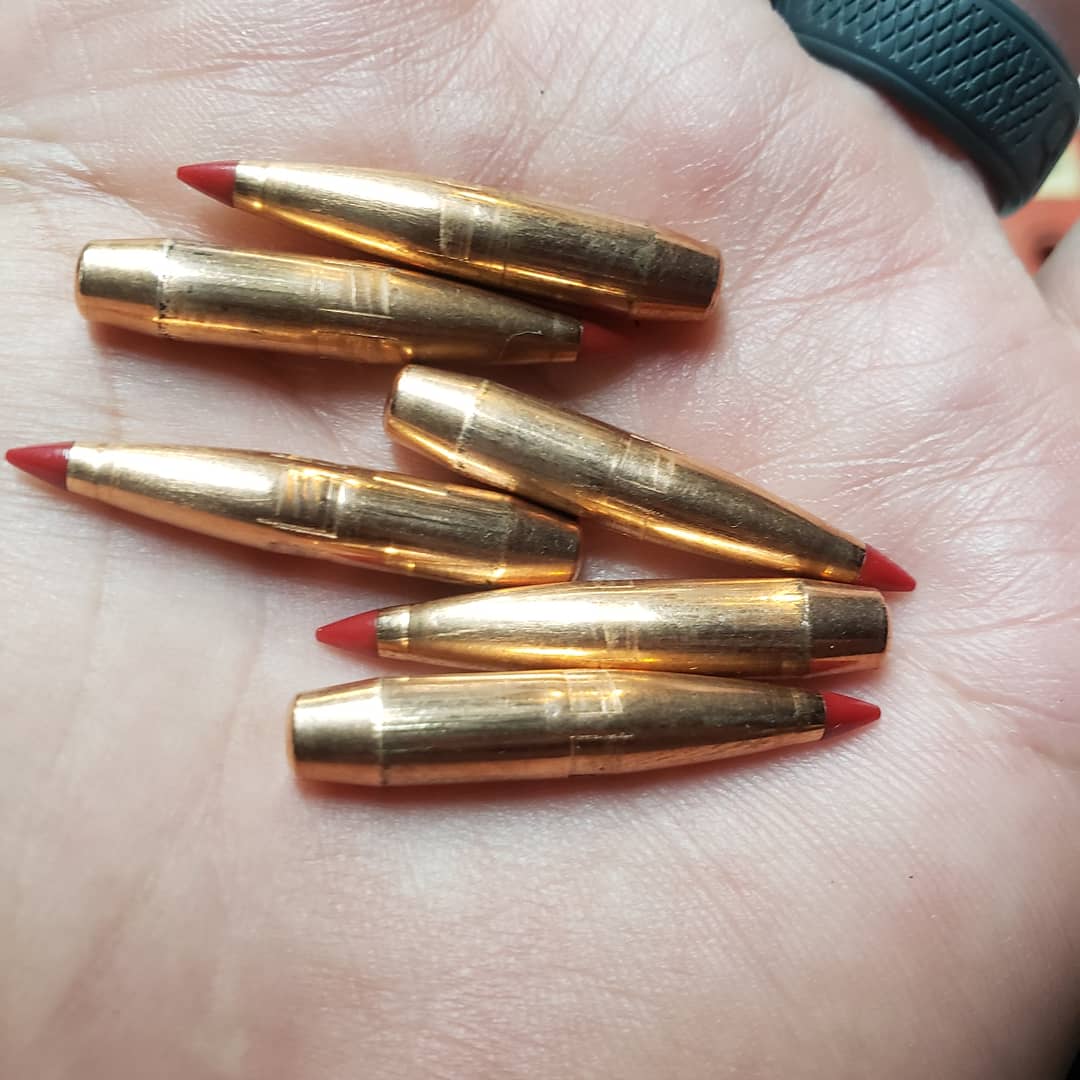

    Funny you mentioned the seating stem putting a ring on your bullets. My Redding seating die did the same. I pulled some bullets with a Hornady collett puller and it left marks on the bullets with the rings. I picked up a micrometer vld stem and loaded some of the pulled bullets to use as sighters for a 400 yard ladder. I am tempted to go back to the old stem.
    I shot two 3 shot groups with the pulled bullets and would not have shot the ladder if I had seen how they turned out.
    Oh wow ok. We might be vary close then. Those groups look good. Whats your COAL on those rounds?
    I am at 2.260" COAL. I bought a 22BR Manson reamer with a .050" freebore no neck turning needed. I am using Lapua brass and the standard Redding 22BR dies give me less than .002" neck tension. The 88gr ELDM touches the land at 2.282"

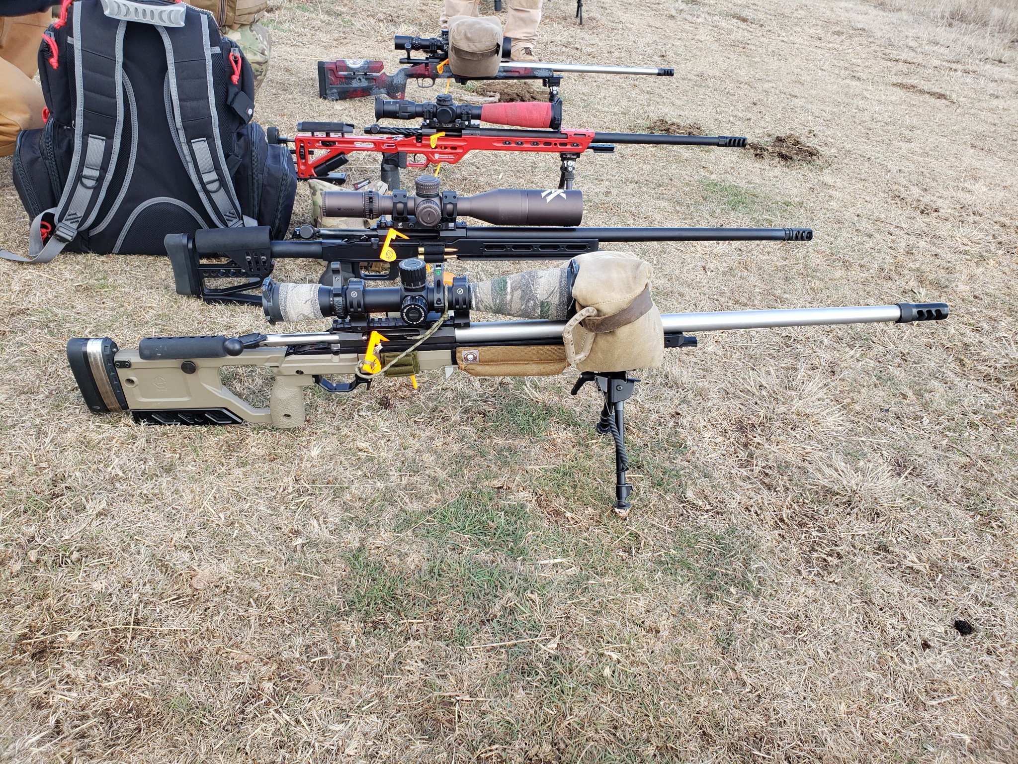

    The MDT 12 round magazines with a modified PR kit hold 13 rounds no problem.
    My rifle is the Tikka in the X-Ray.
