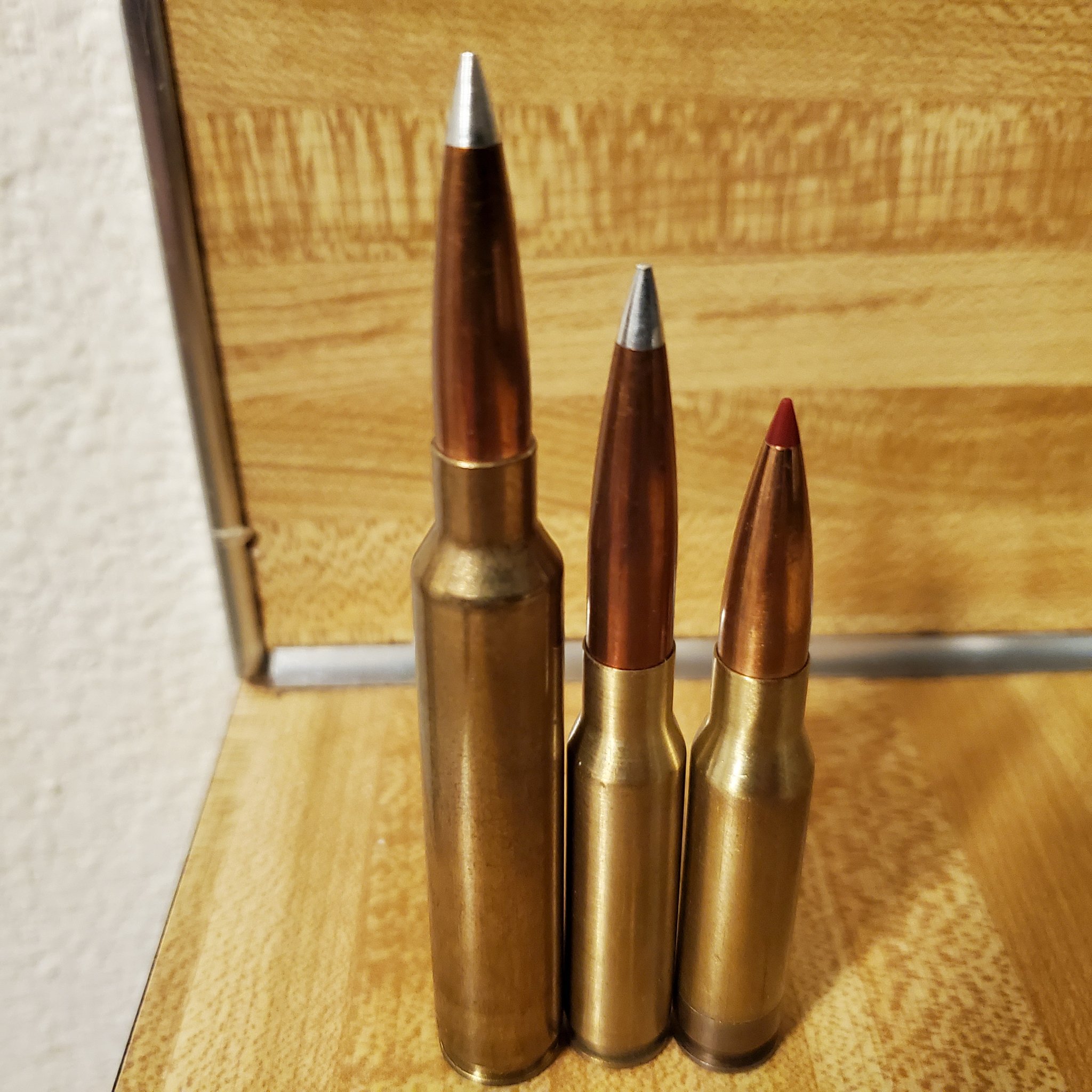

Max effort 250 Atip 308, next to 4" 300 RUM 250 Atip at 3000 fps, and a 80,000 psi hybrid case. This center 308 load with 250 Atip will get 2500 fps with a 308 case, 30" barrel 8 twist long action, aluminum chassis rifle.
Which "80,000 psi hybrid case" is this?
Sure you can load them. Your 308 velocities with the same barrel length are 100fps or so faster than 30-06. So they about 250fps past normal pressure in a 308. Posting that without pointing out what you are actually doing, so random internet mouth breathers think it’s cool, is pretty dumb. Those velocities are for 30cal magnums, not for some guy hotrodding his pea shooter. Be honest about what is necessary to attain your velocities with a 308.
I know, most of my 308 loads will hang with or better than many of the 300 mag types in factory loads in their factory 24 and 26 inch barrels. All that accomplished with a 308 30" 8 twist, LA in alum chassis with much better accuracy in the 308 case, mag feed. The barrel was originally for a 300 RUM project, to increase the barrel from 26" to 30" to fire 250 atips at 3100 fps, but I chambered it in 308 Win and never looked back after the performance I achieved out of the 308 case. But the 22" 9 twist is a 7.5 lb hunting rifle with a slightly shorter lead and has excellent performance, heavy bullets is where it's at 200 to 230 gr. It likes the 200 gr SMK .715 BC 2740 fps & the 230 SMK at 2500 to 2550 fps .8 BC The new powders and bullets .715 to .878 BC make it possible. Learn to take advantage of newer developments ...problem is availability of components.
