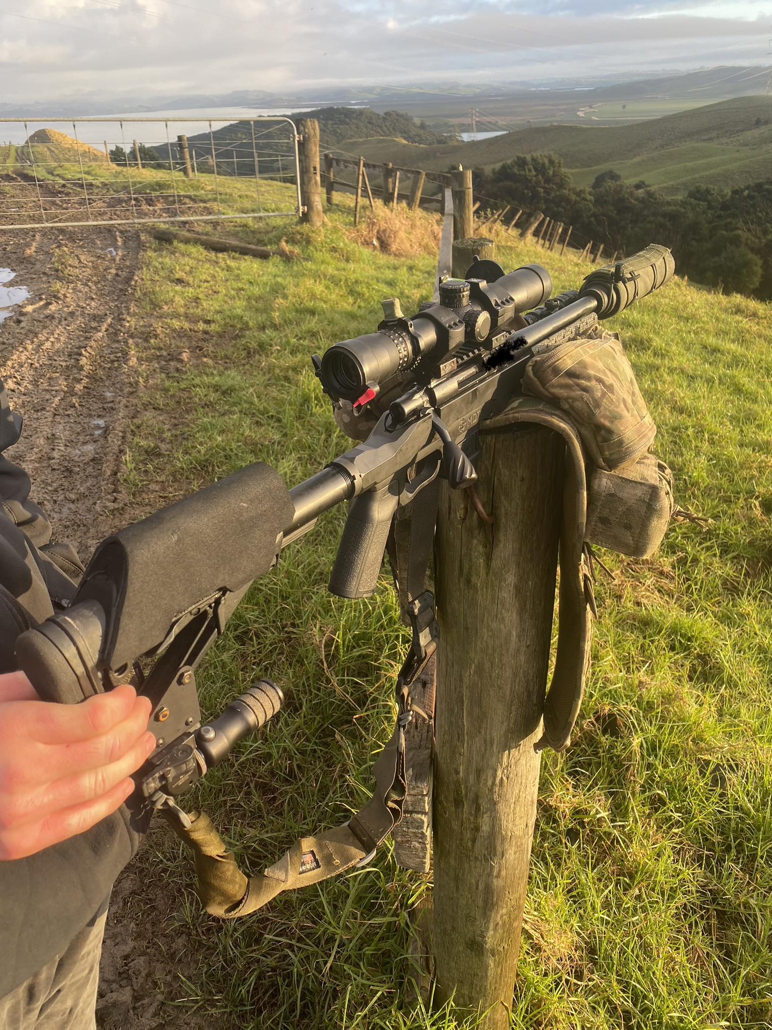

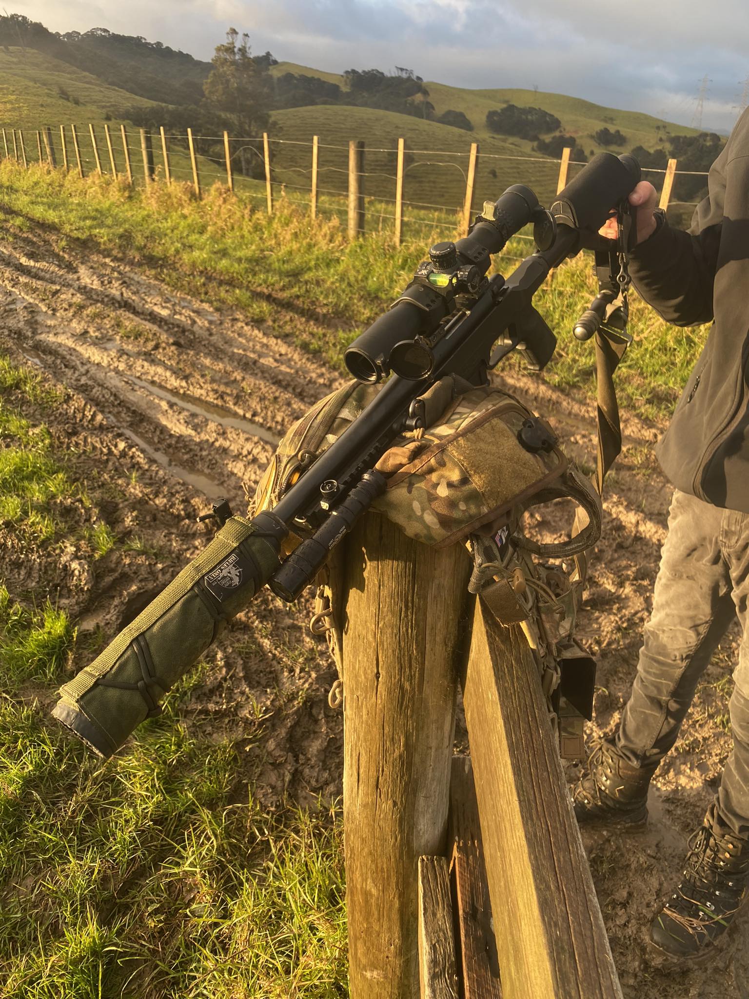

My Howa Mini 1500 in 300 BLK - set up for 300m shots on pigs and Fallow Deer.

That’s very nice. What are specs? What ammo are you running out to 300m?
Thanks
Cheers. It's a Howa Mini 1500 chassis with a 14.5" barrel in an MDT chassis fitted with a Magpul CTR stock and a custom made cheek riser. The scope is a Nightforce NXS 2.5 to 10 x32mm objective and the suppressor is NZ made by DPT wrapped in a Rifles Only MAD cover. Ammo is Aussie made Buffalo River 135gr Sierra Game King HPBT which takes nearly a second of flight time to reach 300m but hits hard with brutal expansion.
