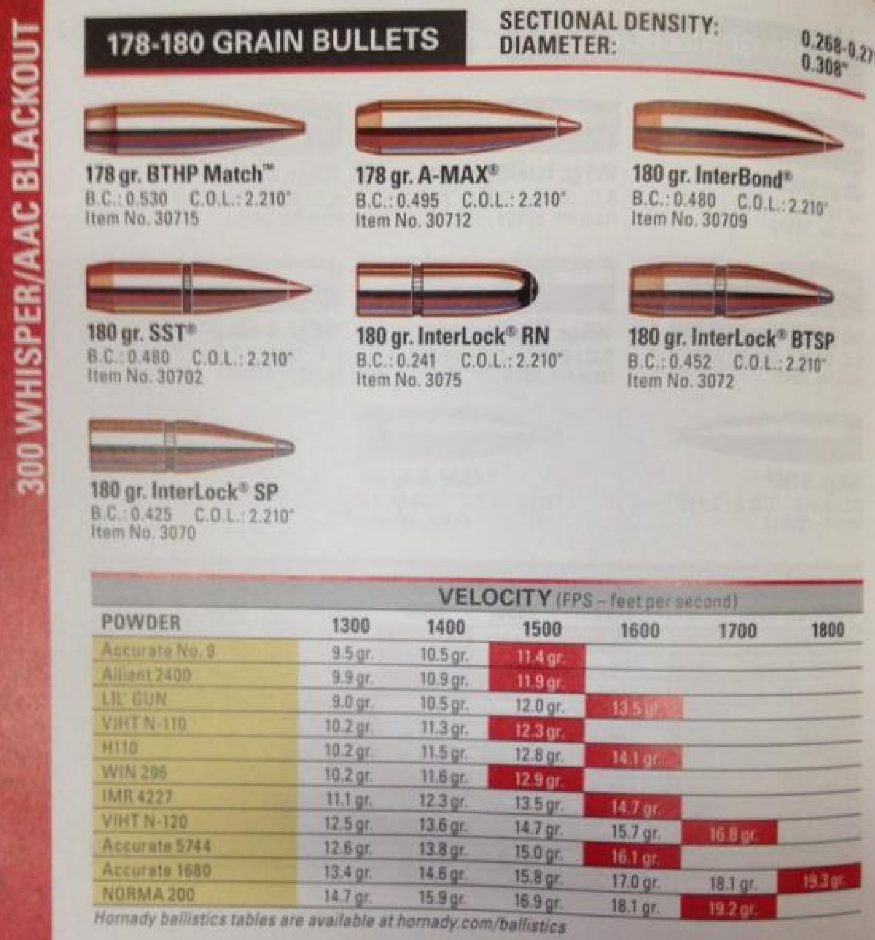

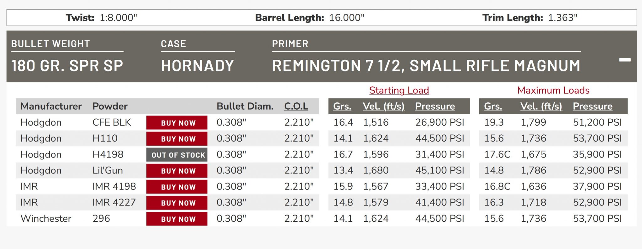

Does anybody know if its possible to create a load in 300 blk with a 180 grain bullet? Specifically the hornady softpoint flat bottoms. I have a bunch of these bullets for 308 hunting, but I was thinking I might be able to put them through the blackout. I have cfe blk and 1680 and a 10.5 in barrel to run this all through.
If anybody's done this before that would be helpful, especially if you have a load that works and won't blow up the gun or cause squibs.

Hmmm the hodgen and hornady data seem to indicate that you are unable to. However if wvfarrier can get 176s to go sub I guess the 180s you can too? Whats your load for the 176s?
