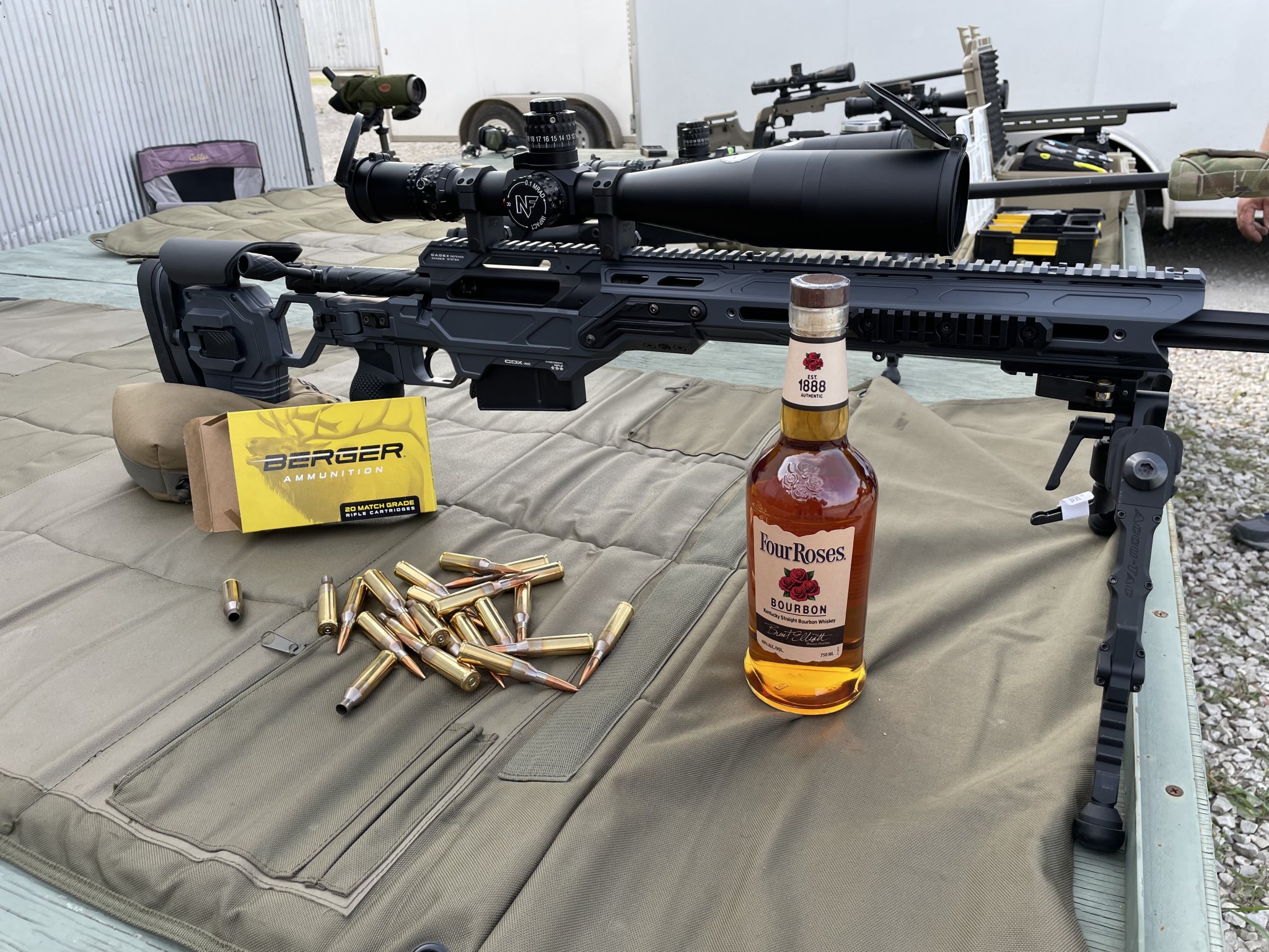

I'm in the Norma camp but also have a few PRC barrels and hunting rifles. Norma for 2000 is an easy button. Found it more consistent shooting the 230s from the 1760 to 2600 yard targets. PRC still did fine at the 1760-2k targets but the Norma just did it better.
@MACHTECH @tnester1 @lethalsquirts @SkyScrapin @Glassaholic
At Rebel Ridge here. All these rifles are in 300 Norma Mag.
The 300 nm is the easy button. I had an AXMC in 300 nm that was a hammer, and @MOUNTIC hooked me up with a sick AXSR in 300 nm. Both performed excellent. Easy to load for and they just shoot, period. Just my .02 cents.
