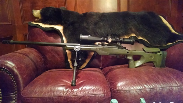

I had Altus spin up a 300 norma last year with a 787R and Bartlein cf barrel, and then put that in a Manners LRH stock. It's the only rifle I've never considered selling after hunting season.

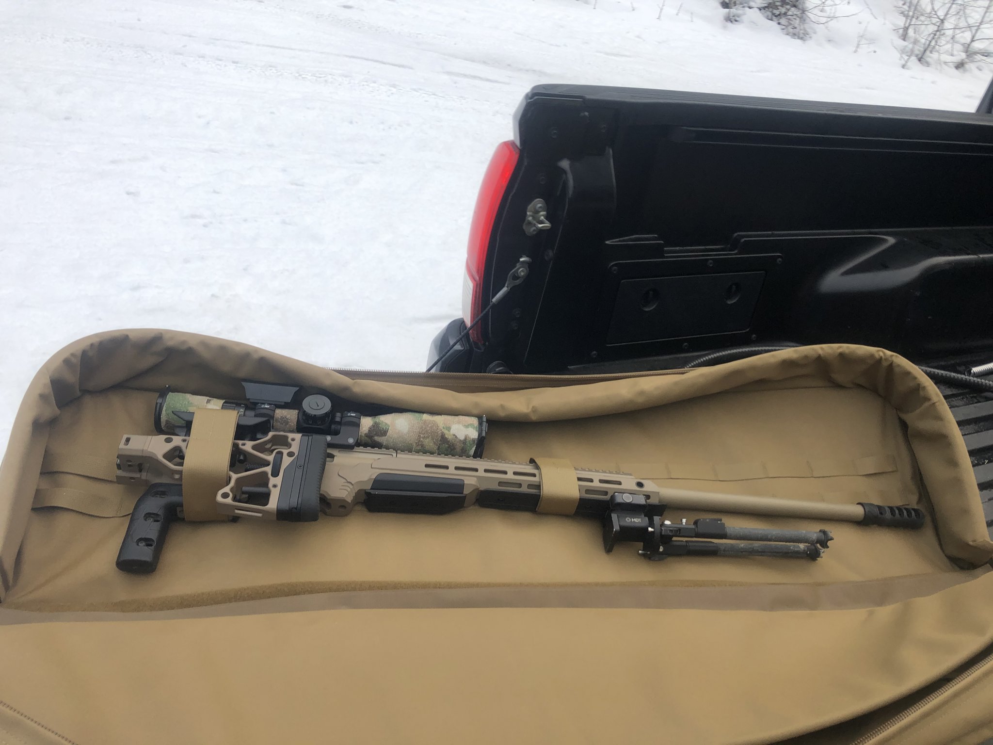

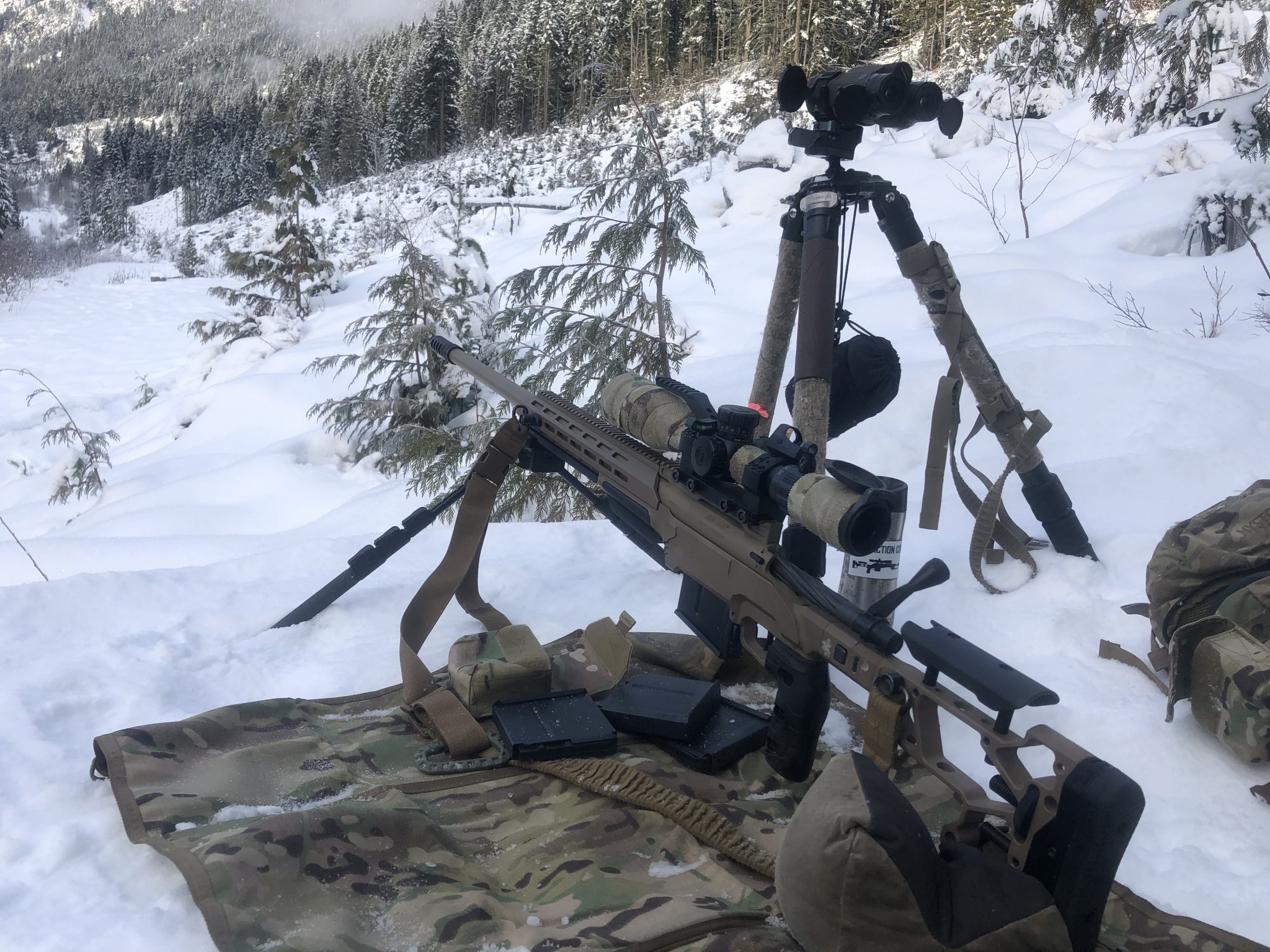

I have a 300NM built on a Stiller Tac 338 with a 29.5" Krieger MTU/Heavy Varmint barrel spun up by Insite Arms. It's in an MDT ESS with the full railed forend and the specific "high" scope base that MDT make for the Tac 338 (so the whole rail lines up). Absolutely love the rifle, possibly my favourite rifle. I don't know if MDT still offer the ESS for the Tac 338 but I believe if you were to ask them, they still have a few ;)

I think you would be right at 3k for a complete barreled action using the parts I did.

Thanks! I really enjoy shooting it, haven't toally stretched it's legs yet but have shot it to 1840ish and routinely shoot to 1600. It's a consistent sub 1/2moa gun, really just a pleasure to shoot and quite soft shooting being 20ish lbs and with the 5-port Heathen brake.
There were a few particular design considerations when I set it up. I wanted to easily be able to run a clip-on so having a full length top pic rail was on the list. With most of MDT's chassis, that means using their proprietary "high" scope base to line up with the rail on the handguard (or NV bridge on an ACC) of the ESS. They just so happened to make that scope base for the Stiller Tac 338 and inlet ESS for it plus I could get the action from Stiller at industry pricing. Made the choice easy. If I didn't care about having a full length top pic rail, I most likely would've used an Impact, not that I've had any issues with my Stiller. Figured it might help if I shared my thought process from when I had that rifle built.

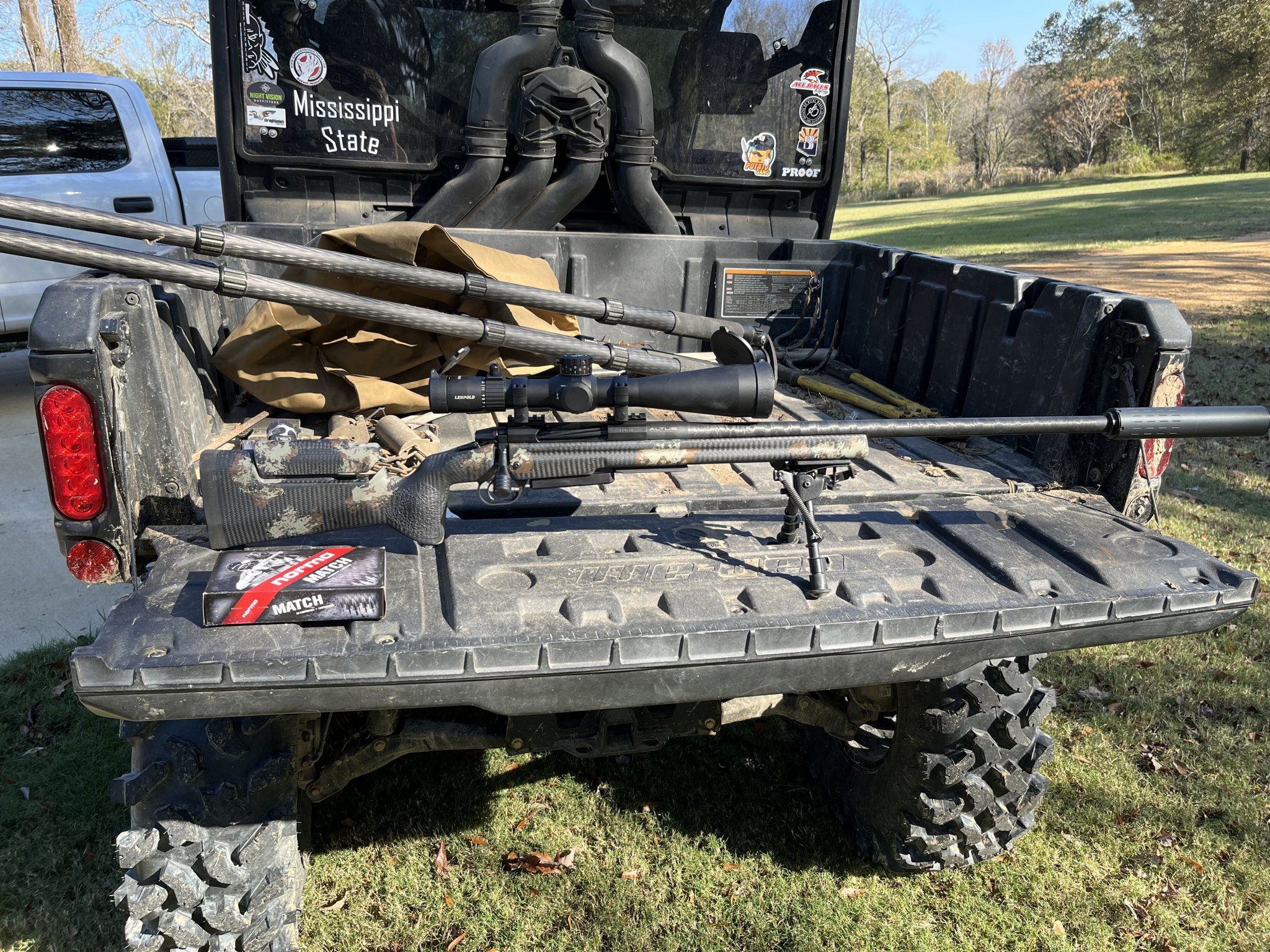

300 Norma on a SRS-A1 southpaw edition. 30" bartlein 1:8
Mag feeds 250 grain atips at the lans.
