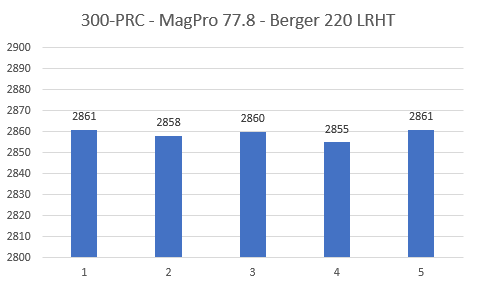

    Setup #1 ... Lapua 1x brass - Accurate MagPro 77.8gr - Berger 220 LRHT - Neck Mandrel .3055 - Seat Depth .80 (Mag-limited)
    Result: Avg 2859 ft/sec - SD 2.6 - ES 6 - Group .75 MOA
    YES ... a Standard Deviation of 2.6 ... I audibly gasped when I saw that on the LabRadar summary screen. It's the lowest I've ever seen ... by a bunch.

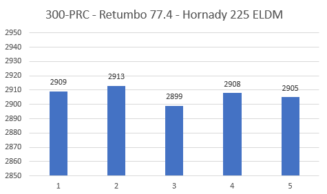

    Setup #2 ... Lapua 1x Brass - Hodgdon Retumbo 77.4gr - Hornady 225 ELDM - Neck Mandrel .3055 - Seat Depth .80 (Mag-limited)
    Result: Avg 2907 ft/sec - SD 5.3 - ES 14 - Group .60 MOA

    I've got a ton of Accurate MagPro and less Retumbo, so I'll start the competition season with that Setup #1 recipe, and see how I do.

    BTW ... I zero'd in on both these charge weights using flat spots in ladder tests ... I know many don't believe in that, but it worked for me, and was actually reproducible.
    I'm happy to answer any questions about how I got here, and the equipment I used along the way. I see a lot of 300-PRC load development questions, hence the share here hoping somebody can benefit from all the supplies I wasted to finally get a good result.
