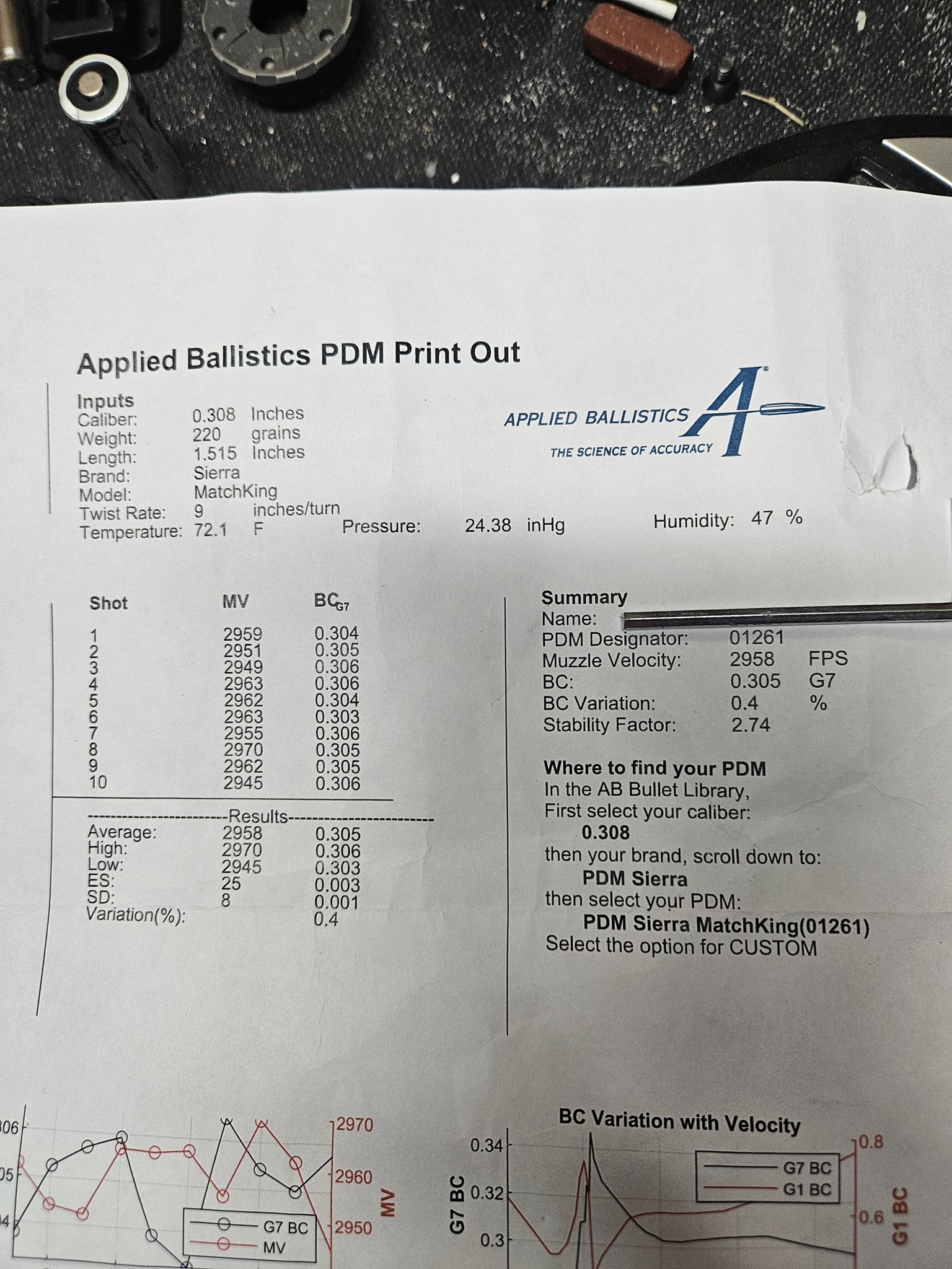

Ok looks like I was able to finalize my load today.
Load #1
220 LRHT
Cci 250
77.4gr Retumbo @ 2856fps
SD: 2.4, ES:4
Load #2
220 LRHT
Cci 250
78.6 gr Retumbo @ 2907fps
SD: 9.1, ES:18
Both are making 0.28 MOA 3 shot group at 100 yards.
