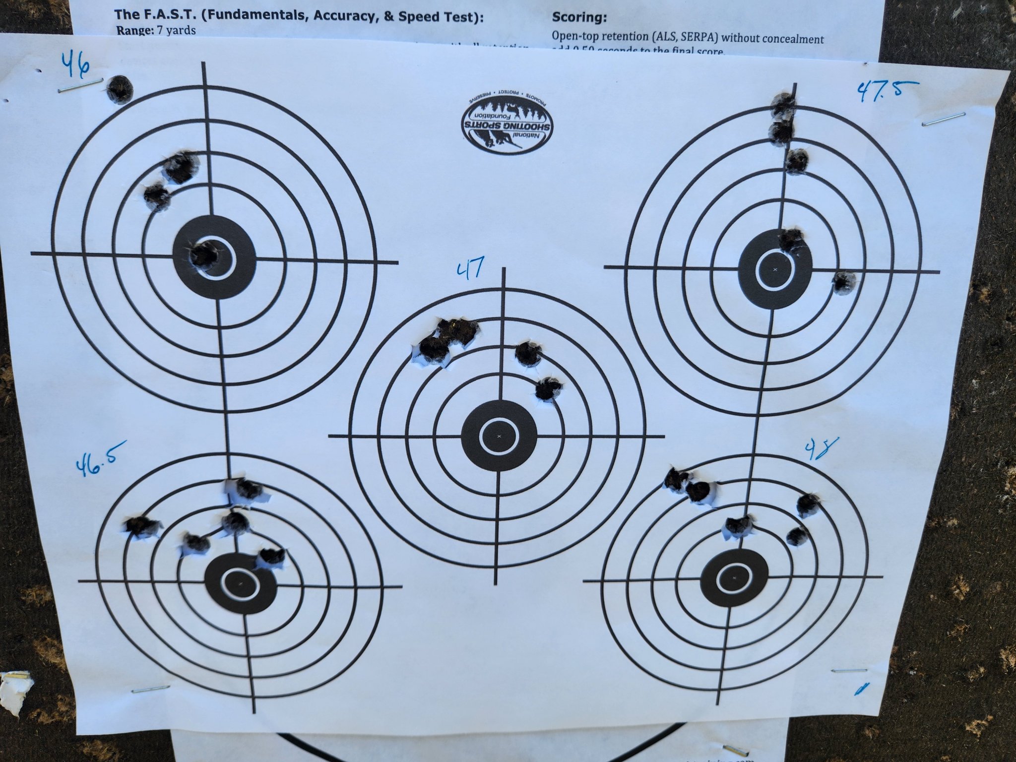

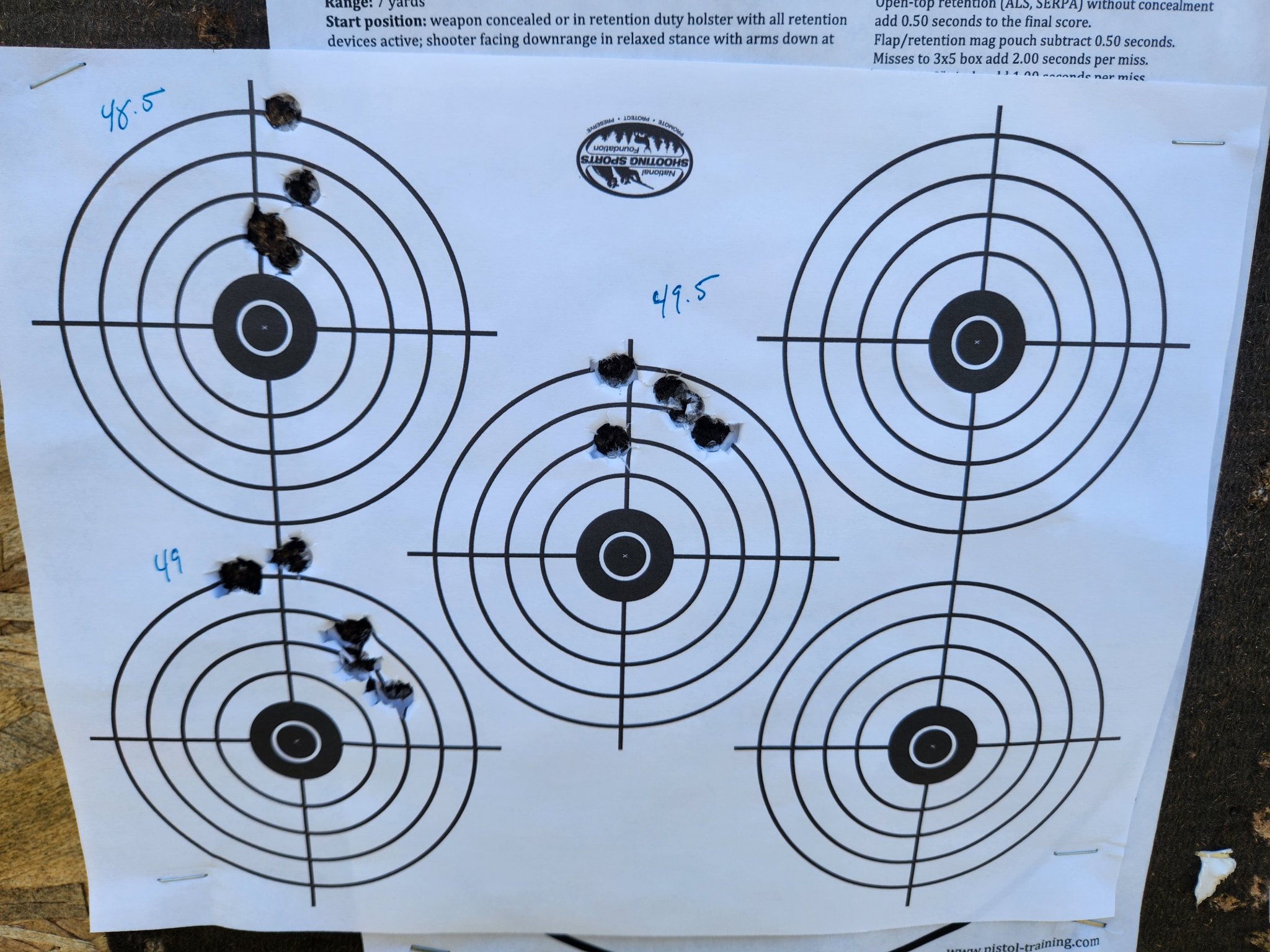

So did a new load with for my 3006. I previously used HXP brass, with H4895 and a pulled 147 gr that I loaded up as cannon fodder for my garand. Grouped well at 100, crap past that.
did the normal brass prep, made sure they were all same head stamp and date, then used my powder dropper for precise power charge. Started at 46gr and up to 49.5 in half gr increments. These were all loaded with hornady 155gr ELD match. All loaded to book OAL specs
I can't say I'm impressed. Each was a 5 shot group and it seemed like I'd have 3 good ones, then a few flyers. Other than 1 shot that I knew I threw. At this point I'm thinking it's just inconsistency with the brass because the groups were consistent with the flyers.
Any insight here? The 48.5 and 49.5 look promising, but I started having a sticky bolt at 49 and up but the primers still looked good and round.

Very small sample to judge anything .
Try different seating depths, try different bullets, try different powders.
Developing a load isnt a one stop ride, its a series of experiments to see what works best.

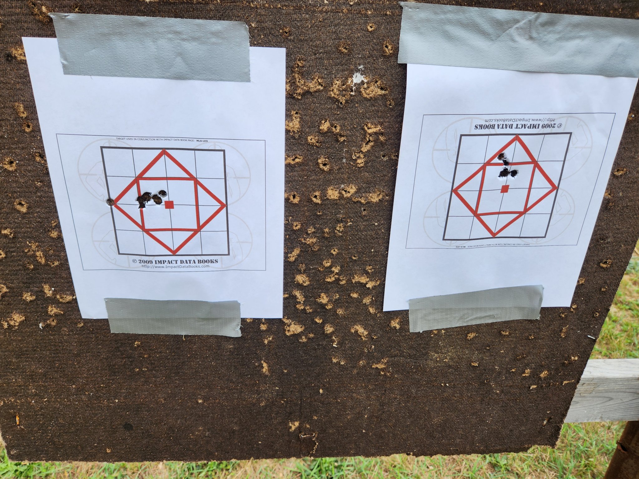

I've never shot purchased ammo through this rifle. I previously posted about my 147gr bulk ammo loaded with h4895 for the garand under the hornady service rifle; results which were good at 100 yards, but those were cheap rounds made for my garand. The target on the left was that ammo.

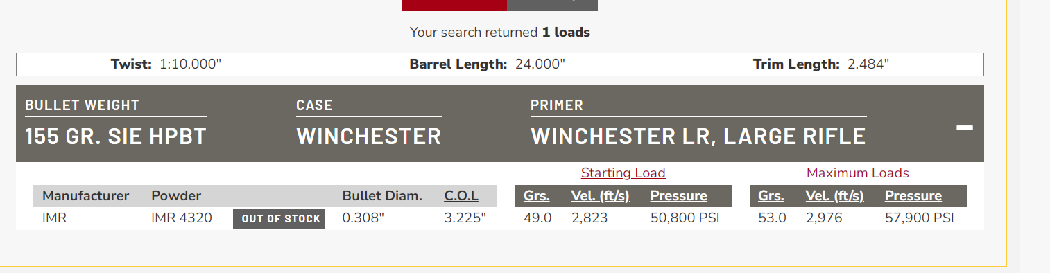

I'm trying to stick with what I have right now. I have a bunch of 4895, IMR4320, and A4350 that I may try next.
Hodgdon does not list you bullet, but this is for a 155 . Maybe good ole 4320 will shine ?

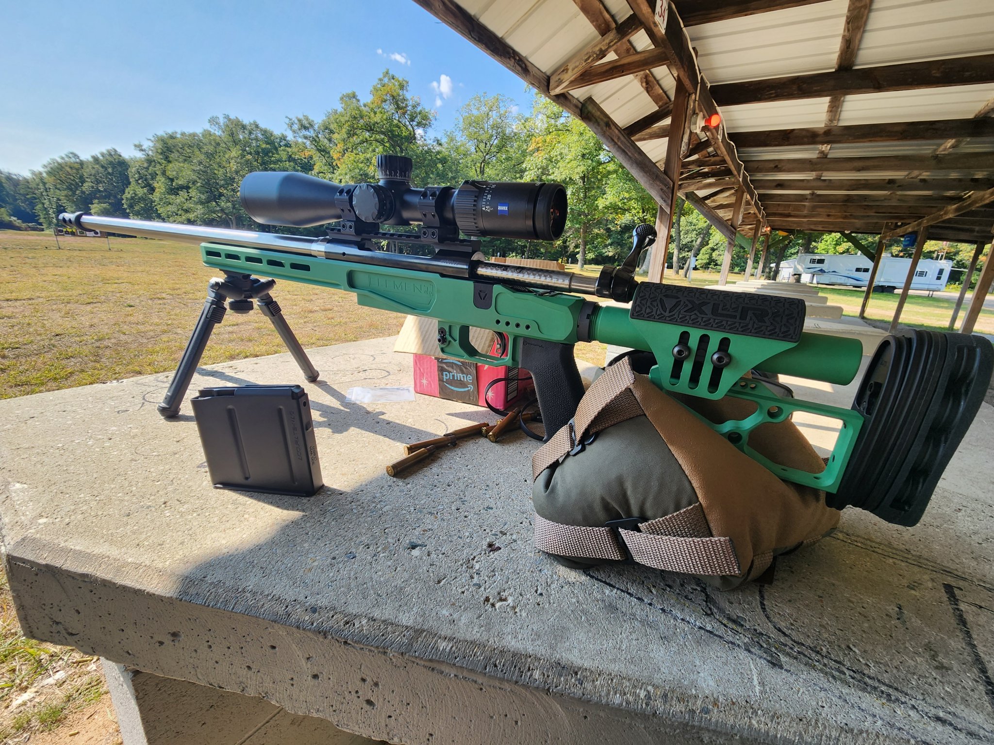

Nice rifle! Looking at the targets you have posted I'm going to comment on what I see as possible issues. I don't know your background and haven't seen you shoot. You may not have any of these but just in case I'm putting them out here for consideration. I'm also assuming you have eliminated any scope /mount issues.
In the first set, I'm going to assume you are shooting round robin (1 shot at a load then next shot at a different load). What I suspect in this case is the shooter is not getting set up consistently on the rifle. It may be rear bag placement, shoulder pocket issue, slapping the trigger, or cheek weld. I also see you are on a concrete bench so bipod bounce could be an issue. I always have a piece of carpet under mine. If these are not shot round robin, then the issues may still be a problem depending on your system.
In the second set the Garand rounds appear to be walking horizontally which might be setup. The other target looks like two groups. Slightly different setup?
When I hit a wall with getting consistency I usually ask some I know is a capable shooter to shoot my rifle. It does two things, shows me whether the issue is load or shooter, and it allows me to watch the rifle and see what it is doing.

So your assumption on the setup may be correct as I've only shot with this rifle twice now. I know the scope is solid but maybe the chassis screws came a little loose. The target picture with the two targets is not from the same rifle. The left target is the 3006 and the right is my 6.5cm.
I shot this test group with all 5 of the loads in one setting. Shot my other rifles to let this one cool, then went to the next group. Continued that through all the groups.
When I get back I'll check the screws.

Brings up a question, do any of the other rifle have the AR style pistol grip? I ask because I had issues with my M4 until I had someone else shoot it and recognized the grip is swept back more than my bolt gun stock grips. Change to a K2+ and groups improved, quite a bit.
Good point, no they don't. This is my first one with a grip.
