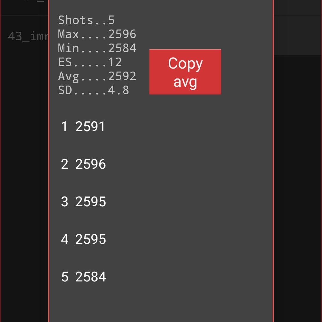

150 grain fmjbt I chrono em at 2595. 41 grains imr8028xbr.

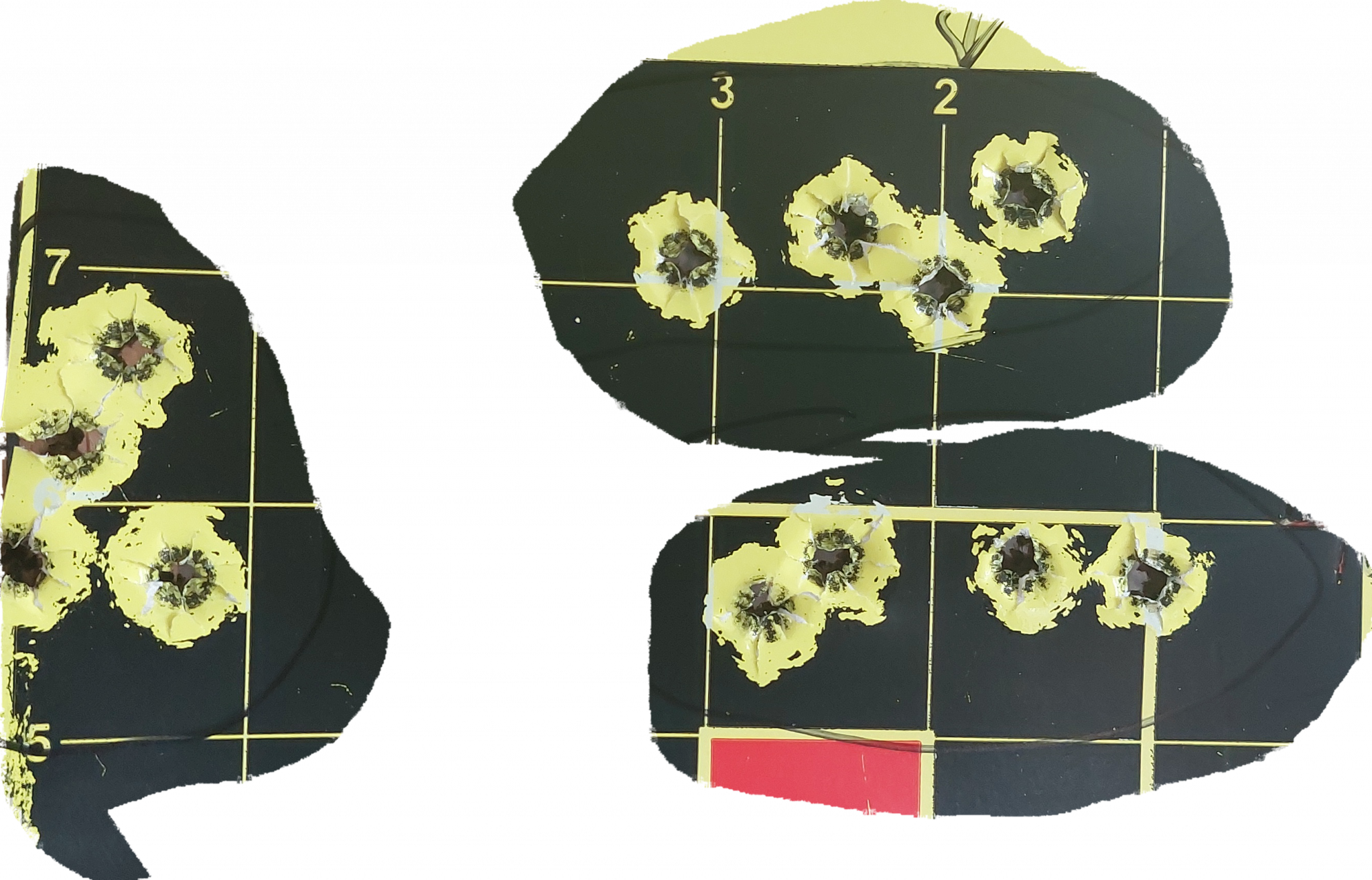

Group on the left is 41. Top is 41.5 bottom is 42. These were 4 shot groups I did then went back and confirmed over chrono with 5 shots. The numbers I posted earlier were for the group on the left.

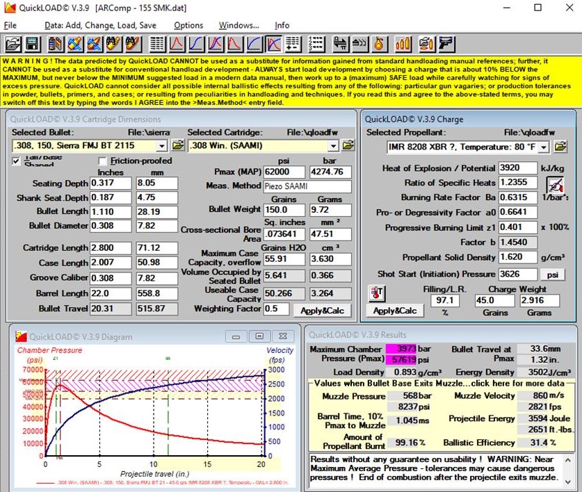

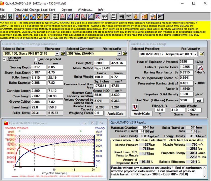

Here, you might take a look at the picks below and find the numbers of interest to give you some ideas about your load:
Example of what I'd call a moderate load with 45grs of this powder:
Reactions: Hayn Lo
You've got some tight vertical, and the horizontal looks more like you're pulling (or pushing) more than the wind is causing it - surely a combination of the two. It would take some decent gusts to move it that much at 100 yards.
Other notes:
- I don't like shooting at Shoot'n See type targets when doing load dev. Your eye tends to move toward previous shots, and so does your aim - put up 1" orange dots on white paper instead.
- Zoom out as far as you can where you can still consistently line up on the dot. You don't want to see/chase the wobble, and ideally don't want to see the impacts until you go up and check.
Reactions: Hayn Lo

Pretty sure it's me. I'm just looking g for something else to blame haha

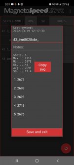

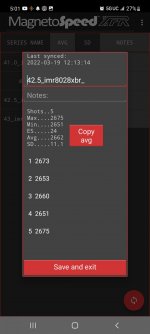

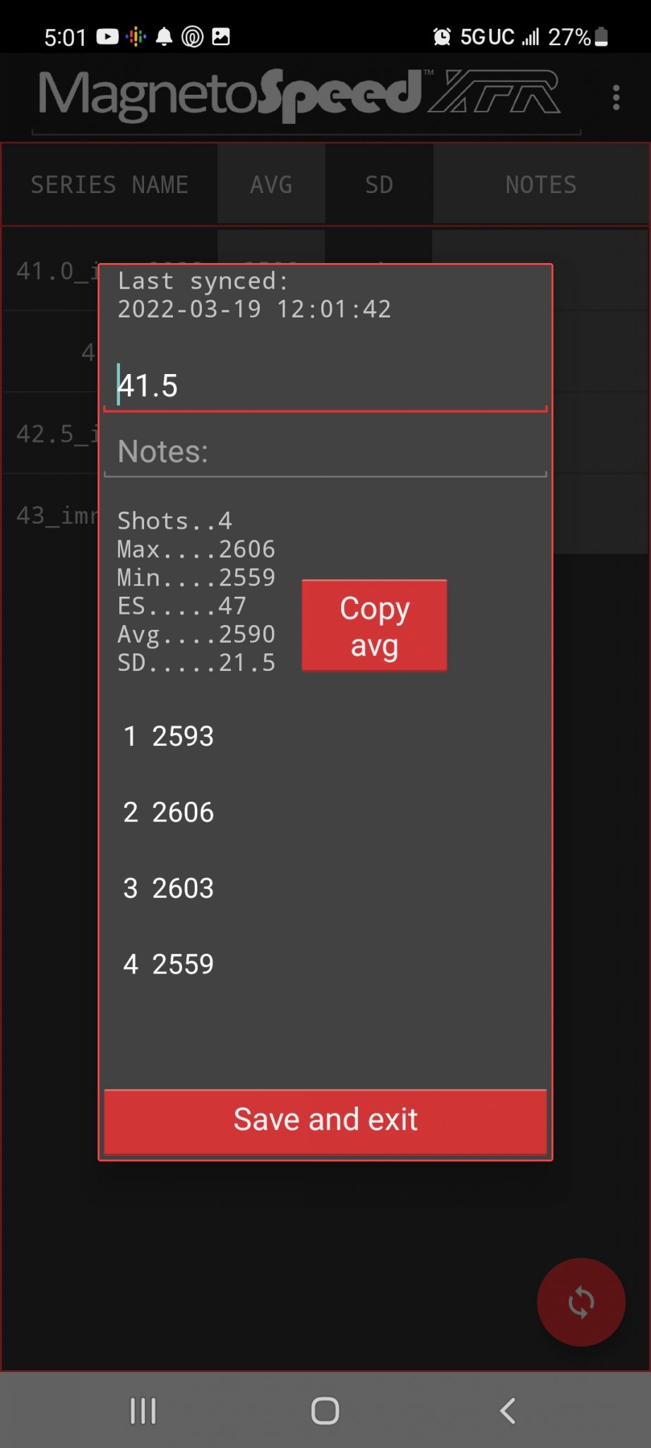

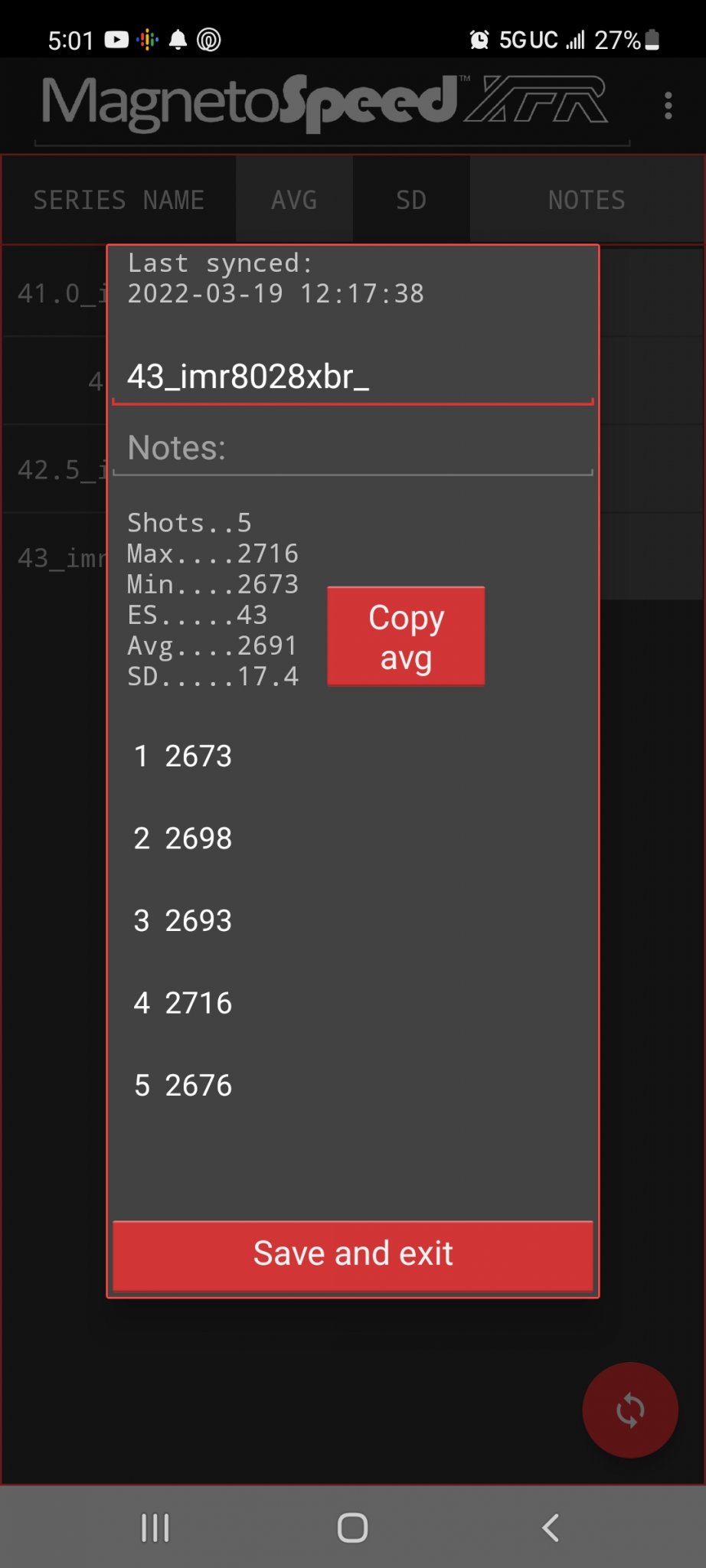

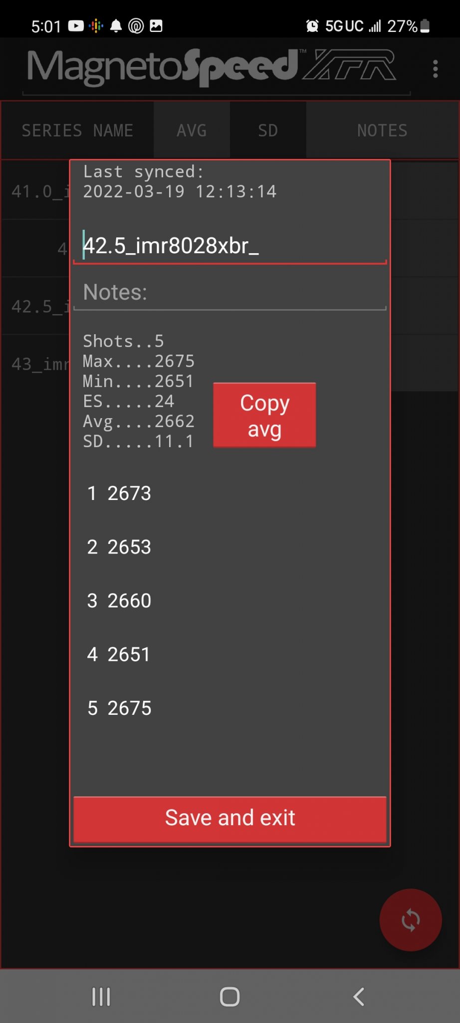

My numbers for the other 2 groups. The final lic of numbers is where it started to open up. No pic of that group the target blew out on the freeway on the way home
