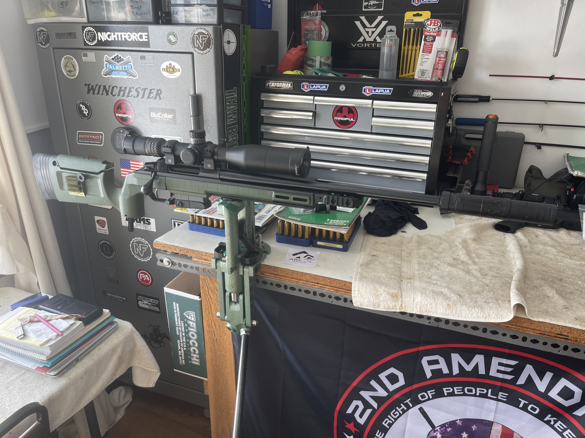

This is what a CTR 20” 308 in krg bravo would look like. Just a factory ctr pulled from stock and dropped in a bravo. No other modifications other than a few krg add ons to the bravo

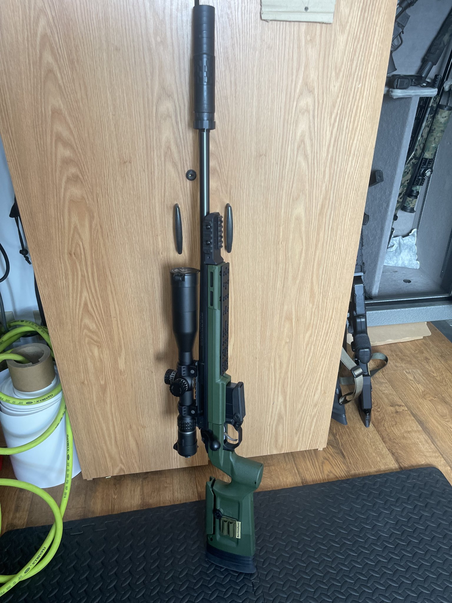

This is my November deer slayer in Michigan and backup to my primary crop damage rifle for deer during summer. Shots 100-500 yds typically

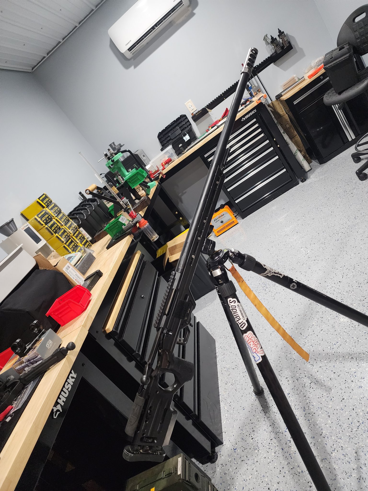

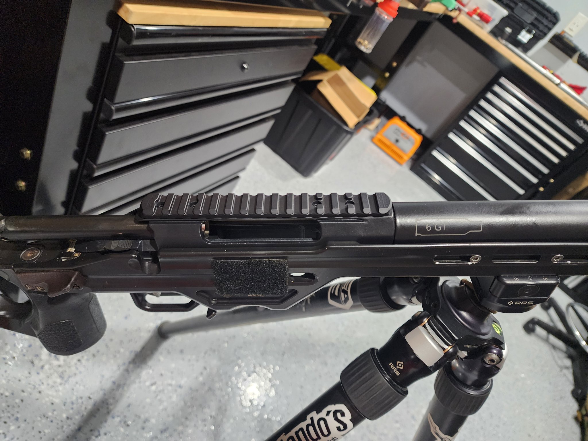

Here is one in a mpa matrix with a 6gt bartlien and a strek bolt.
