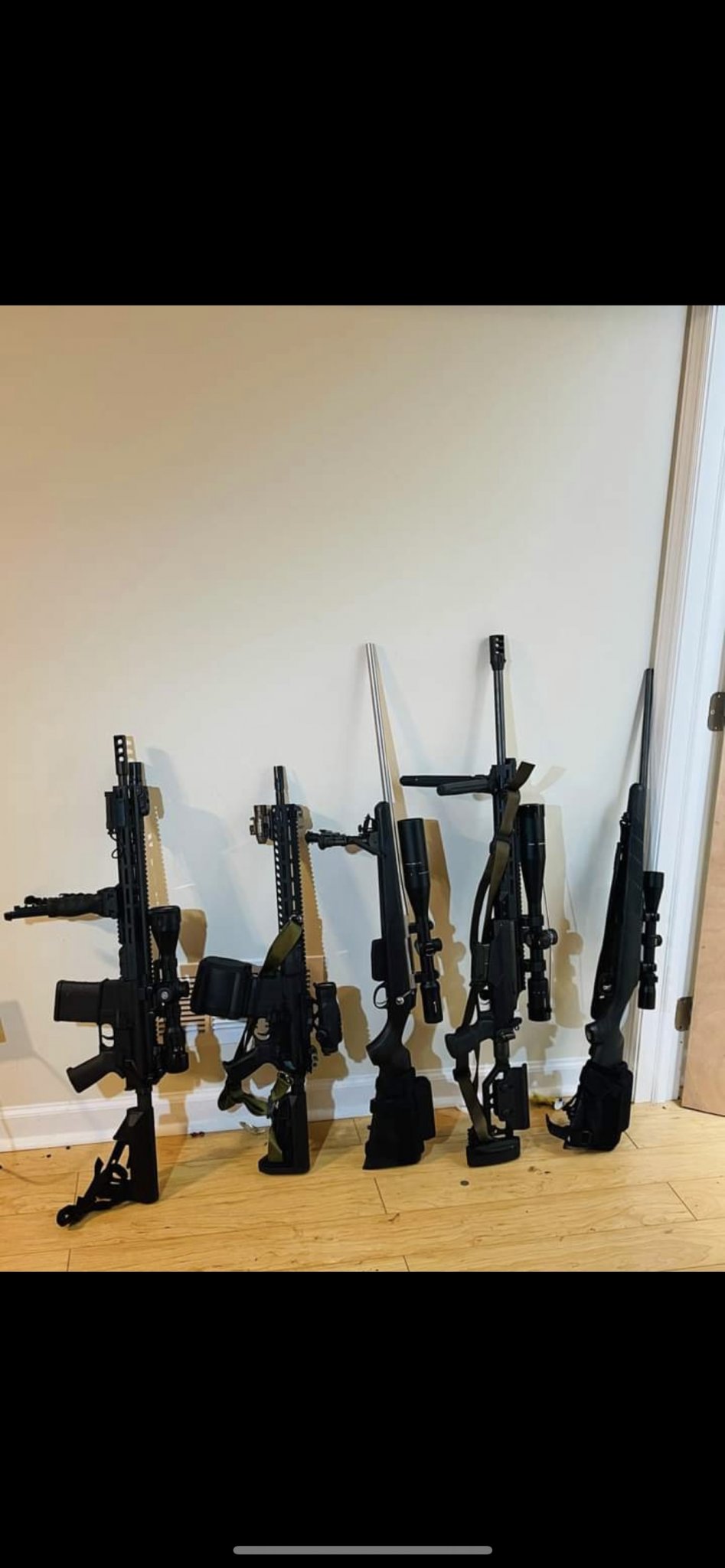

Including a picture of my long guns…

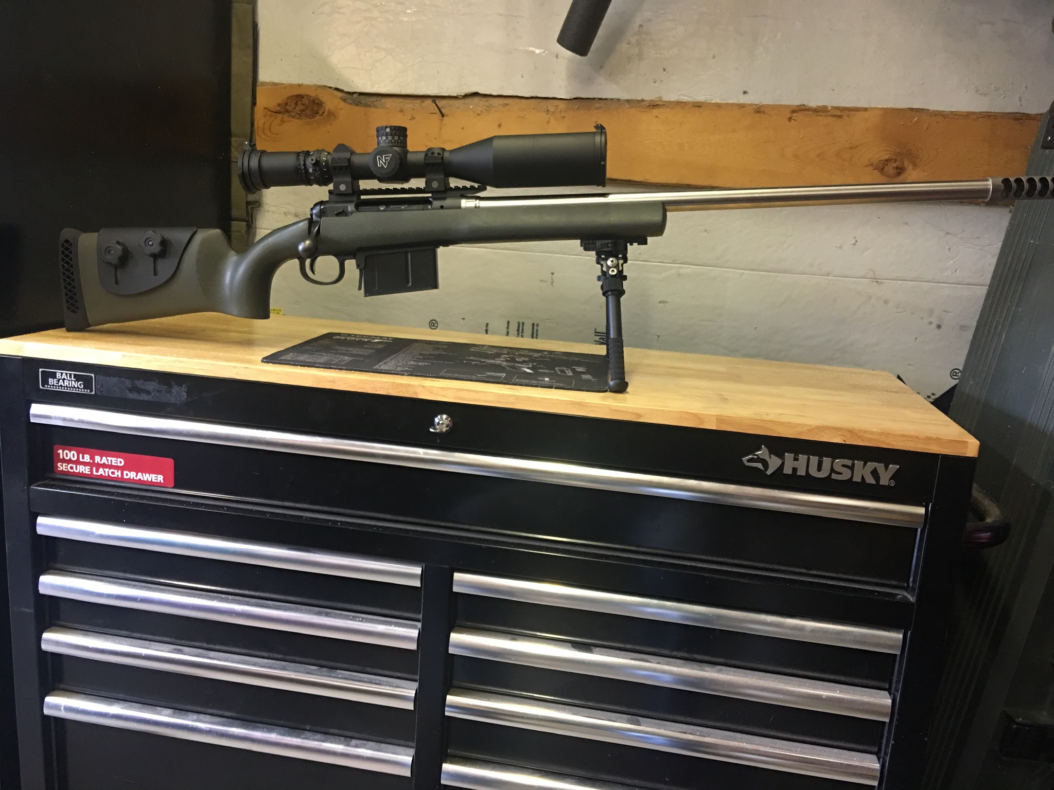

The rifle pictured looks 10 poundish, to take on a hunt thats probably a good weight, but if your use does not involve hours of carry for each shot then some more weight can help tame the mag recoil. Here when the question is this or that the answer is both.
