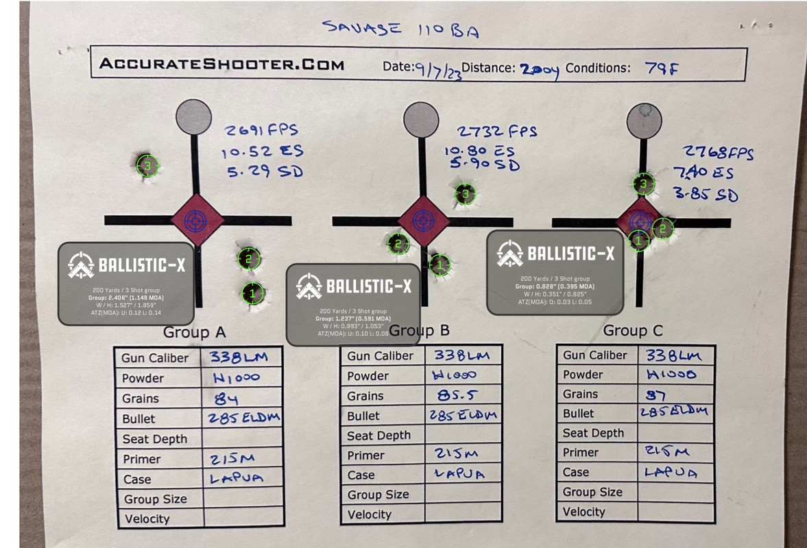

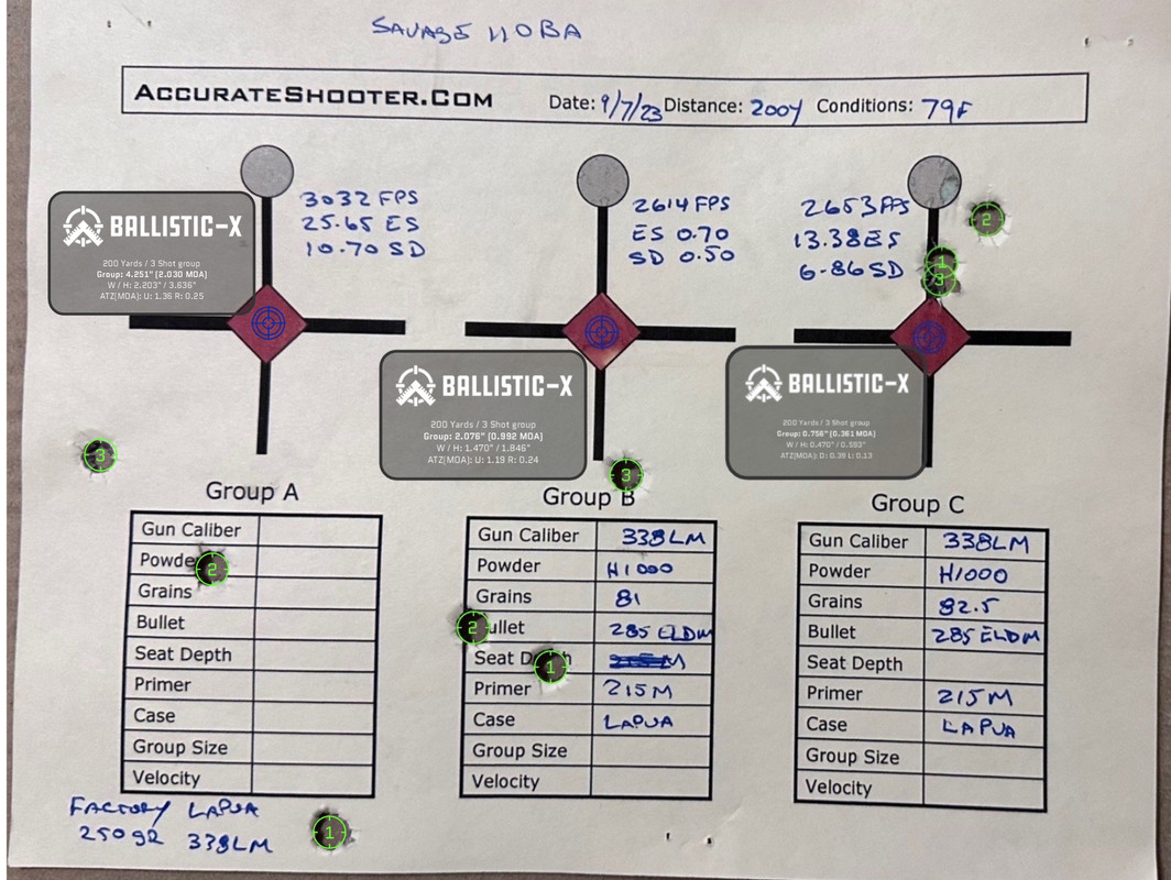

I shoot 285 ELD-M’s in mine and I use 1.5gr increments.

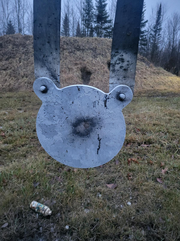

The gong on the bottom was shot using 92.3gr of H-1000. That’s 3 rounds at 425y.

5 m/s is 16.4 fps. My spread is below that also.
If you notice the 87gr, 88.5gr, and 90gr groups have very little POI shift.
