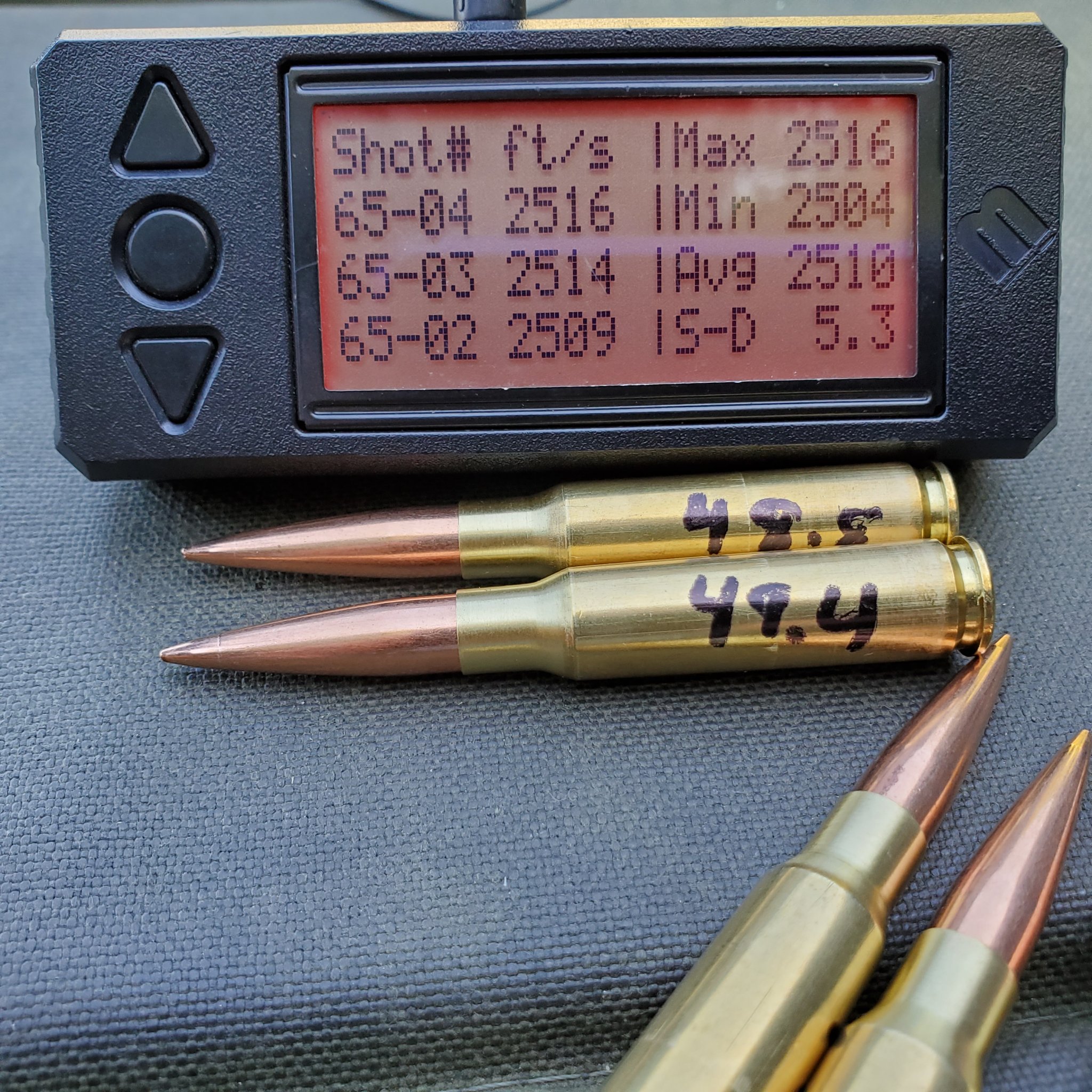

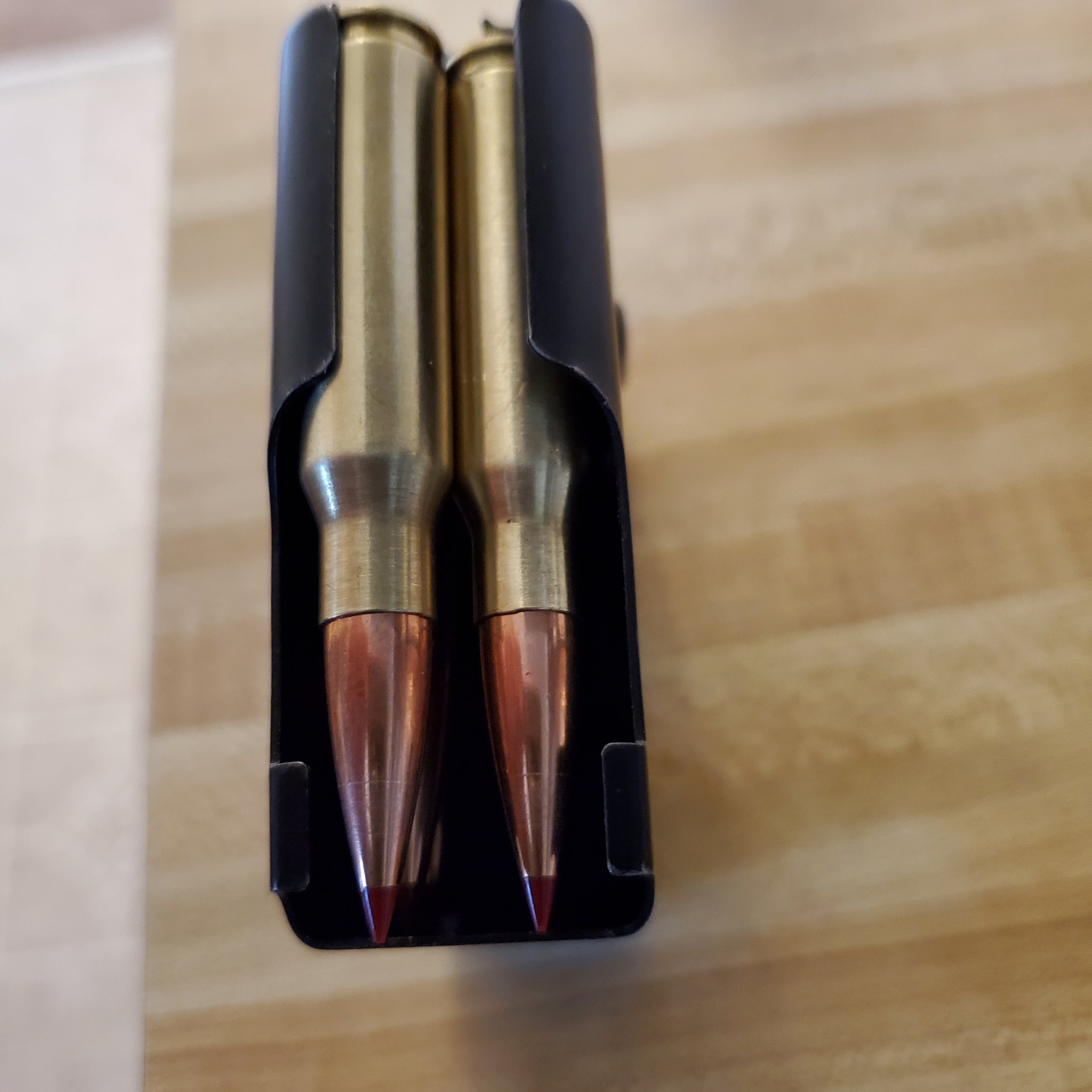

Nope, not really, pictured here is the 22" 9 twist 308 working up loads with modern powders to those max loads, with 230 gr SMK .8 G1 BC, much better than the .467 ...and this is Lapua LR brass, not the 80,000 psi hybrid brass... that I can also use, for even more high performance.
It's Always comical, how everyone compares the 70 yr plus yr old 308 with 168 gr to everything out there as to inflate the value of their cartridge...many with the newest components and developments.
There have been alot of advances and developments during that time ...and they apply to the 308 Win as well as any other cartridge. .. most all my new 308s have 8 and 9 twists. For 200 to 250 gr bullets.
And...my light weight 6 lb 3 oz 308 16" AR 10 runs 168 ELDM at 2757 Ave fps with excellent accuracy ...not the 2400 stated for comparison to the 375 Raptor.
And 225 gr ELDM single feed to 2440 fps in the 6 lb 308 16" AR 10, for a heavy bullet .777 BC...for comparison. Or 208 ELDM at 2442 fps out of the mag of a 16" AR 10, & .690 BC. Modern loading of the 308 Win brings a lot more to the table.
Then there is the 30" heavy palma 8 twist and hybrid 80,000 psi cases to employ, for even much higher velocities, like 168 gr 3255 fps...but that is specialized...still the others are readily available to anyone, who reloads.

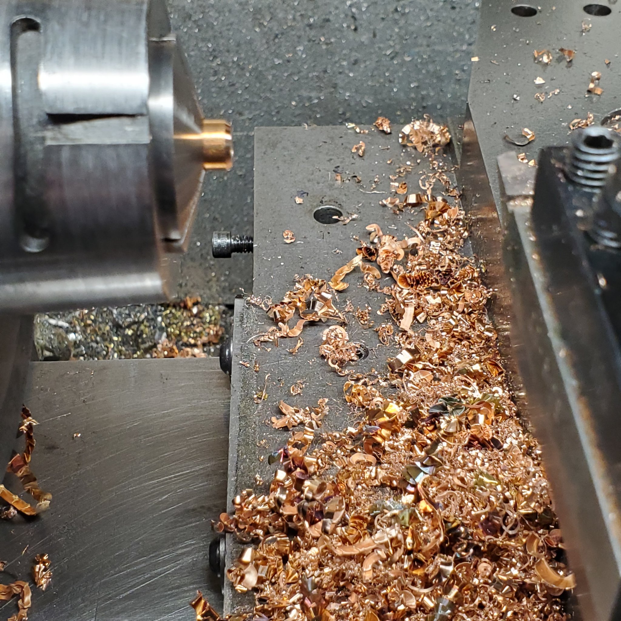

I have 2 lathes and a Bridgeport mill fully tooled, and 35 yrs as a machinist.
Even making my own copper bullets, yesterday, for a specific cartridge.

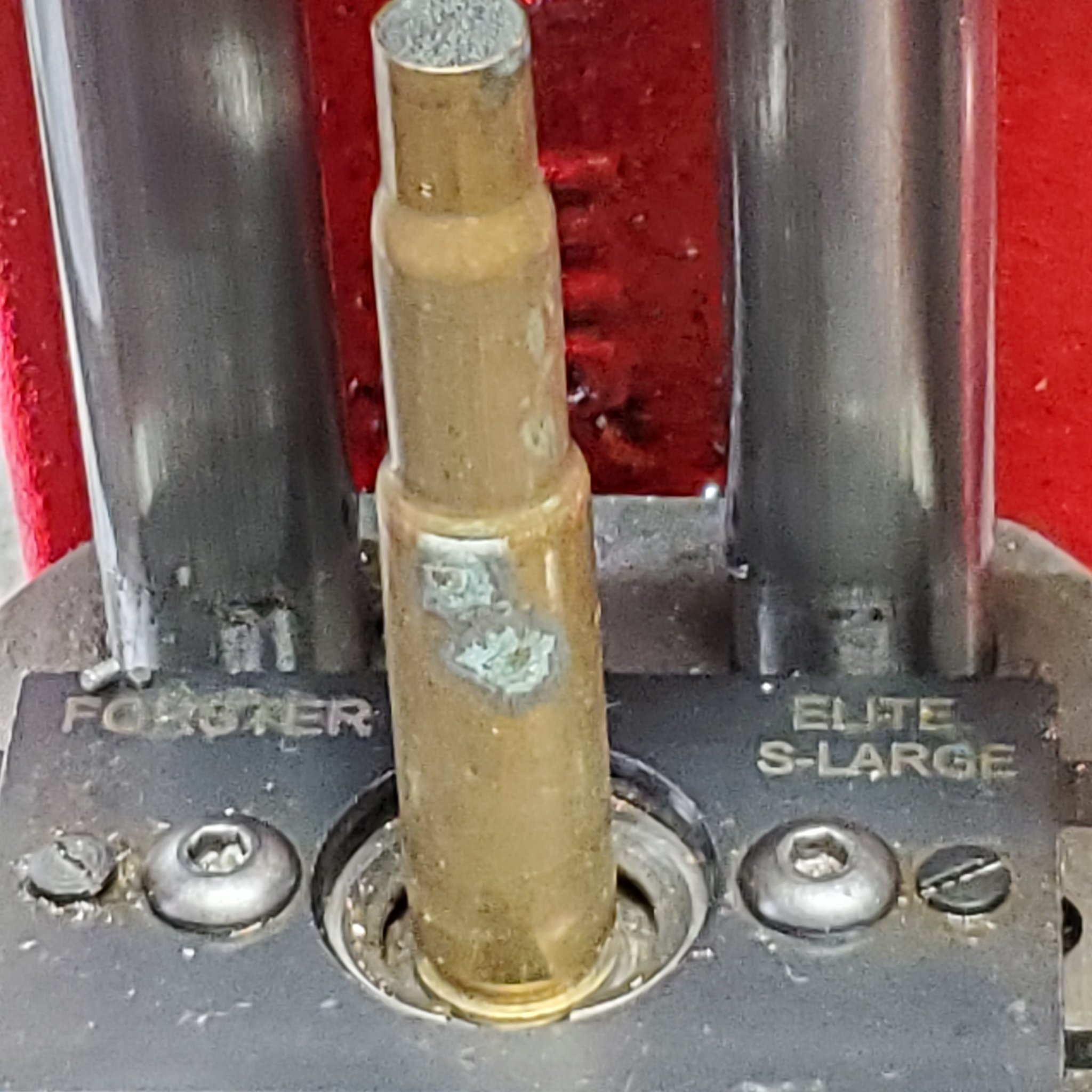

While I build no lube forming dies to take 30-06 to 8.6 Blk. Or run 155s to 2900 fps in a 16" AR 10, 2870 fps good for 155 Palma.
Or 2674 fps for 200 SMK in 18" AR 10. I built 8 308s from 16" to 30" in various twists, even built a 30 RAR in AR 15 from a used blank, profile, chamber, install barrel extension, determine type and drill gas port.

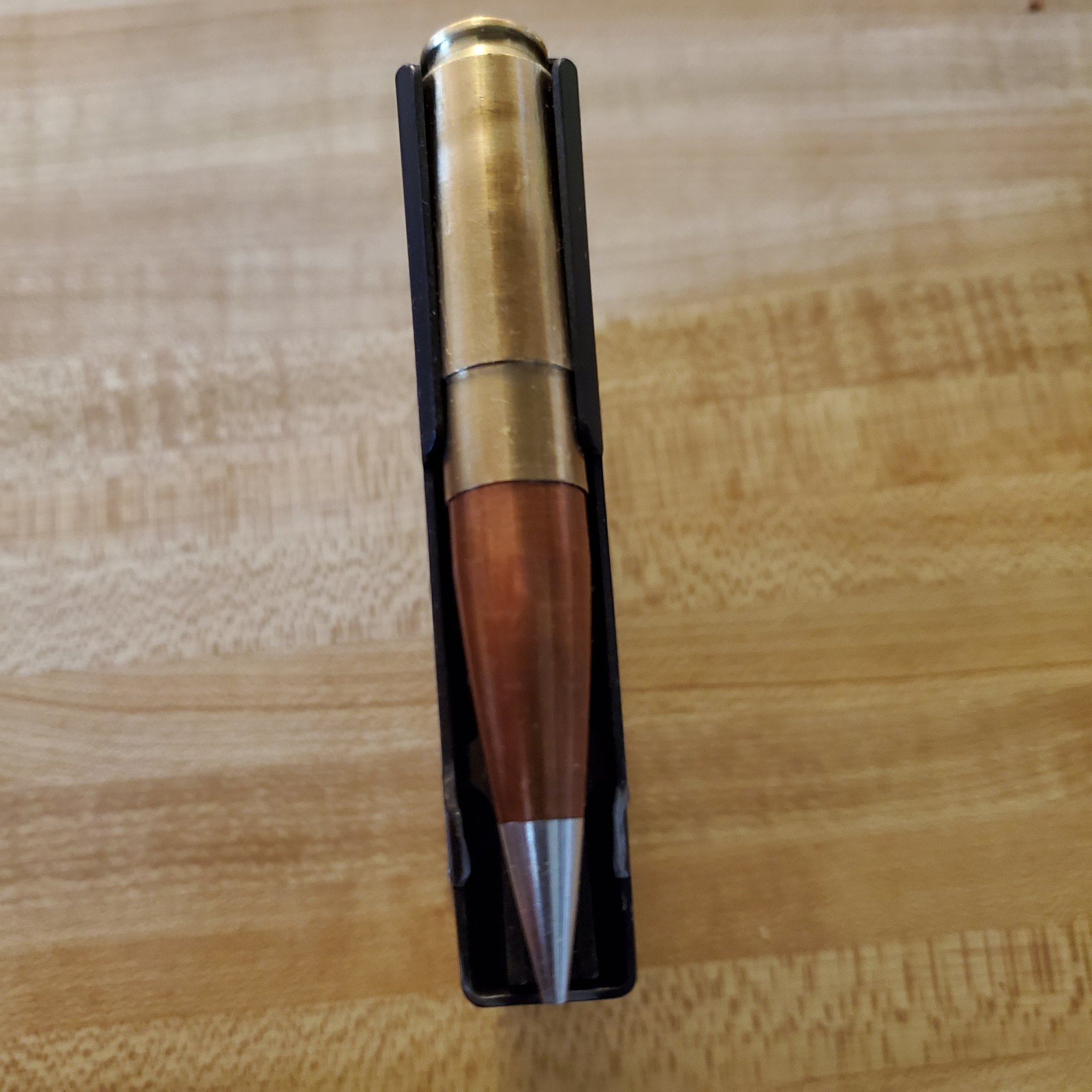

Bullets up to 1002 grs or down to very light 300 gr. bullets. Plus military APITs if one cares to.
Reactions: wvfarrier
You don't seem to get that when you make a claim in a public forum you should expect to be questioned. The onus of proof is on you, and I wasn't being disrespectful until you earned it. And even so, I wasn't even being an ass about it. Your skills and abilities aside, if you can't handle being questioned on your claims you come off as a fraud.
It seems like it would be a fun "all around" round to toy with. Those are some massive subsonics! I used to run 600 grain sabots in the 50 beowulf I had. They were a hoot.

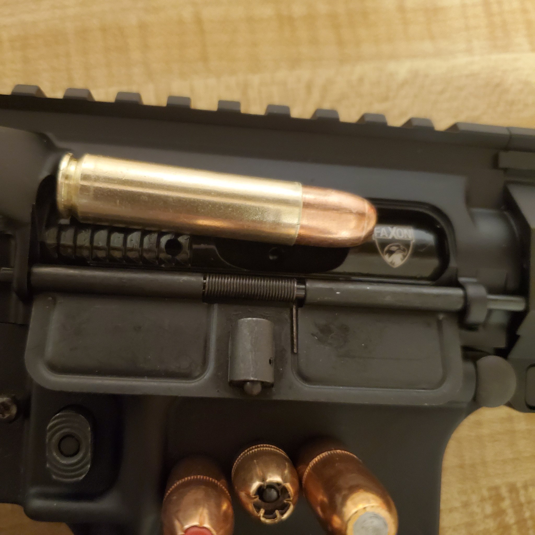

I shoot cast 502 gr and 500 gr resized jacketed 458 mag in the fast twist 450 Bushmaster, they are fun, also added a recoil pad.
600 gr and 50 cal would be more fun...all from a light AR 15 platform.

I don't owe you anything. Showed the chronograph proof. Didn't believe that.
Proof would never enough, with you clowns. And you never researched anything,... not much effort in that.
Played hell on deer. Looked about like a 12g slug. Never had to chase any I shot with it 🤣
