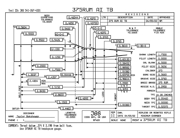

I got the idea from 375 ultra mag thread.
I decided to do a 375 Rum with a 40* shoulder, moved ahead .053" and taper reduced to .006"
A guy over on that forum had done a similar cartridge several years ago and called it the 375 Box Monkey Express.
Initially I tried to seat the bullet hard into the lands to jam the case head against the bolt face but that wasn't working. I believe the firing pin strike was pushing the case onto the bullet causing excessive head space and I was almost getting case head separations. I ended up having to neck them up to .416 and then size back down to .375 and make a false shoulder (wish I'd have taken pictures of those cases). I ended up with some fairly crooked necks so I had to trim off a bit more than I would have liked.
I have the intention to run this rifle at Ko2M Canada which has a 10k Joules limit, I was hoping to get the 390gr A-tips to 2900 fps. which I can get it there but the node seems to be around 2870 unless the barrel speeds up which I'm not expecting now. I have about 140 rounds through it (including 100 FF)

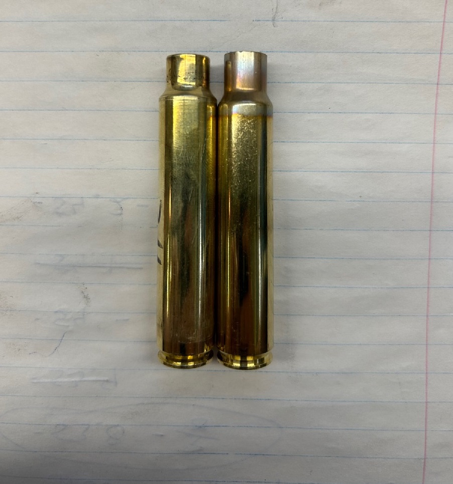

-Formed case on the left, Factory brass right.

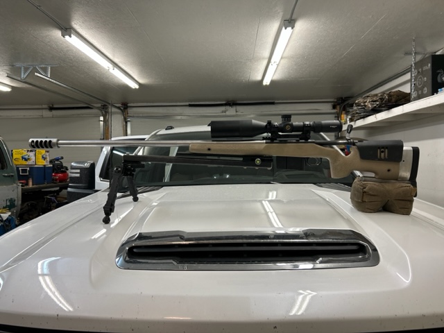

I also need to add some weight to the rig. It weighs about 20lbs. I have a steel arca rail coming that is about 3lbs and then I will likely add a bipod extension and a belly weight and see where it ends up.

" I ended up with some fairly crooked necks so I had to trim off a bit more than I would have liked."
Did you use nk sizing mandrels to neck up ,or just a .375 sizing button .
Years ago i did a 338-375 lapua and a 408-510 wildcat,necked up the cases using mandrels in different increments without any problems of nk and shoulder distortion.
Reactions: Earnhardt
I used a mandrel. I started with 375 RUM brass from ADG, the only reason I had to go up ( .416) was to create a false shoulder. I'm not sure why they were so wonky, they sized fairly easily. My second 50 turned out much better, instead of trimming them down to be flat off the bat I fire formed them first and that seemed to straighten them out, I didn't have to take as much off those ones but only problem now is I essentially have 2 different sets of 50 brass, I can always shorten the second batch so they are all the same.
It was just the neck that was weird it like had a wave in it, should have taken pictures of that also.

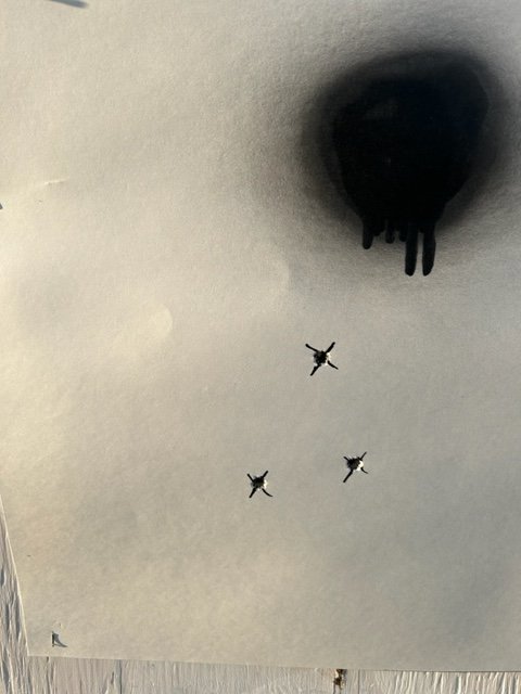

Well I can’t get it to stop spraying A-Tips. I’ve tried seating depths from touch all the way to .120 off. And I tried backing charge weight all the way down to 104gr. I always end up with 2 touching and one about 1” away. It was shooting SMK’s well during FF.
I also put some 375 CEB MTH in it just to try with a random powder charge and 5 went into 1/2” group.
Im gonna try some N565
Any other suggestions I really wanted to shoot the A-Tips.
Here’s a pic of my last target. These were all the same charge with seating depth test but my charge weight test looked nearly identical

The problems I've had with low case body taper are in the sizing die and in chambering. Too much lubrication is removed during the early part of sizing and the lube needs to be reapplied to the top of the case once or twice to avoid sticking cases. The chambering issues might be the product of my process on a manual lathe. I prebore the chamber at the case taper with a boring bar to give the reamer a concentric start. I set it up to give about an inch of reamer travel. At 0.012"/" of taper, the reamer cleans the chamber out and leaves a great finish. At 0.009"/" I need to be very careful with the sizing and finish the boring leaves. If your guy just shoves the reamer in, find another guy. Looking at your brass, I think your guy is doing something similar to what I am.

Tracking is your friend. If you can add stand offs to get the bag rider parallel to the bore and the bipod mount square to it, the gun will recoil closer to straight down the bore. Moving the top of the recoil pad to just over the top of the bolt will align the support with the recoil impulse.
Adding weight around the bore is the best for tracking. Heavier barrel contours are a cheap way to do that. The courses I shoot have enough change in elevation between the targets that I prefer to keep the bipod controls within reach. Adding weight to the back of the gun has an effect similar to extending the bipod forward but doesn't require compromising your position on the gun. It's a personal preference and I recognize I'm swimming against the current. I use buffer tubes and bag riders made from steel round stock to add weight in back. If it's not a chassis gun that uses an AR style buffer tube, I'll make a recoil pad spacer from 1-1.5" thick rectangular steel bar.

The wavey neck for those wondering is at the case mouth not the rest of the neck and using imperial sizing die wax on your entire case while fire forming will help.

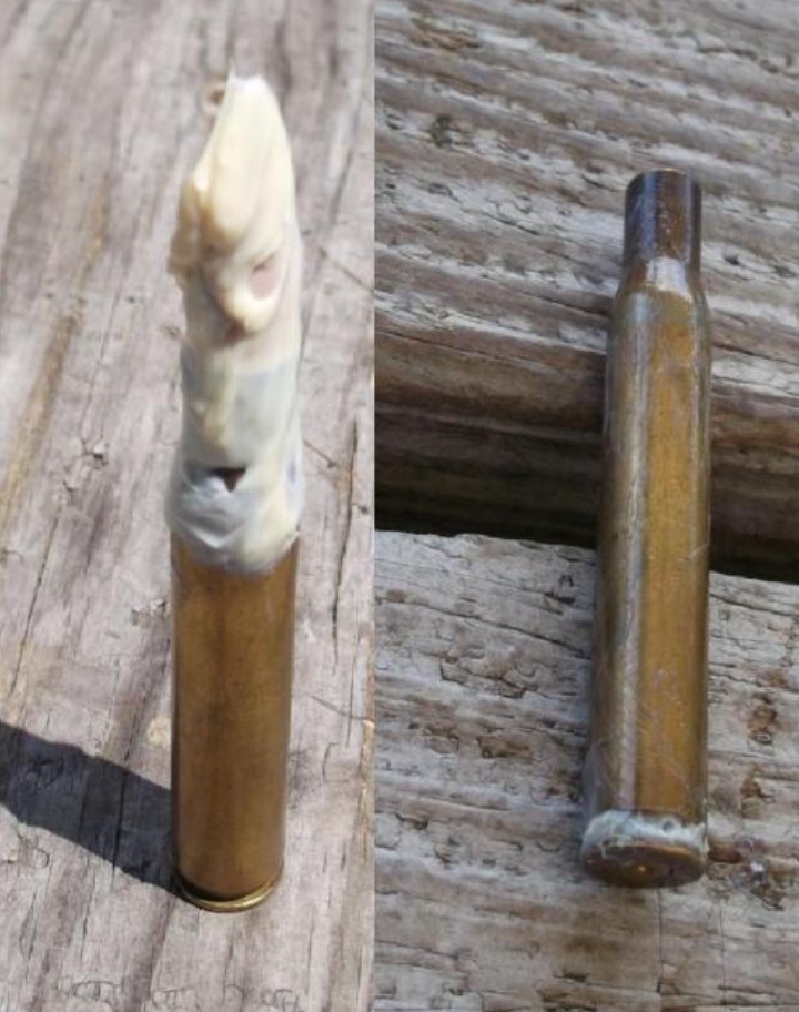

Edit to show how the US military used to grease there ammo for 03 competitions.
I’m sure the lubed cases would work. But not sure I’m down with that. I was blaming the wavy mouth on the brass not being perfectly centred on the mandrel. I think next go around I’ll get an expander die blank and have my smith ream it with my chamber reamer and then open the neck up so the case goes in straighter see if that helps.
The wavy mouth issue has 2 sources.
One is the brass thickness isn't uniform.
The other is how the brass clings to the neck of the chamber.

@cameljockey230 my wavy necks came when making the false shoulder not while fire forming. Fire forming actually helped to straighten them out. I could see lubing the case and firing with COW would help even farther
Since all you did to create the false shoulder was run a mandrel into the neck then size most of the neck back down the brass itself was most likely the culprit.
Which is why the benchrest crowd turns necks to get a uniform release on the bullet.
Out of curiosity how is extraction with 0.006 taper per inch if you don't mind me asking?
could be. The extraction is flawless. The bigger concern I have is it extracts so well pressure is very hard to detect. I got into decent pressure testing some N565 but my chrono died and I have no idea what the velocity was on that round.
I am very impressed with how the bipod extension helps recoil management.
Here is a group from the A-tips at 1260 Yards. My arca rail fell off and I never got to shoot the MTH bullets for group at distance, I'll have to upsize the screws to keep them from breaking off. I tried shooting them using my range bag as a front rest but that didn't seem like a fair comparison. I wasn't super disappointed about the off target splash from the solids but when they hit they barely take any paint off

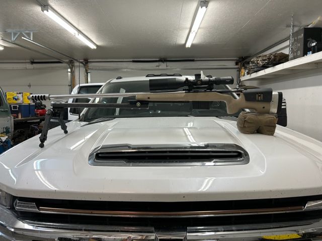

Accutac sells an extension for the locking lever. Might be worth considering. That and different feet. The stock ones have a habit of grabbing and bouncing. Fine on little guns but anything we shoot is going to move and it is better to let it move smoothly rather than try and restrain it.
I have the ski feet. I tried them for a bit but couldn’t get used to them so I figured go back to the normal feet for the match and I’ll give them a better chance next year. I’ll look into that lever extension tho, thanks.
What is your load combo with the groups at 1260 yards?
I actually ended back at 108gr N570 with about .005” into the lands. 2860 fps.
