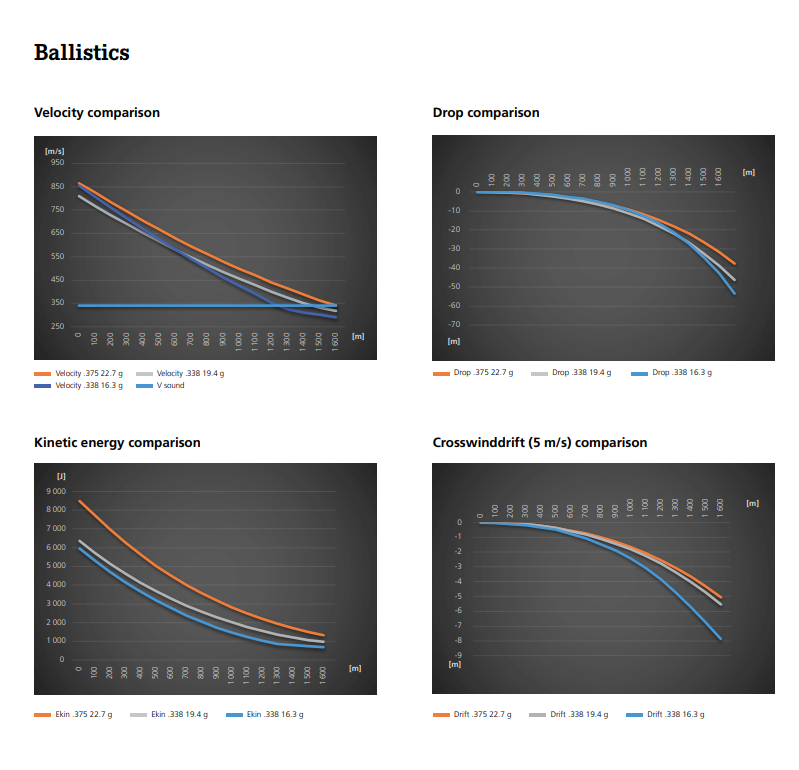

    Ruag is touting this design as some new BC gain in bullet design over a traditional hollow tip!? Looks like a traditional FMJ and ball used to stop the lead plug from filling the tip.
    Anyone not following the scene .375 Swiss P is meant as a service cartridge to be shoot from actions with .338LM bolt face and mags , with .350g bullet it offers higher BC bullets and more energy on target at extended ranges.
    https://www.edrmagazine.eu/ruag-ammotec-375-swiss-p-improved-performance-made-easy
    Um-die-Toppraezision-zu-steigern-wurde-der-Schwerpunkt-des-.375-SWISS-P-Projektils-moeglichst-weit-in-den-hinteren-Bereich-des-Projektils-verlagert.-2048x1351.jpg

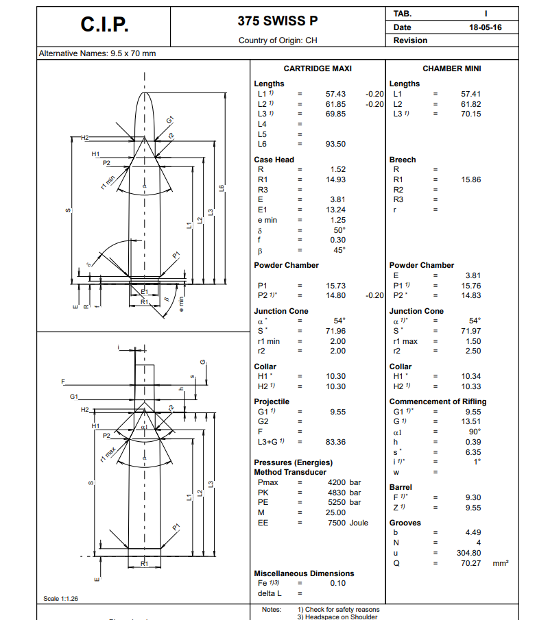

    I will have to pull the CIP specs but it appears to be essentially a LM necked up to 375.

    Notice that CIP approved date is 16.05.2018 so this was slowly cooking for quite some time.

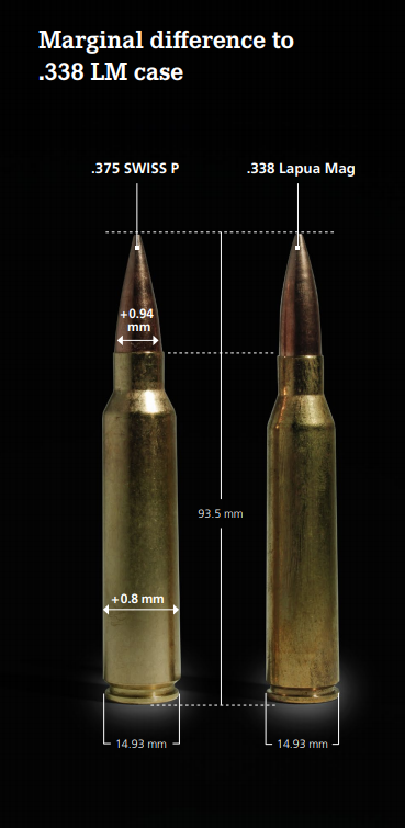

    Picture with case differences listed.
    Sincerely,
    Theis
    I'm assuming that depending on how the chamber is reamed, you could use the factory ammo which is a bit short and magazine feed it, or if you didn't mind single loading, you could run a longer VLD monolithic projectile?

    I honestly have not even compared the cartridge drawings of XC and the 375 Swiss P because in reality the benefits of RUAGs 375 Swiss P go well beyond any case capacity benefits.

    NOTICE the date in top right of the CIP file....Predates most of the "Big" cases with LM boltface :)

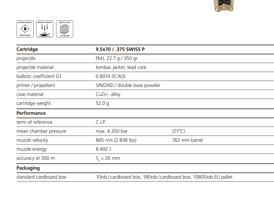

    Increased bolt thrust due to larger case diameter, both .338LM and .375Swiss P spec 4200Bar pressure .
    Ammo will be available supposedly sometime April, the AP version is expected to be available from the end of 2021.
    Currently, PGM and Voere offer the new caliber in their rilfes. For the time being, the .375 Swiss P is intended only for military/LE users.

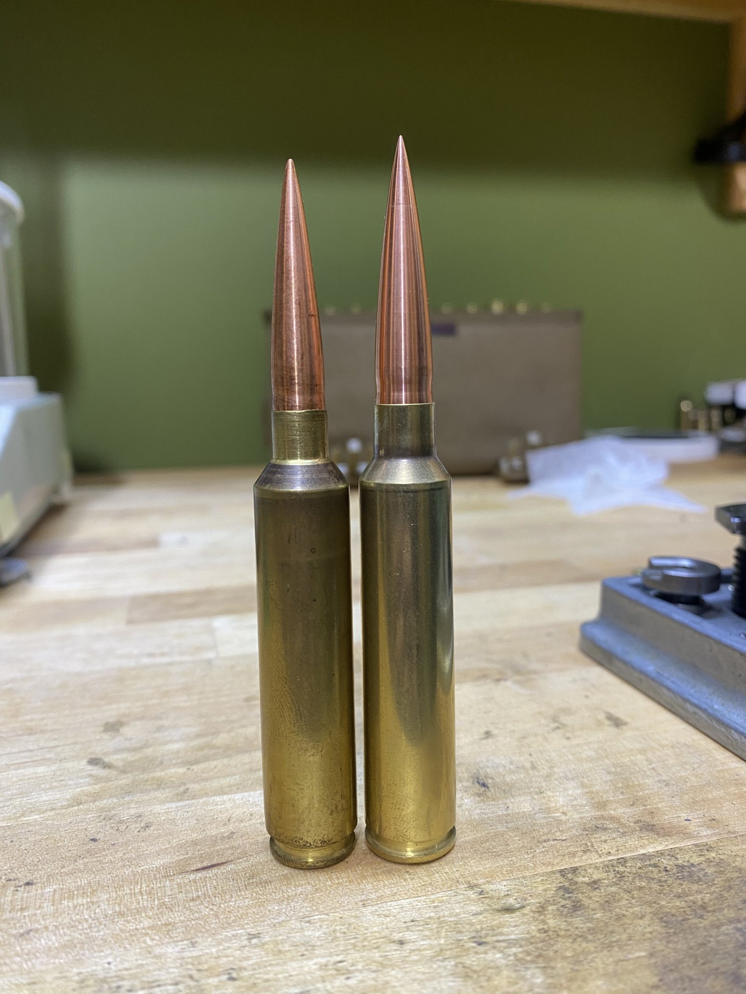

    That pic is the 285 on the left and 350 on the right. Both have a very long ogive. I don’t think they would work in a mag. Like trying to use a 90gr vld in a AR
    Thanks, I had misread the caption on the picture.
    The Bulldozer ones look to be shorter and fatter, which might work but I guess they don't quite have the BC of the ICBM ones.

    At present, there is just one load with an FMJ / 22.7 g / 350 gr bullet
