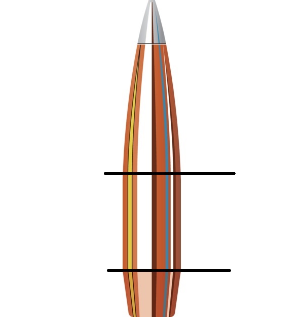

    Does anyone have a bullet they could measure for me. I am trying to have a reamer set up. I just need to know the length of the bearing surface. The distance from the boat tail junction to the ogive. Much appreciated
    Ok sorry another question. It seems most of you guys are saying these bullets like 0.100" jump. I am assuming you all have a fairly long free bore to accommodate that, do you have decent accuracy with the solids jumping them what I'm assuming is .250-.300?
    reason I ask, I want to shoot these hornady bullets but haven't been able to get my hands on them yet and from what I have found its no problem to order up say some WTC flatlines and have them in a couple weeks.
    My chamber is the "regular" cheytac chamber but with the one exception of the freebore. I forget if it's 150 thou of freebore or 150 thou *more* freebore than the drawings on the Peterson cartridge website. (BTW can anybody tell me which measurement on this drawing represents the freebore? https://vertassets.blob.core.window...7c-4837-9f62-ce16bb6fc15d/_375__9_5_x_77_.pdf)
    I never shot solids in this barrel, and whenever I did shoot them in other barrels, it was 352 CEB loaded to the driving band. I've always had the same chamber cut from the same smith in SLC UT area who uses a DT reamer.
    I have shot about 300 of the A-tips, and have another 500 on hand that I got a couple of months back for about $34 per box at shooting surplus. Looks like they shipped directly from one of the distributors, Bill Hicks
    That's a pretty janky diagram to read but the freebore is S - L3= 3.86mm which is approx 0.150" so I'm guessing that is what you have.
    that being said I am assuming you have the boat tail below the neck shoulder junction to be able to jump them 0.100"

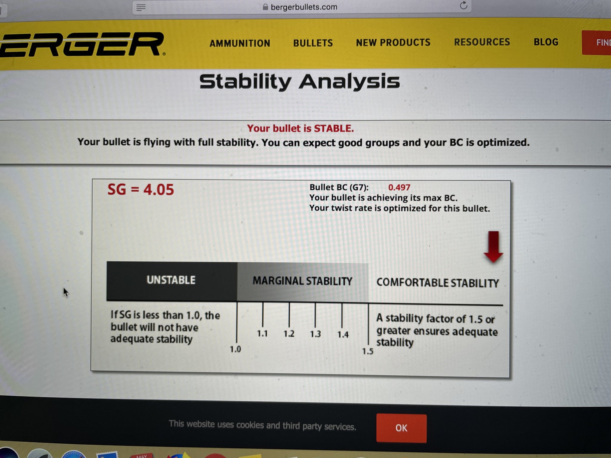

    These A-Tips couldn’t handle a SG of 4.05 today 🤣🤣🤣
    Not my rifle, it was a Cadex Shadow w 1-7. When they held together, they shot.
