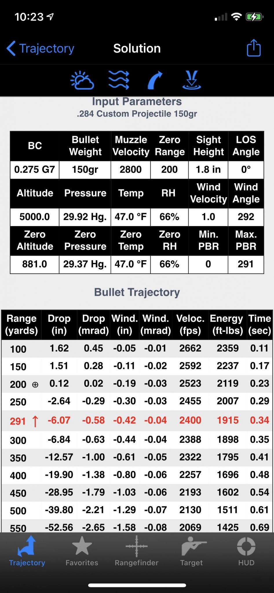

7mm08 with Nosler 150 grain ABLR at 2,800 fps muzzle velocity will carry 1,500 at 500 yards at 5,000' ASL elevation.
