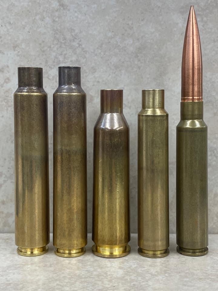

    Just announced today on fb by Robert Vestal.
    L>R: 458 vestal, 416 vestal, 416 barrett, 416 hellfire, 416 snipetac
    Per Rob’s caption:
    “Attention ELR Shooters!!
    Introducing the 416 VESTAL & 458 VESTAL
    In conjunction with Gary Bruce, we designed what we think will be game changers for the ELR community!! Both have .640 (Cheytac) size rim, however the body is larger in diameter and longer. Brass is already formed and has proper head stamp. Ready to load out of the bag. The 416 Vestal is able to launch a 550gr bullet around 3100fps while the 458 Vestal can push a 650gr bullet around 3000fps!! Brass is in stock and chamber reamers/headspace gauges are currently in production. Load data consists of over 200grs of powder!! Also note, these new cartridges use magnum large rifle primers and NOT BMG primers and have been tested down to 40 degrees with absolutely no hangfires. I will be posting load data soon as we are currently testing more powders. Stay tuned!! “
    per a comment by Rob: “most any action suitable for a cheytac. However just make sure the ejection port is long enough. The BAT CT port is too short to eject a fired case.”

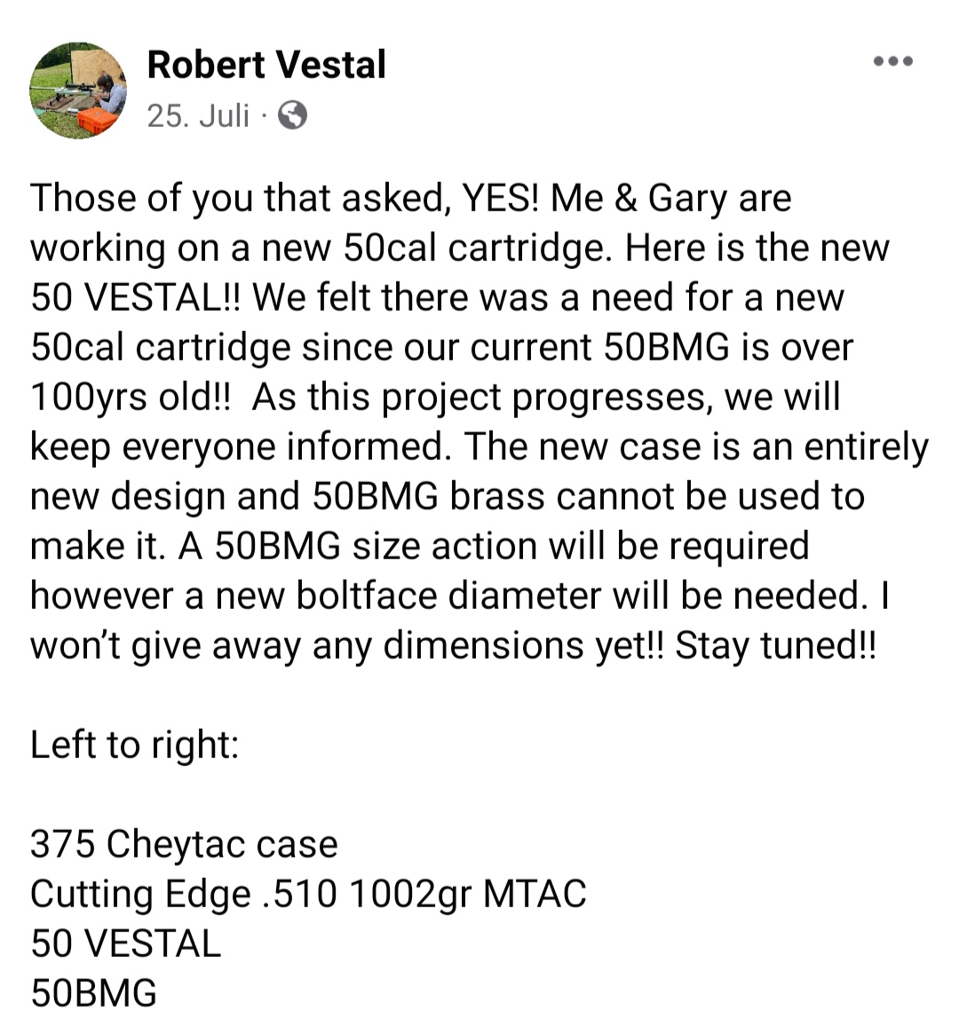

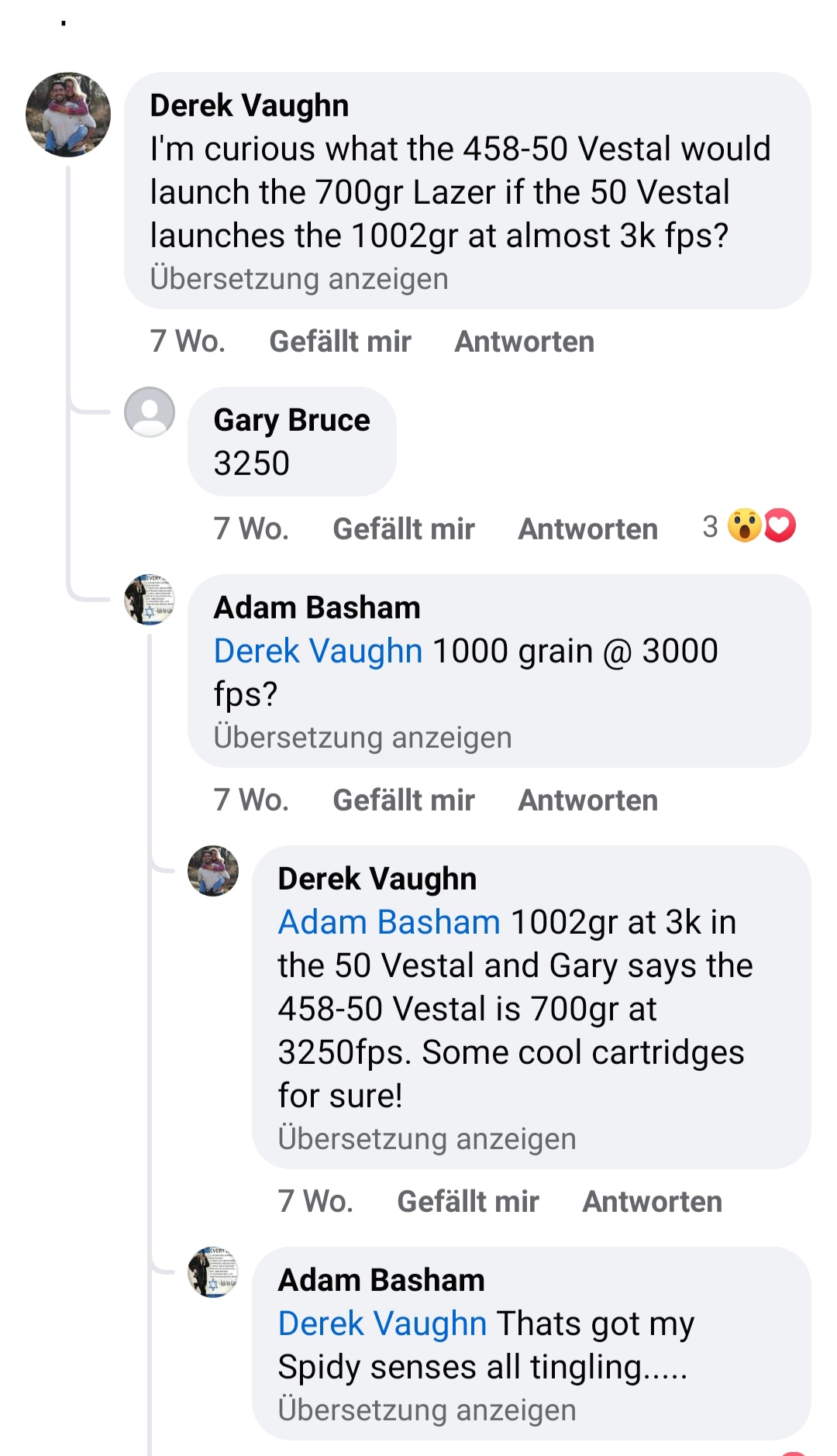

    But much better performance. 1000grain at 3000fps.... we're talking 19981(ft/p) energy. I like the idea of bringing the 50 cal into the next century. Furthermore, I am only aware of one 50cal that is even more powerfull.

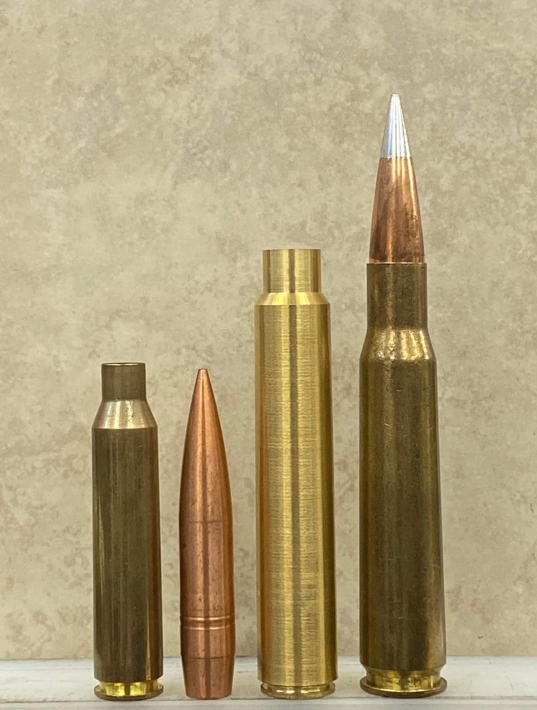

    50xc is more like the 416/458 vestal necked up, which they are trying
    .50 vestal isn't cheytac bolt face.
    Does anyone know when Vestal is expected to be done with the cartridge and bring it to market? Would love to have a look at the cartridge print.
    I wonder if the 510 will use a .700 BF like the Colossus cartridges. That way you could jump into a Pierce 20X and be ready to rock
    I wonder if the 510 will use a .710 BF like the Goliath cartridges. That way you could jump into a Pierce 20X and be ready to rock
    The goliath rim is .850 the colossus and blitzkrieg is .700 . 710 bolt face known as xnihilo rim pierce 20x.
    My Understanding according to what has been posted on face book pages the 50 vestal will have a .700 rim diamiter but who knows till its done . It would make it easy sence it already exists .
