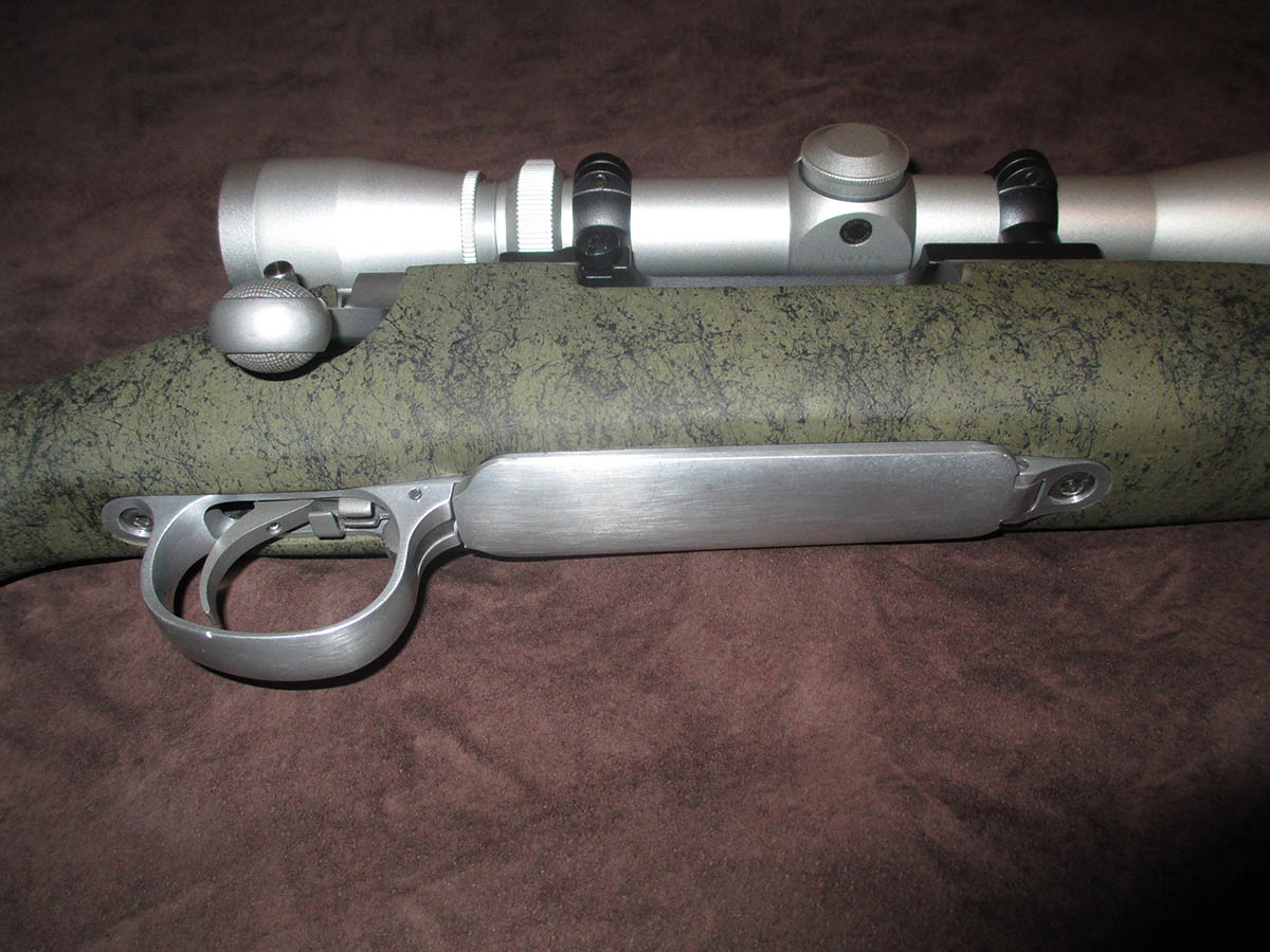

BTW, swap out that anemic bottom metal for something billet at the least, those old remington ones were pot metal.
