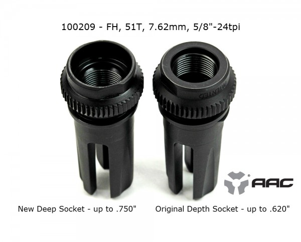

Also, within the choice of brake/FH/brakeout - pay attention to the exactly which model you get if you see them in the store. Look closely at the base to see the profile of the rear end of the muzzle device, and seating depth. Some are flush fit to go against the shoulder on a heavy barrel profile; others have a tiny lip to overlay a smaller profile barrel. You can call AAC, assuming you eventually reach a human they can explain the difference in the models.
