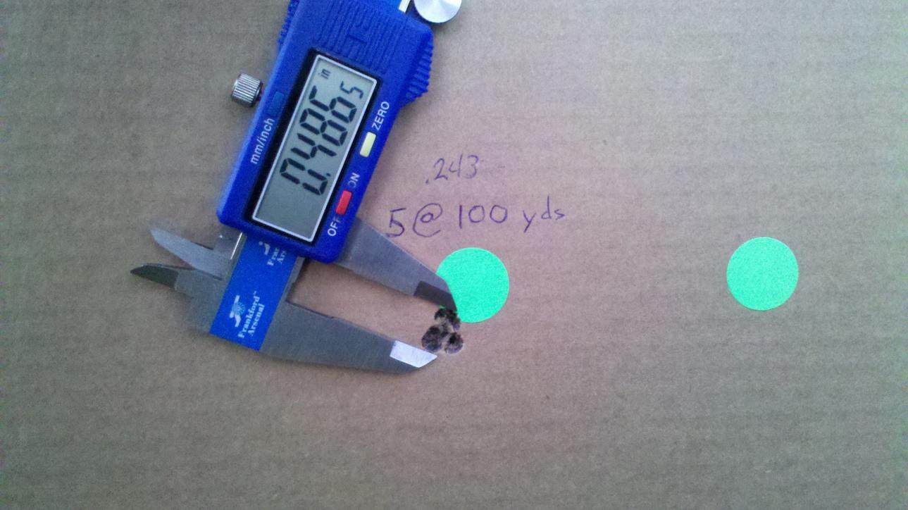

2013-09-15_18-53-23_637.jpgno...this group includes the first round cold clean can
