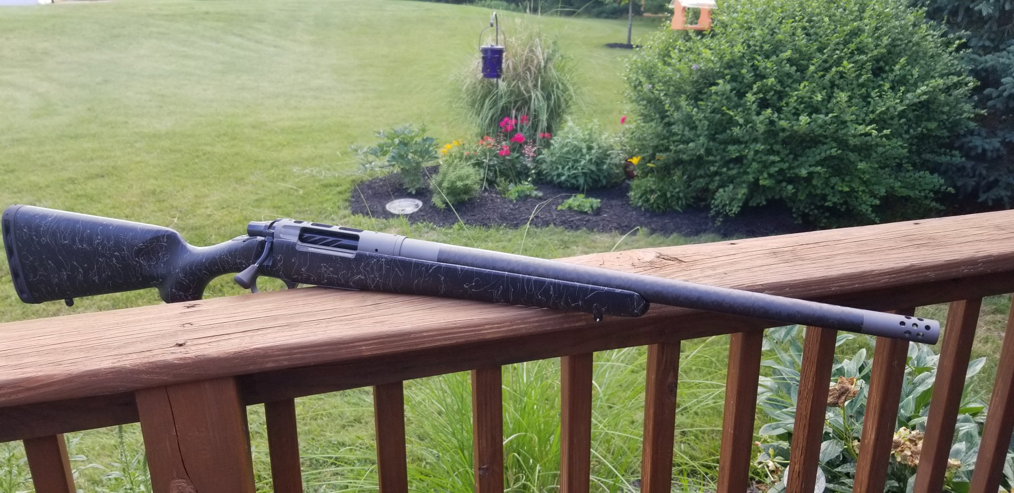

Looking for a way to use a BDL style floor plate with a Mack bros Ti action . Been gathering parts for a build and didn't notice the cutout in the bottom of the action will not take the sheet metal internal magazine. I have the new and old style HS setups but there're heavy and the new style hangs down too much .
Hoping maybe someone offers the browning style plate that holds the magazine?
Thanks
Not to my knowledge, but the Magpul Hunter setup isn't a bad one. Takes AICS pattern mags, as well as the Magpul PMags.
I think Hawkins makes something similar to what you're looking for... I could be wrong. Worth checking though. Also, Wyatt's Outdoors makes some special mag setups. Badger Ordnance also makes some REALLY nice bottom metal setups, but they're pricey.
I believe the bottom metal I have now is Hawkins brand bought from another supplier.
According to their site; "Do your actions use a Standard Remington pattern trigger and bottom metal?
Yes, they do."
So find the bottom metal you want and if it hangs too low the stock must be the issue.
What I meant by hanging low is the magazine has an extension hanging down . We milled the stock for the Hawkins metal .
