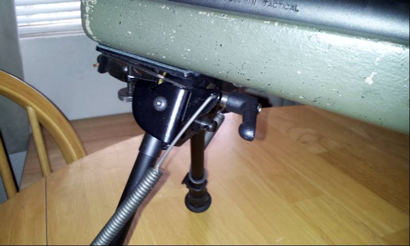

I have a nifty lever installed to replace the standard not-so-nifty knurled knob.
Tilt adjustment is so easy even I can manage it.
