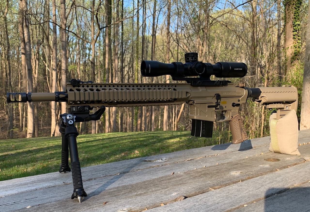

    Just finished assembling a Franken Recce with the button Proof today. Pretty pleased with how it turned out. Hopefully it'll shoot well.
    First rounds go down range Friday. IMI 77 Razor Core & MK262 77smk hand loads I'm working on now.
    View attachment 8116864View attachment 8116865View attachment 8116866
    Looks good Brother..
    How was the fit in the Mega upper??
    Fit is very good. I normally install the national match shim in the upper, but this ADM lower has the nylon headed tension screw.
    Added a .003 shim with the front take down pin.
    Very tight, zero rattles.
    Reactions: bigjake83

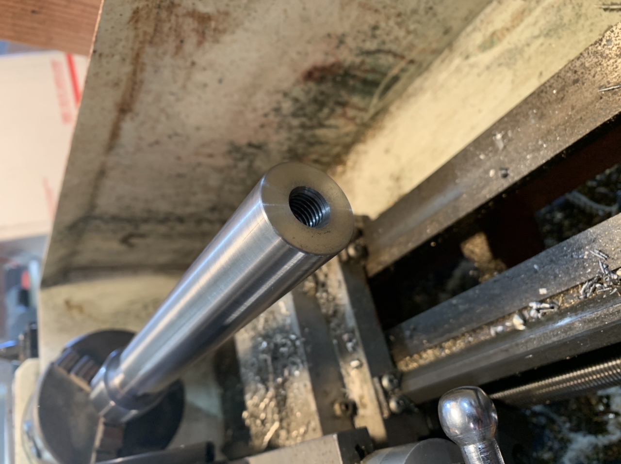

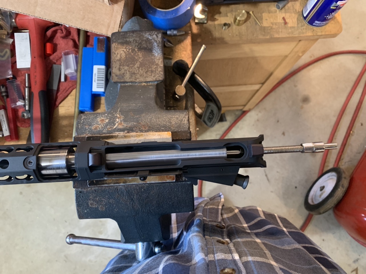

    How did you pull that off, isn't that a monolithic upper?
    It is a true monolithic. I drilled and tapped the back side of a Brownells truing mandrel, added a flex attachment. So I hook the drill up at the rear and pull the mandrel to true. Works well.
    This is the set up. Made it for a Vltor Fusion mono originally.
    Reactions: bfoosh006 and S197

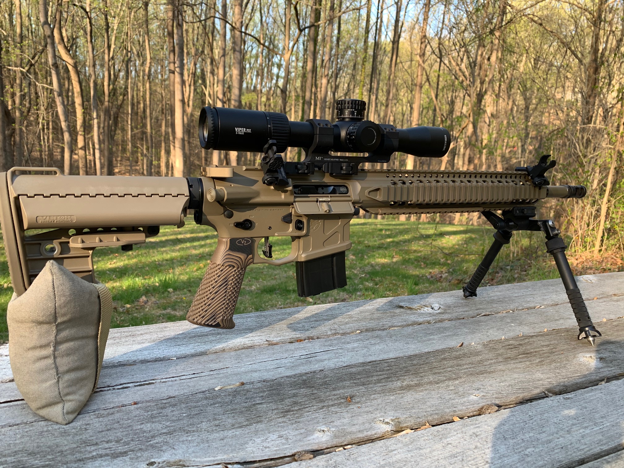

    Have an update on this Recce/Proof button barrel. I'd say the Proof button barrel is GTG & a solid buy especially for the $239 I payed.
    Gun has been flawless.
    First off the barrel head space was go +.001 with a new RCA bolt.
    It has run everything I've put through it so far with the Riflespeed gas block settings 2-4 for 3:30ish ejection. I started on setting 6 and it spit the xm193's at 1:00, down 2 clicks brought it right around to 3:00. I'm digging the Riflespeed block.
    Setting 2 was with healthy doses of Lever evolution that produces lots of gas.

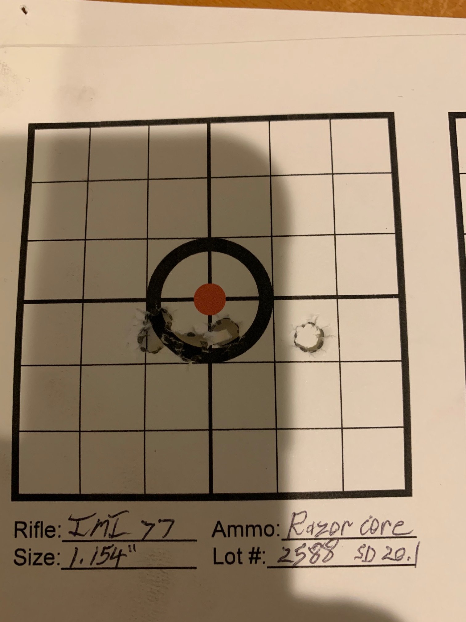

    Factory Federal 5.56 XM193 bulk 55gr. Box said 3165fps. Actual in this barrel was 3159 avg with SD 23 across 10 shots & was only good for 2moa
    Factory IMI Razor Core 77 smk went 2588 / SD 20.1 & grouped 1.154"

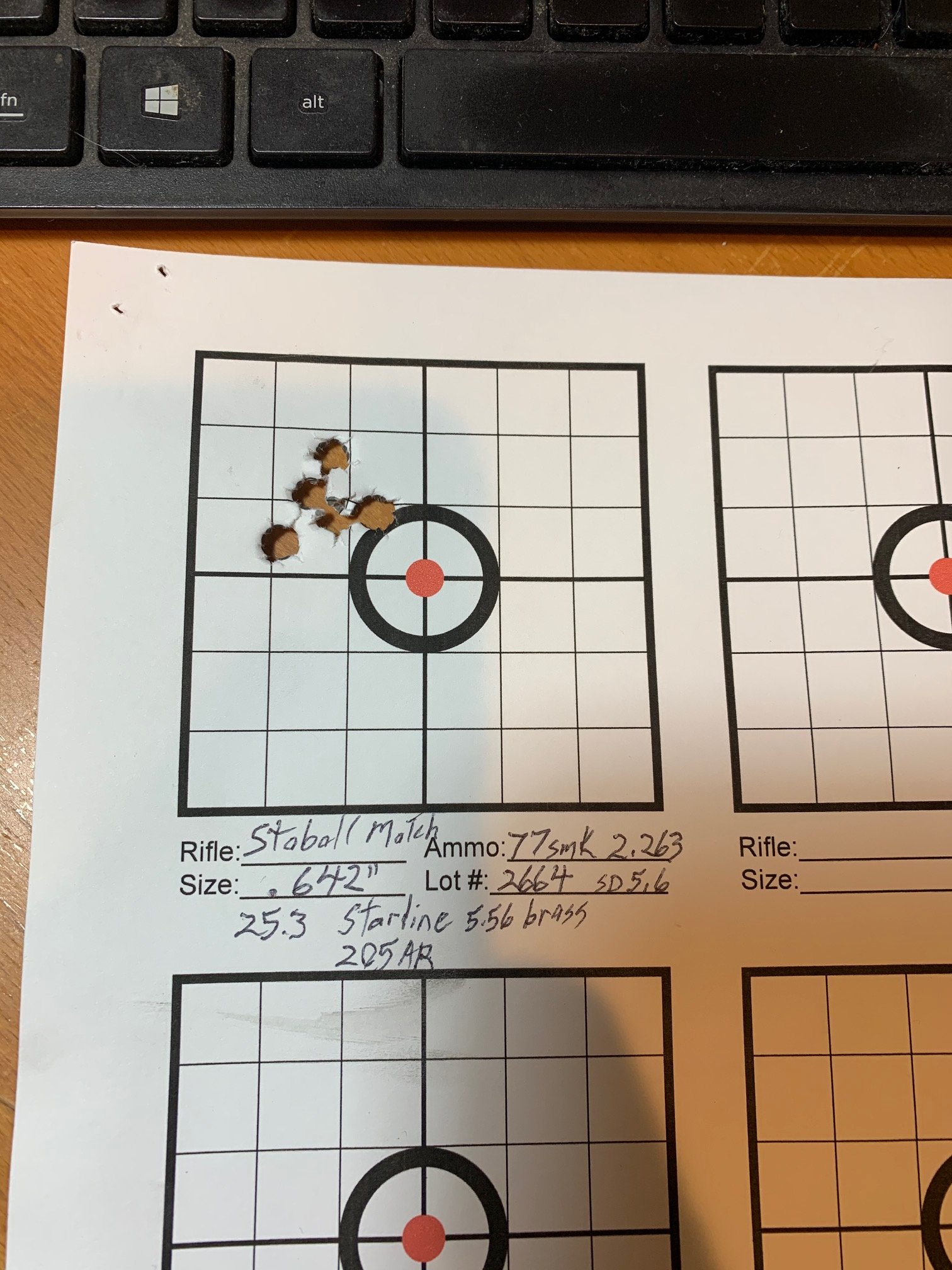

    Staball Match
    25.3 with 77smk @ 2.265 = 2664 / SD 5.6

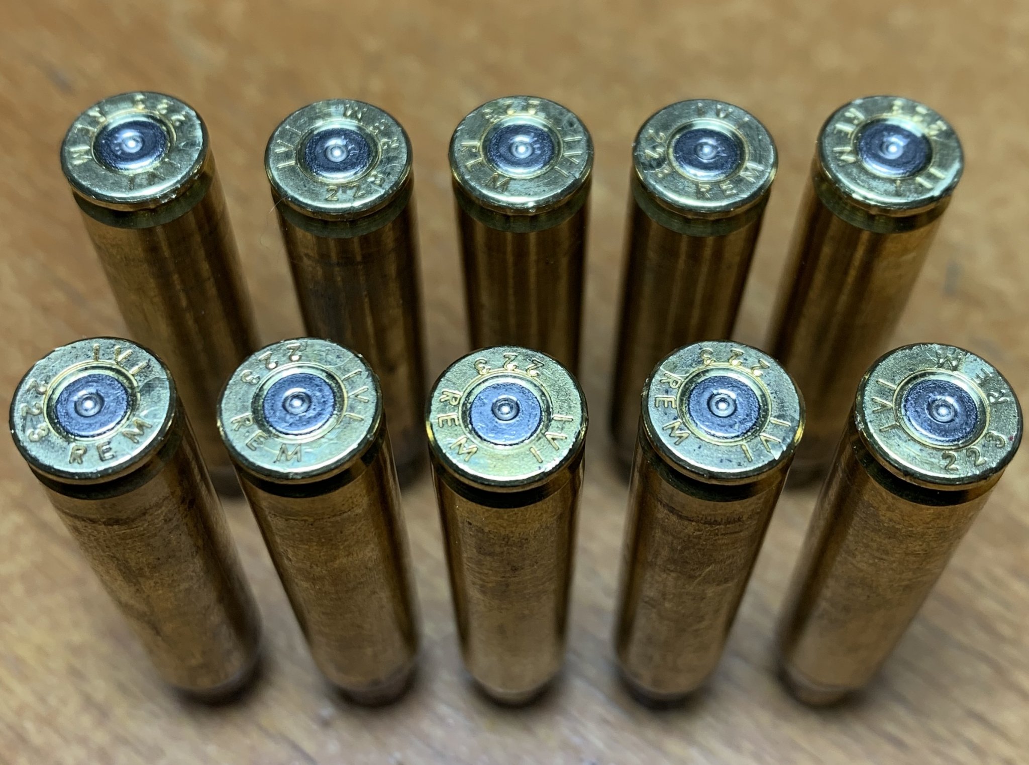

    Brass pictured below, top row is Lever @2770 Bottom row is Staball match @2665
    Wouldn't know there 100fps apart from the brass. For a mid gas barrel, it's not beating up the brass even with these full power 5.56 loads.

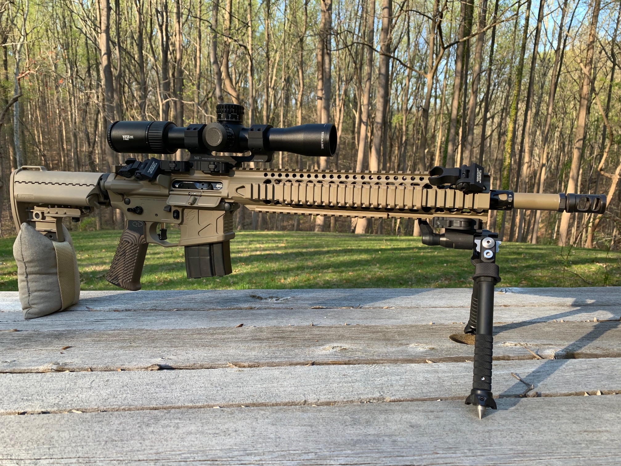

    Little update. Second outing after first cleaning.
    Changed scope, more on that later.
    Sighted in with bulk 5.56 Blaster ammo & then switched to factory IMI 5.56 Razor Core 77.
    Didn’t have much time today for the AR, 22 match tomorrow.
    This button Proof is impressive.

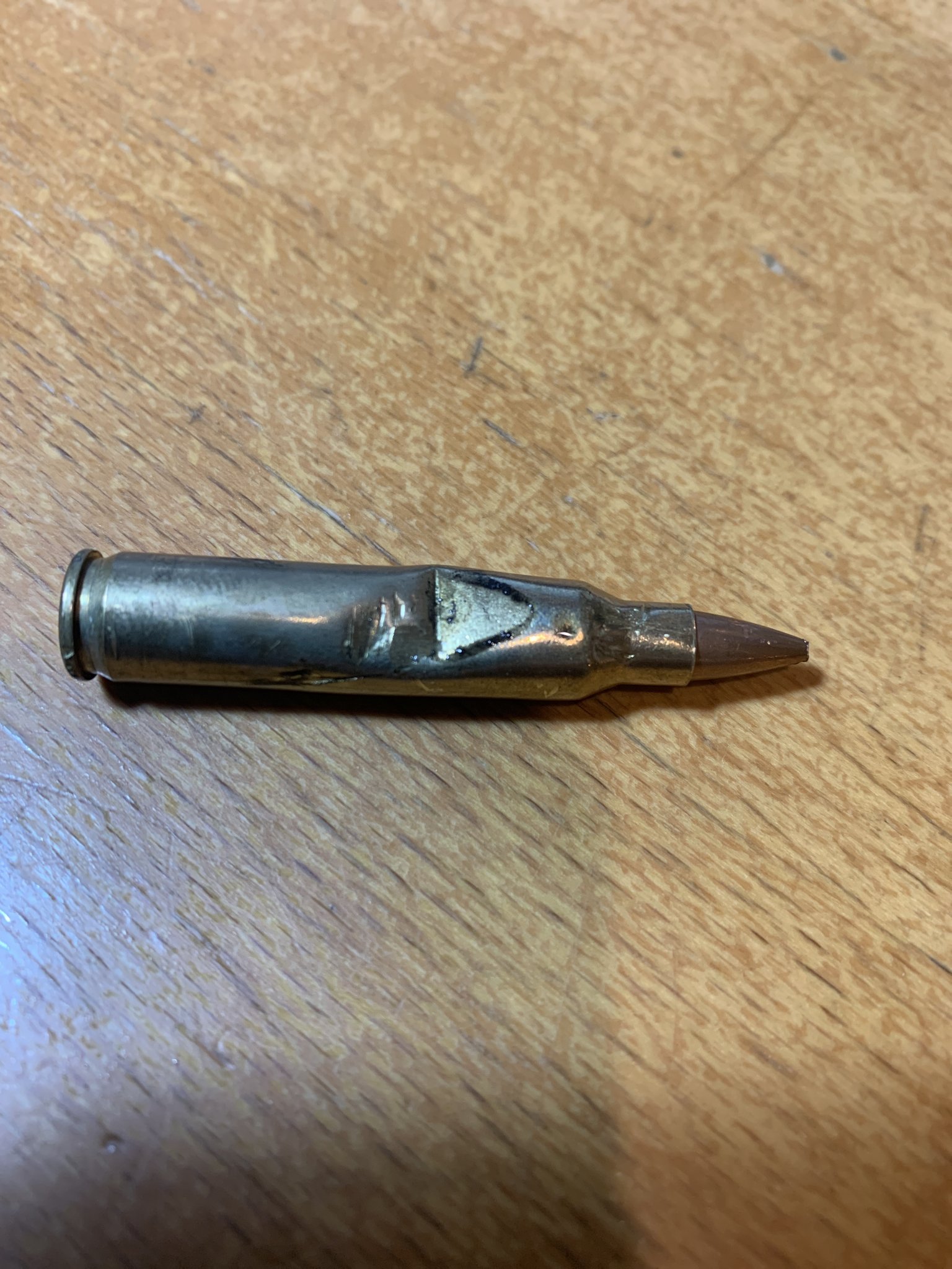

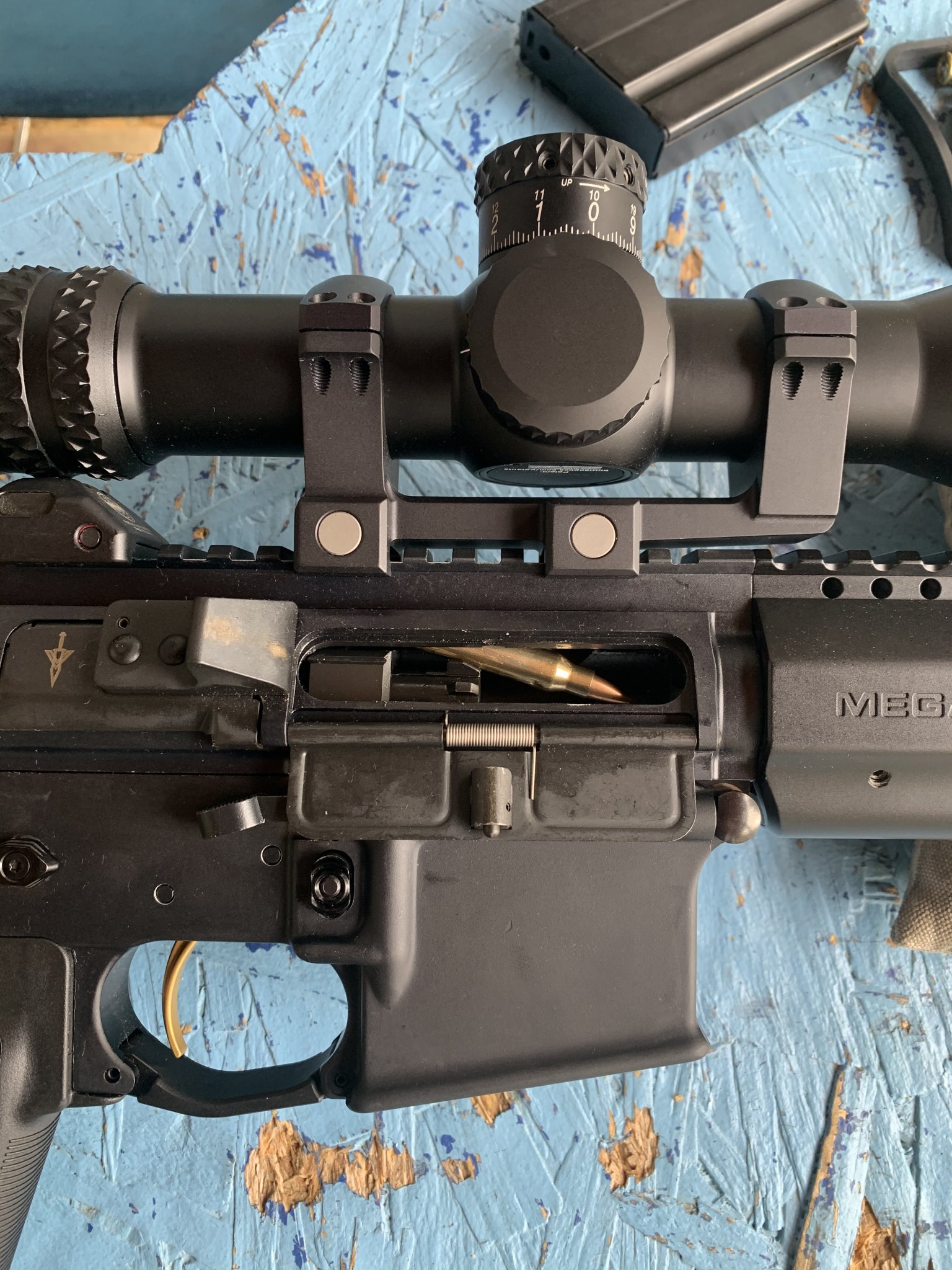

    Oh yeah & this happened to my SPR on the 6th round, never had one of these before.
    looks like a shooter!!!!! how do you like that adj block
    I’m digging the block. There not cheap, but it works very well. They give you 2 adjustment pins with the block. Each pin can run 2 rotations or have adjustment range 0-12 x 2. I’m running the std. Pin between 2-4 unsupressed. It’s very responsive. 2 clicks brought ejection from 1:00 to 3:30 when tuning it. You can also change out the front coller if ever needed due to hand guard length change.
