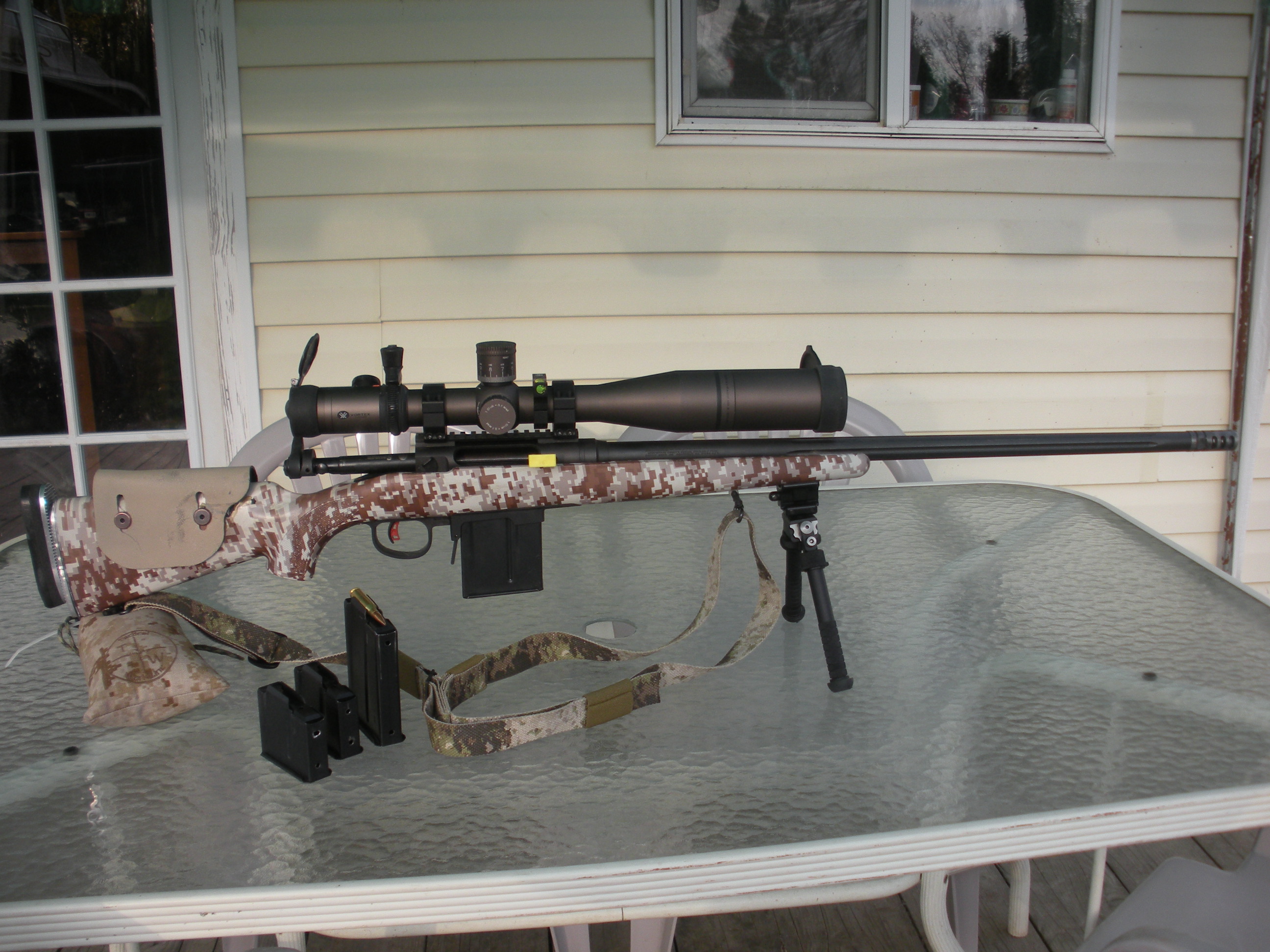

I have an "old style" flat rear savage 16 in LH stainless.
McMillan can fit a savage into any action that they can fit a Rem 700 action.
This is a Mc Millan classic in GAP camo.
Since this photo was taken, I have fitted it with CDI precision bottom metal.
The OLD STYLE action was a true staggered feed magazine. I use BOTH AICS and AI AW magazines in this rifle.

I am about done with this barrel. It will go to Bartlein in August for some work and a new tube.
