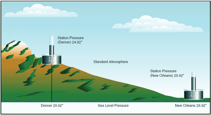

A picture is worth a thousand words. :) Use Station/Absolute pressure, do not input altitude as mentioned in the posts above unless you are using corrected pressure.
