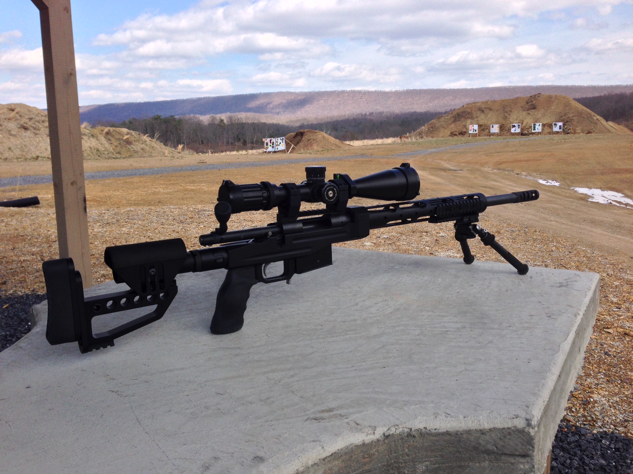

Rem 700 AAC-SD .308
XLR Evolution Chassis in ultra-flat OD green Duracoat
XLR folding stock adapter
11" XLR rails
10r AICS mag
Timney Calvin Elite Trigger
Vortex 4-16x50 FFP MOA/MOA
Butler Creek flip caps
NightForce two-piece 20 MOA base
Burris Xtreme 30mm ultra-high rings
Flatline Ops Accu/Level
KRG Bolt Lift
Atlas BT10-LW17 bipod
YHM Phantom QD brake (YHM Ti Phantom not shown)
Barrel and action Cerakoted in Desert Verde by X-Werks in Pheonix AZ

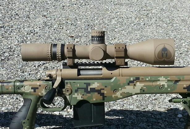

Manners T6A
Bushnell ERS G2 Retical
PT&G Bottom Metal also Koted in Desert Verde
Badger rings

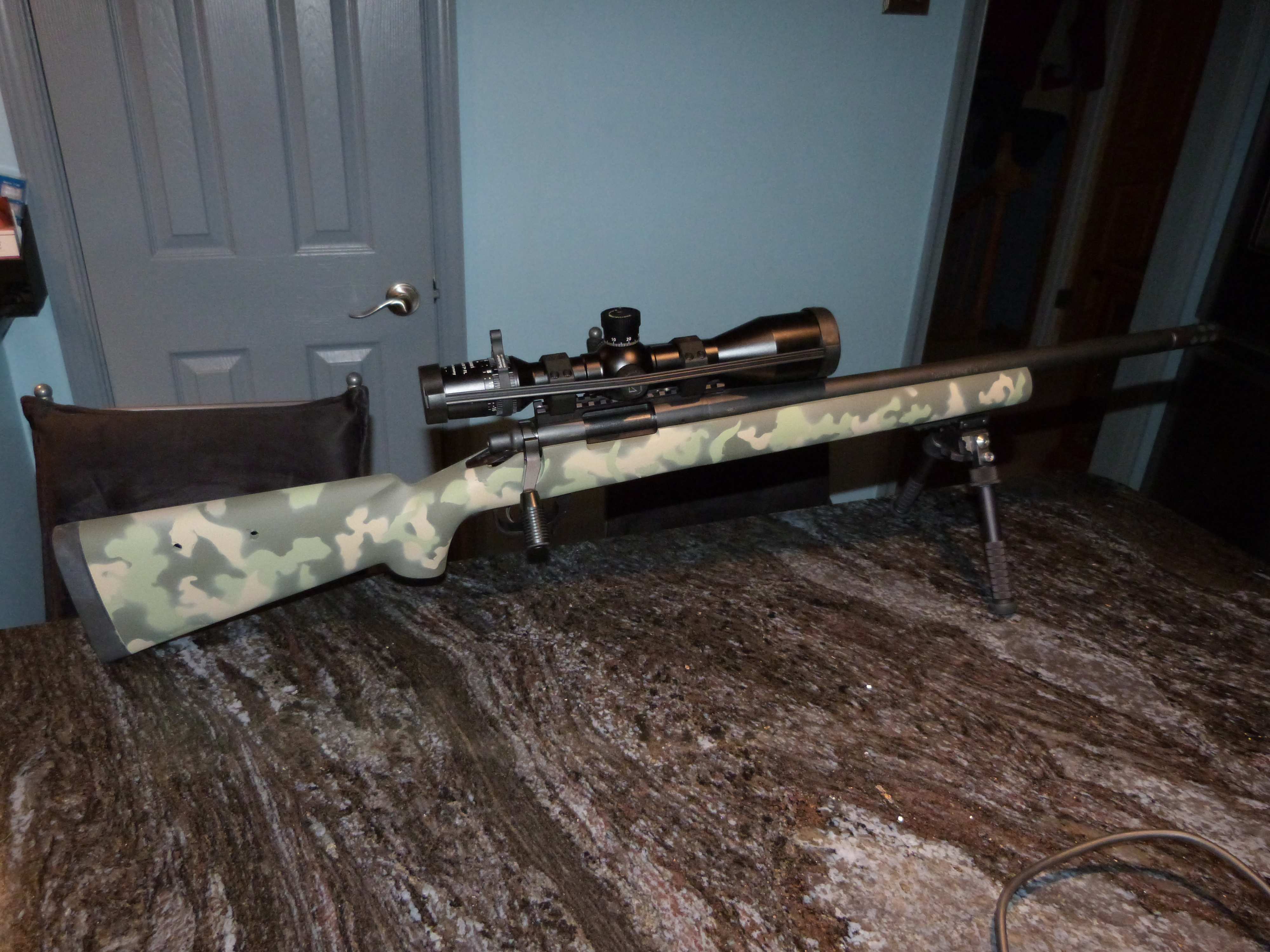

HS Police stock bedded with Devcon and M5 DBM bottom metal
EGW 20 MOA rail pinned and #8-40 screws topped a Zeiss Diavari FL 4-16 in Seekins low rings
X-Mark Pro trigger with a spring from erniethegunsmith.com set at 3 lbs., surprisingly nice break
My own bolt knob upgrade
AR Performance muzzle brake opened up for .30 cal
Missing in the photo is a stock pack from Triad

Rem 700 AAC-SD .308
11" XLR rails
10r AICS mag
KRG Bolt Lift

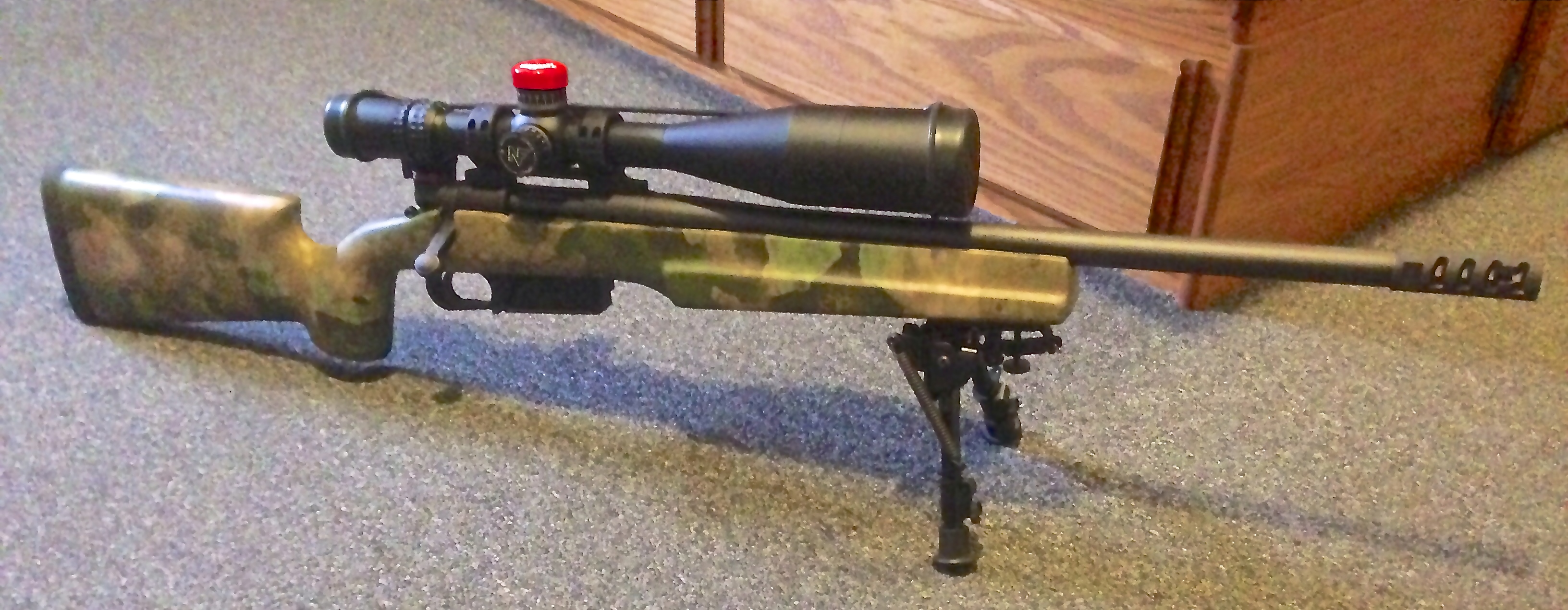

AAC-SD, trued
Still the original Remington trigger, but tuned down to 3 lbs
Krieger fluted .264 barrel, chambered in 6.5 Creedmoor w/ AAC-51T muzzle brake
PTG fluted bolt
XLR Evolution folding chassis
Nightforce 20 MOA rail
Leupold MK4 high rings
Bushnell ERS w/Butler Creek caps
Atlas Bipod

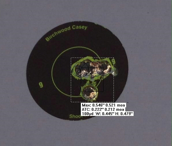

What kind of groups are you guys getting after dropping the action into the XLR? What were you getting previously?
I never shot it with the original stock. Also, to be frank, I'm new to precision bolt actions (this is my first, only 200 rounds) and I haven't had a chance to have a more experienced friend fire it yet. Still, as my skill level has grown in the three range trips I have had the rifle has performed. So far, I have been able to get consistent .61 to .74 MOA groups with quality match ammo. These are five shot groups and in most cases would have been quite a bit smaller if not for one shot, which I'm pretty sure is me. I think the rifle is capable of .5 MOA or better, with the right ammo, but I have not proven that yet. I hope to prove that both I and the rifle can do it in the not too distant future.
Getting rid of the original stock is a given. There are plenty of highly skilled shooters who can't even get 1 MOA with the Hogue stock on these rifles. In most cases, it flexes and touches the barrel.
