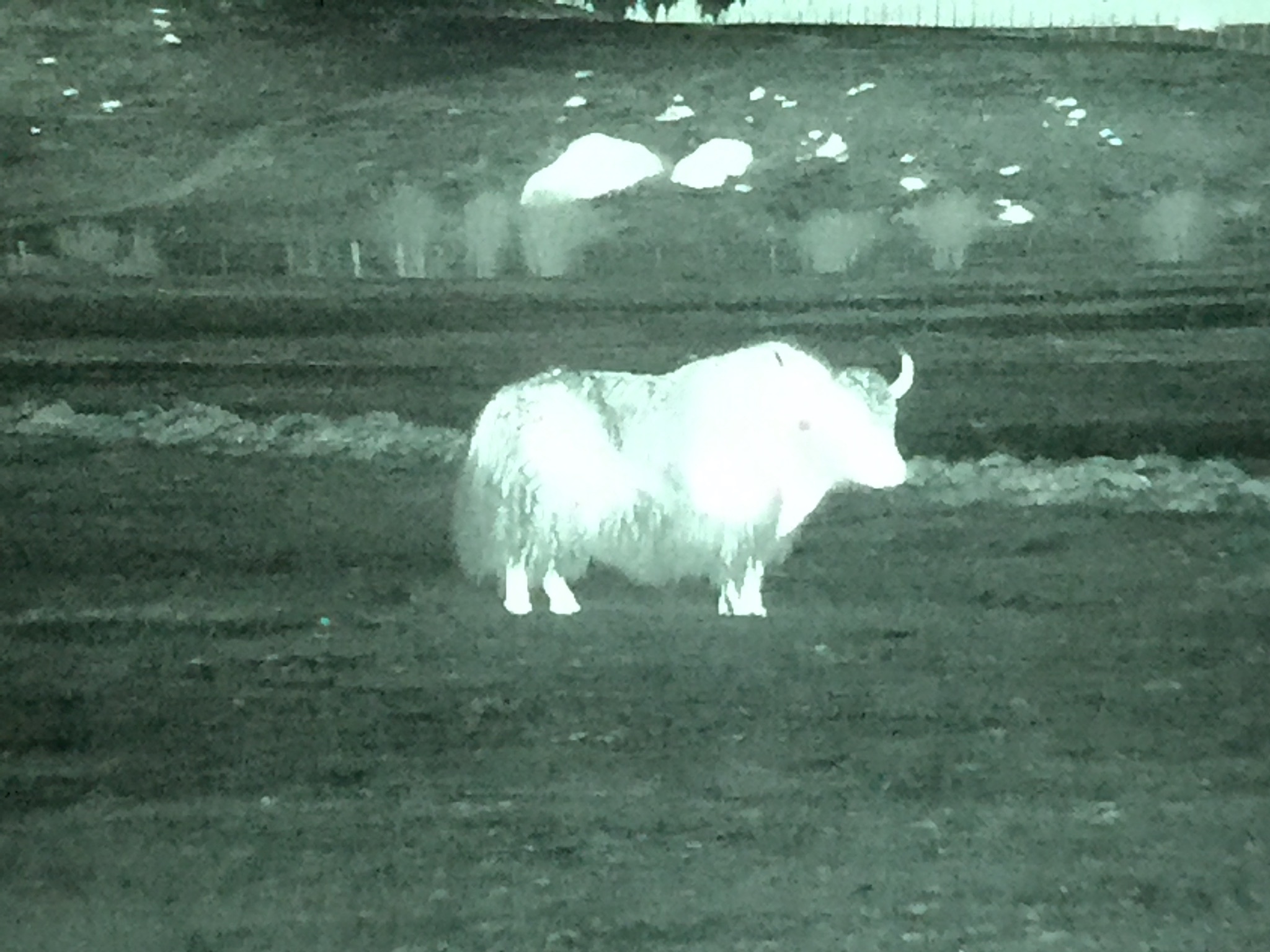

The rocks on the hill are at 500 yards. One of them is a laying down coyote. With a 1X scanner there is zero hope of knowing that. (Cell phone pic taken through Reap-ir or Halo LR i forget which). That’s a Tibetan yak bull.

The rocks on the hill are at 500 yards. One of them is a laying down coyote. With a 1X scanner there is zero hope of knowing that. (Cell phone pic taken through Reap-ir or Halo LR i forget which). That’s a Tibetan yak bullView attachment 7766813
You won't know it's a coyote by looking at the pic, but when your actively spotting and see it move, you know it's something alive and usually, rocks don't move.
Even a 2-3x thermal spotter at 500 is hard to get an ID a yote, without it moving and getting eyes on it with proper NV.
That's why it's a spotter and also why my thermal spotters are 384 and scopes 640.

I tried 1X. All it told me most days was, “yep, there’s still dozens of glowing things out there”. My whole AO was like that pic. Several thousand acres. There was literally no point in verifying that the rocks still glowed with a 1X. After every scan, I’d have to bring up the rifle for a closer inspection of the “rocks”, so there was no point.
I tried 3X. Much more often it at least told me something was alive out there. There comes a distance at which a coyote doesn’t even make a white pixel in a 1X but is still recognizable to a 3X (same core).
Much of my scanning was from a moving (55 mph) vehicle, so looking for movement wasn’t a main indicator.
