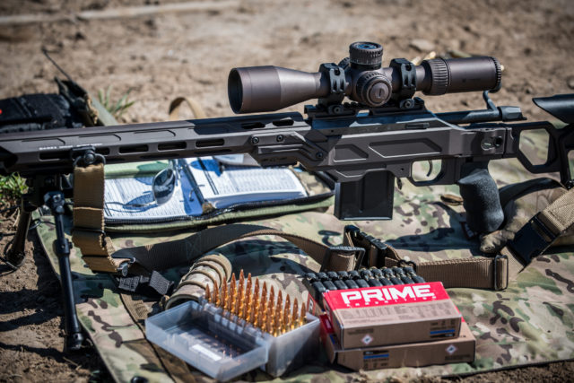

Gathering Data
Gathering Data
Here is why:
If we gather our Dope by walking our shots out, actually shooting each yard line distance and recording the data we include everything. All the drifts are in that number. There is no such thing as a “No Wind Day” if you experience one consider yourself lucky, but practically speaking, no wind doesn’t exist. If it did, Coriolis would not exist. So under normal circumstances, we zero and dope our rifles with everything already included. Then when we go to our “Data on Previous Engagement” it’s taking into account these factors. If today I am shooting to 1000 yards and used 7.4 Mils to hit center along with .75 Mils of wind for 5 MPH breeze, that assumes all the drifts and drop data is in there. If conditions change because of the location or atmosphere, a computer will help account for it rather than the old, outdated rules of thumb, but still, hitting the target usually happens. We see this every week in tactical rifle matches around the country. Guys travel from their home location to ranges 500 miles away and hit. Why do they hit, they practiced and recorded their DOPE. Talking to several high scoring PRS Shooters, they strive to nail down their data so elevation is a given and their only question becomes the wind. In known distance courses, they consider this information their zero data. They essentially re-zero the rifle for each yard line.
Now the wind is the most significant drift factor we have and actually will offset some of the other drifts. It depends on the direction and speed, but it will cancel out or increase several of the other factors. So, it’s essential to understand the wind. No dispute, you need to know what is going on here as it can control so much of how we hit the target. That includes elevation changes. It’s not unheard of to have a terrain feature in or around a specific yard line that causes an elevation issue, so even if everything with the computer lines up, your 700-yard Dope is off because the wind changes the flight path. It often has people scratching their heads. Why does that one range not line up, well it could be the wind.
Still, if we recorded our data, we know what the wind was doing, so if we doped the rifle in a 5 MPH wind, going to an 8 MPH is not like starting from zero. While they might say an 8 MPH wind will move the impact .1 Mils up or down, it’s only 3 MPH we are dealing with. We already accounted for 5 MPH, so why add 8 MPH on top of the 5?
If you’re modeling the shot on a computer, I can see the importance of all this. However, it’s not the same as shooting it. Not to mention, we miss out of adding our spin to the bullet. Weak fundamentals will NOT line you up with the model. If you are adding .2 Mils of trigger hook to your shot and you want to call it Spin Drift, well okay, I suppose you can, but are we talking about the same thing. Why did I not use any, and you are using .2? Why is my wind call 1.5 Mils to hit the target and you are using 2 Mils to hit the same target? This situation happens every day, who knows maybe they are canting the rifle?
The point is, while all these effects exist, they are not equally distributed among the shooters. We all release the shot in our own unique way. So before you go adding all the drifts to your ballistic solver, try doping your rifle first without any software. Develop YOUR Dope to distance and record everything, then True the software to what you shot rather than worrying about what the computer said before your first round went downrange. After, go back and line the solver up. I think you will find the variations are much smaller than you realize. Solid Dope is hard to argue with as we all know the bullet has the last word.
There is no disputing what others are saying; there is a debate about how much it affects us at the target. All I am saying is, “it’s already in there” especially if you dope it first. One of the reasons why when truing the Kestrel, they ask you to remove the drifts before performing this function. They center up the wind, and they turn off the drifts, it’s at this point you true your software.
