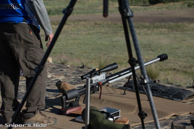

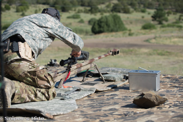

The rifle system, do you go the custom route, or is it better to use a factory offering? Consider a switch barrel set up like the new Accuracy International AX50 or the well established Desert Tech HTi system. Sure you might spend a premium a factory rifle such as these two champions, but being able to choose the caliber and switch for various conditions is never a bad thing. Spend $10,000 and have a multi-caliber rifle versus buying custom and decided that was not the best decision made absent any real intel.
I am currently working with the Desert Tech HTi in both .50 Caliber and 375CT two of the most common choices out there.
Be sure to pair your new hard charger with a bipod suitable for the platform. These are much bigger and heavier weapons systems so your $89 Harris bipod will not cut it. Now we start to explore the bipods in the $400 to $500 zone. It’s all part of it.

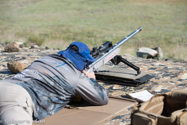

Finally, you need a telescopic sight for the system. Many shooters will often default to scopes with more magnification thinking they need to “see” more, but this is a mistake. You need to dial more and see less. The more air between you and the target, the more chance for distortion in the air. By distortion consider the case of mirage due to the ambient temperature outside. Remember we are out in an area with more land, they tend to be hotter, so that means mirage is in our way. The more magnification you use, the more you multiply the problem. Even shooting ELR Distances, I rarely if ever go above 25X on my scopes. Instead, I need elevation because bridging the distance means dialing on more dope.
I focus on the big players, the Nightforce, the Schmidt and Benders. Even Vortex with the Gen2 Razor has over 30 Mils of elevations. These scopes along with the mounts used will determine just how far you can successfully shoot. Look up the elevation specs of your chosen optics and then realize you want a mount with a minimum of 40MOA built in. In most cases, guys go even more, or they opt for the adjustable mounts like the ERA-TAC that lets you adjust it from 0 MOA to as much as 70 or more MOA. Once that is set up, you can then look at your situation and decide if you want a Charlie TARAC Unit or what I call a “Taco Unit” for extending the elevation. Essentially, it’s a periscope with a built-in or adjustable amount of elevation to bend the light so you can shoot farther. Using a Taco Unit was able to take a factory 338LM rifle with factory Ammo and a 100 yard zero and shoot to 4000 yards in the New Mexico desert outside of Roswell. It’s one of the best products to shoot ELR with and cost less than your average scope. It’s become a staple at the ELR Events.
