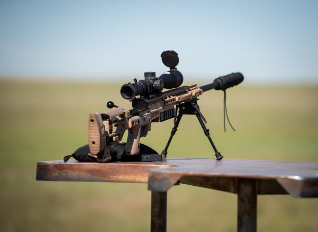

Setting the shooter up with an Accuracy International AX Rifle

Loading the bipod is often misunderstood. People think it’s about pushing the rifle forward with the shoulders. This is incorrect; you are loading the bipod from the core, our hips. It’s not about pressure, but more about dead weight giving the rifle a slab of meat to recoil against. It’s also bipod dependent as you are merely taking the slack out of the system.
A Harris bipod, one of the most common on the market has very little to no perceived movement in the legs. We load a Harris using one technique, where an Atlas Bipod has slack in the legs and movement. That requires are a different technique. The Harris is more of a rise with a knuckle under with the rubber feet. We do not push any bipod forward, but rather bring the rifle back into our shoulder pocket and move our core up. It’s a pinching method of holding the stock between the bipod and body.
The Atlas comes back into our shoulder pocket, then operating as one unit, we remove the slack from the legs using our core weight to hold it. This way, when the rifle recoils, it just flexes on the slack of the legs. About a 1/4″ of movement. Once the recoil pulse has ended, the rifle will return to the original starting point.
