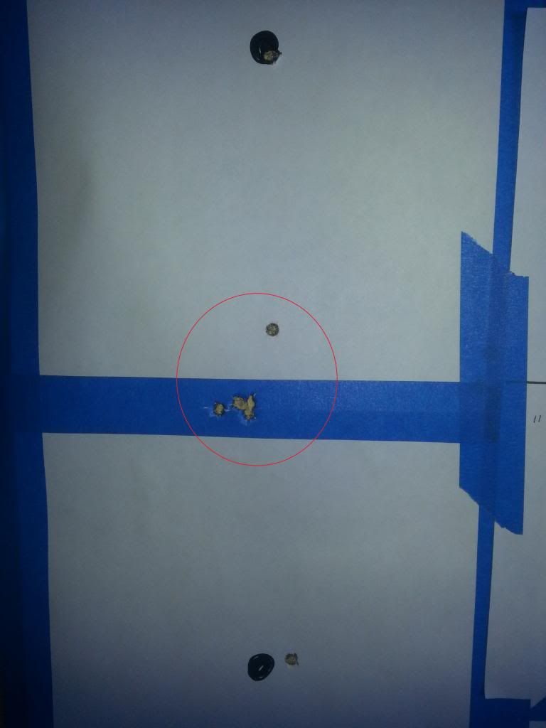

I held the crosshairs on the middle blue horizontal tape line and vertically centered on the two dots to shoot my sight-in rounds. They were 24.1gr Varget under 75gr BTHPs, These were full length resized, not annealed. Five rounds in the red circle. The top most round was my first shot, and I adjusted the scope down, and held on the same POA for the four subsequent shots. MVs were 2818, 2818, 2812, 2801, and 2818.

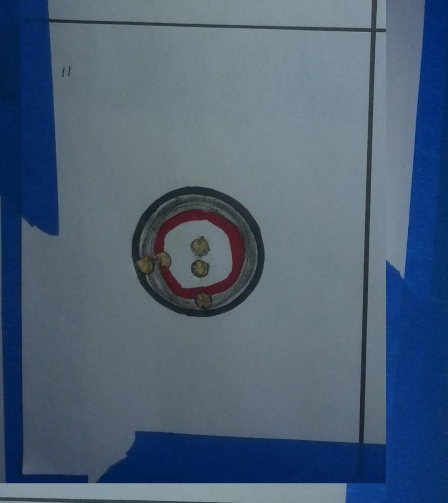

#1 24.1gr, BTHP, full length sized, not annealed, 2818, 2807, 2783, 2715, 2743:

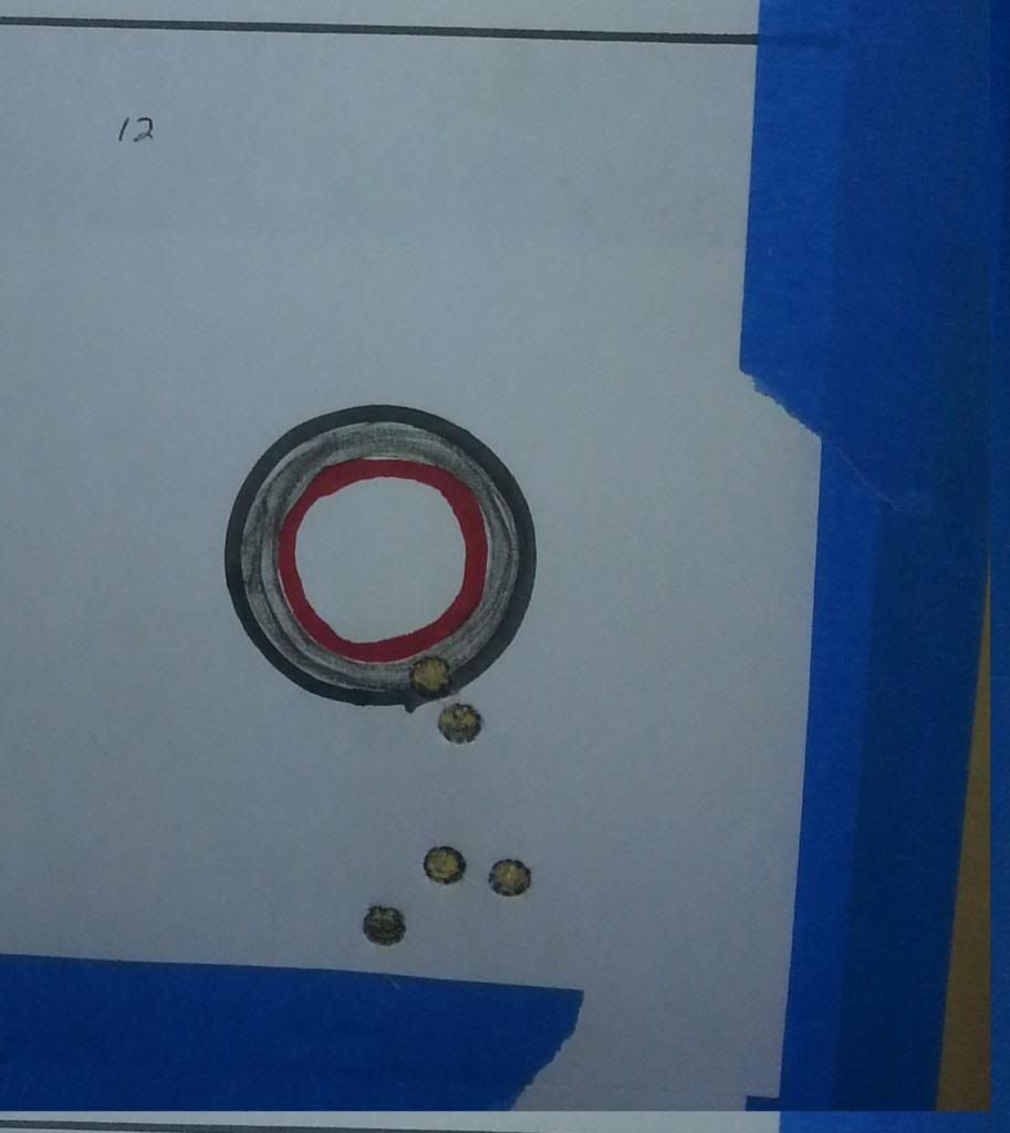

#2 24.5gr, AMAX, full length sized, not annealed, 2892, 2867, 2777, 2824, 2772:

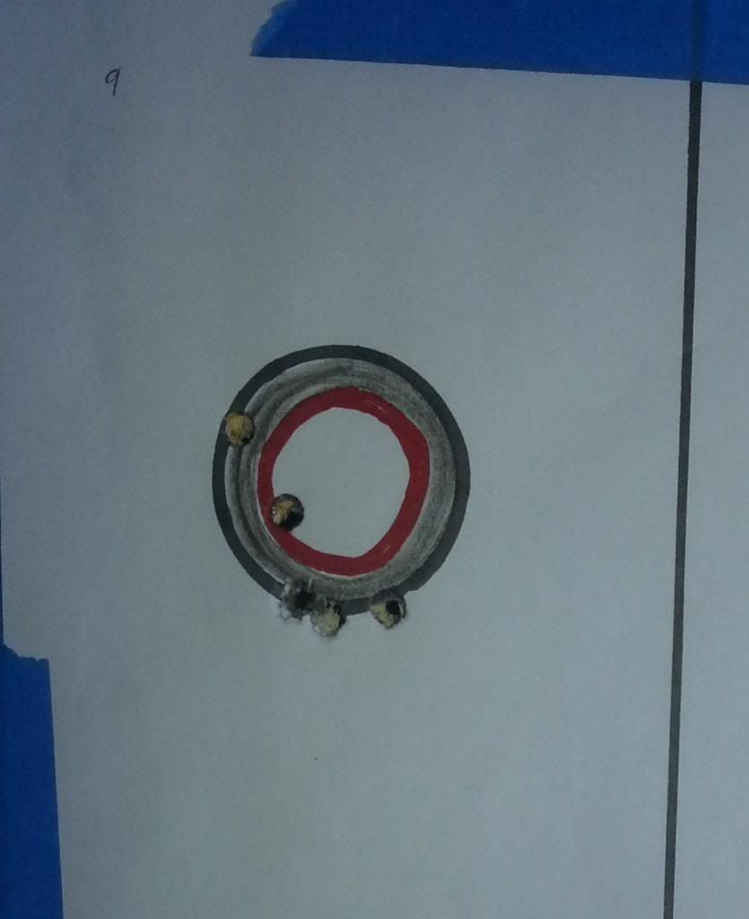

#3 24.1gr, BTHP, fireformed for this rifle, annealed, 2849, 2783, 2672, 2830, 2772:
#4 24.5gr, AMAX, fireformed for this rifle, annealed, 2849, 2760, 2672, 2721, 2772:
The sight-in group, while identical to test load #1, was the tightest group of the day. This was after 10 rounds of Speer, and about two minutes with the action open to cool, 30 seconds between each round.

FF/annealed brass (#3) appeared to be slightly more accurate than full length/non-annealed (#1), however I only shot five of each, so more testing is needed. Still, my sight-in group makes me scratch my head on this, as it is contrary to the results I got shooting groups.
