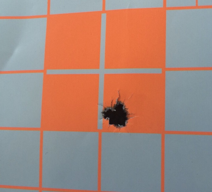

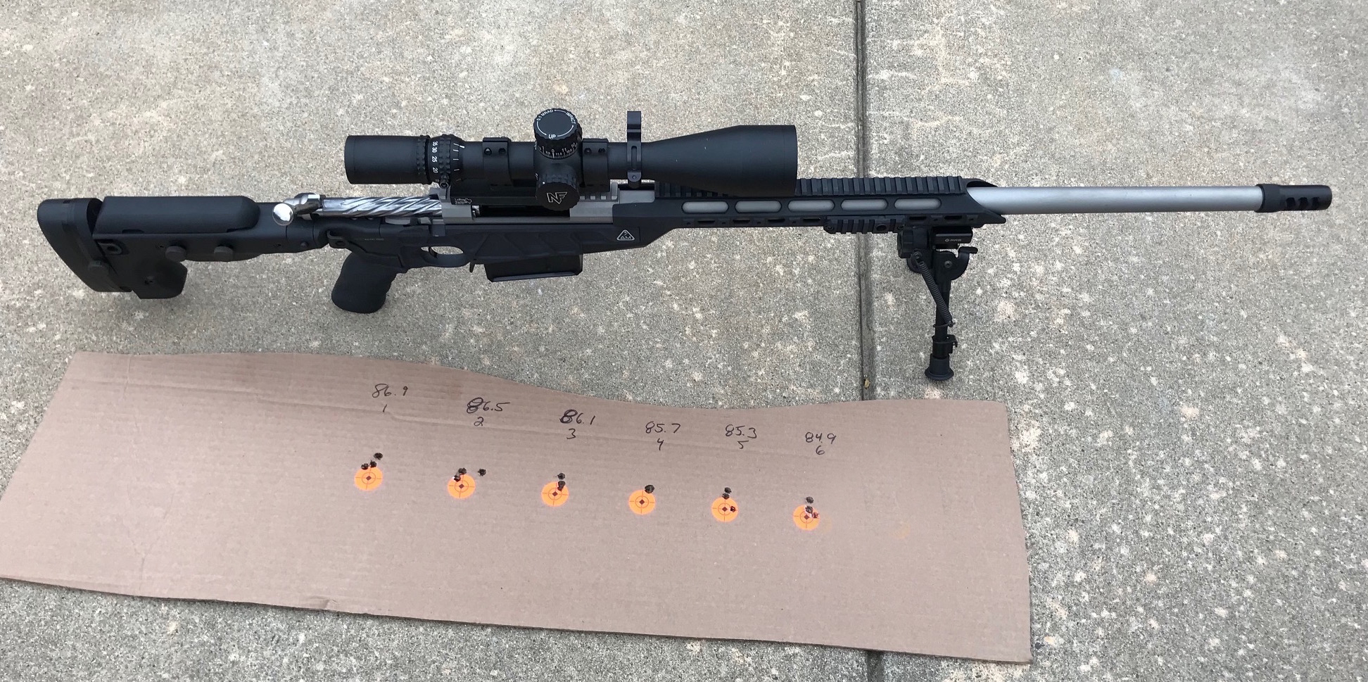

I recently had Adam Busse, from Gunware.net, build me a 300 Norma Mag rifle. I used a Defiance Machine Deviant Tactical action, Bartlein 1:8 twist barrel and Trigger Tech trigger. It is sitting in an Accurate Mag chassis. Test was shot on a bench with bipod and rear bag.
I worked up a load test with Berger’s 230gn bullet and Retumbo powder. The 85.7gn turned in a 0.1MOA group!!

Love me some 300 Norma. I would load more in the 87gr window and do it again. It’s unlikely that a less than 0.5% charge in either side would make that much difference. When you are loading .223 a 0.4gr charge difference is significant. When loading 87gr it’s really not significant. I think it will shoot but I would not be convinced in the load yet. My Norma has a charge window of about 1.5 grains where it shoots. My groups really shrank when I jammed the 230s into the lands. It’s a 3/8 moa gun.
Nice. That is a pretty narrow accuracy window. Went from ok, to awesome, to ho hum.
I agree. I'd test that one again for sure with those type of results beside it. Nice group for sure, but considering the ones on either side of it, I'd make darn sure that wasn't a fluke before I loaded up a bunch of rounds with it.
I disagree. I’d probably hang the rifle up with that target and never touch it again :LOL:
At the end of the day, what you see in the target always is right. Great shooting, I be happy with 25% of that target!
Not necessarily, I've saw loads that looked pretty good but could not repeat one stellar performance. Statistics bare that out and it takes several 5 and 10rd groups before I say "this is the load"...
I had one group like that with my Savage 10VT and factory 168 FGMM. Got a picture of it somewhere, so I agree 100% with framing it. The rifle was normally around .5-.7 MOA with that lot of factory ammo, but especially with 3-shot groups, the odds of an outlier small group are not that impossible. Still an awesome group. But don't count out statistics and probability when you're doing load development.

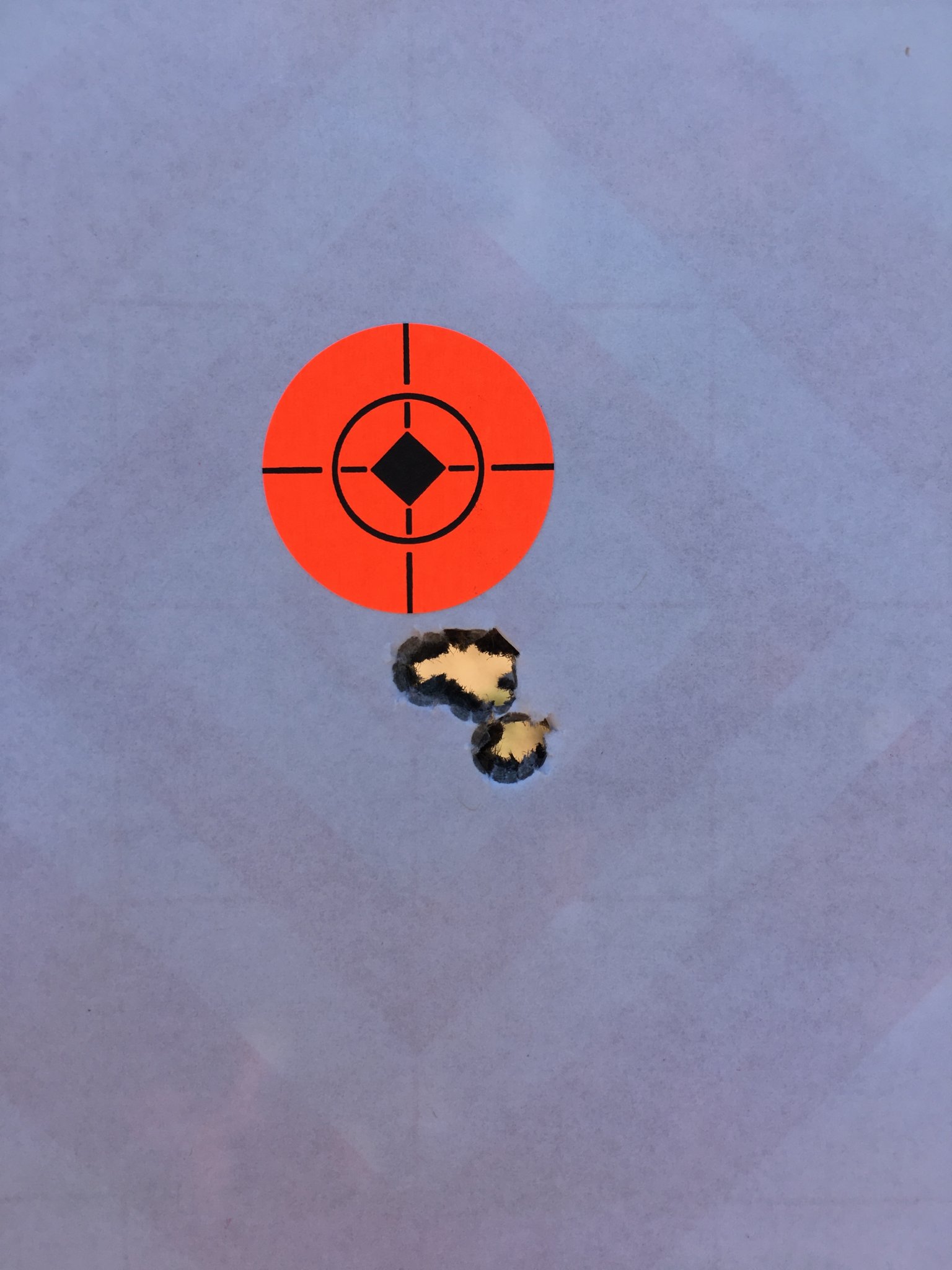

Well, I was going to post one of my groups, but damn, y’all are making feel bad. Screw it. I’m gonna post it anyway. Shot this today at 100 yards during load development. 5-round group. 6.5 creedmoor, 140gr ELD-M, 42.2gr. of H4350. Yes, I yanked one.

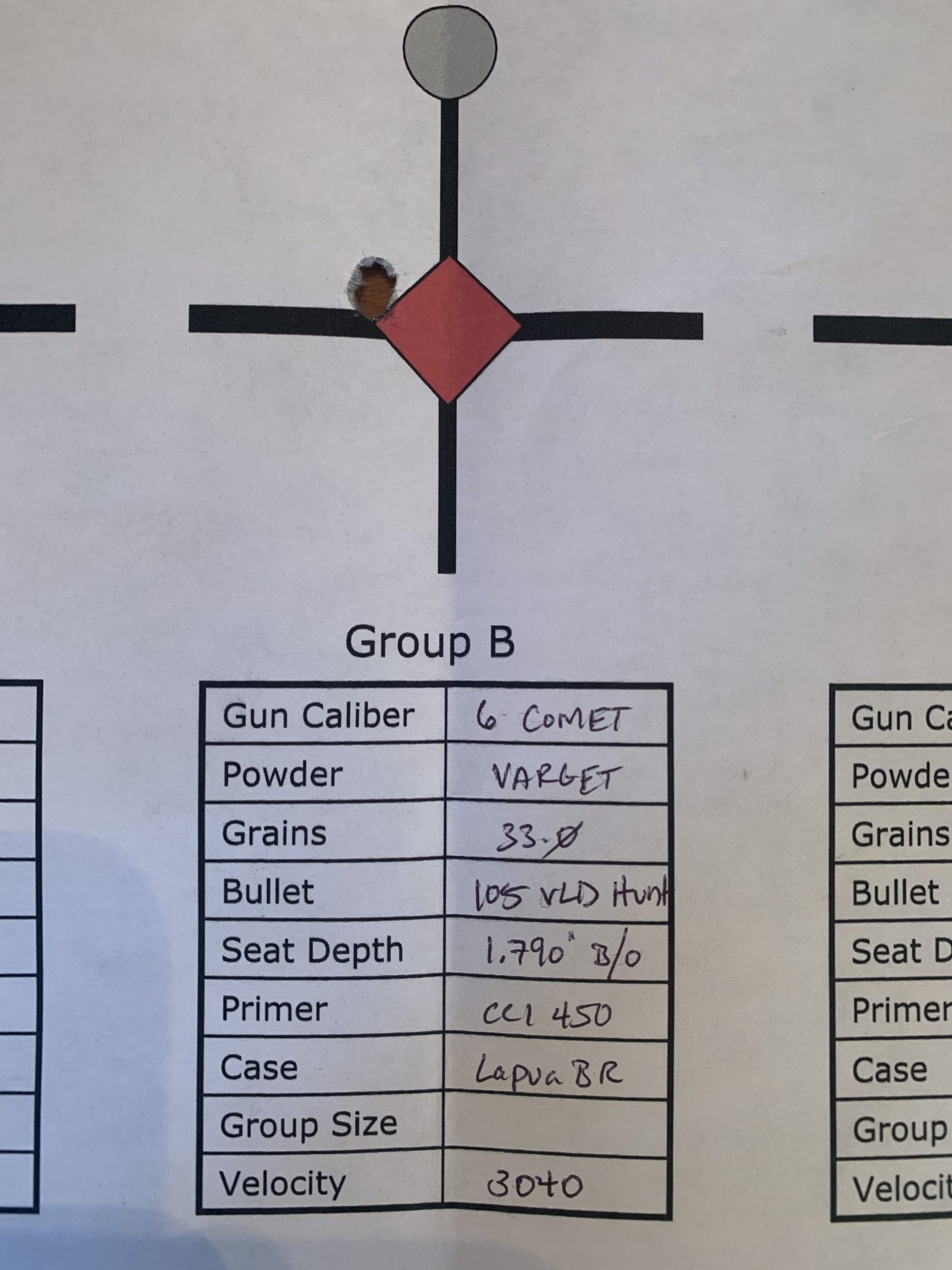

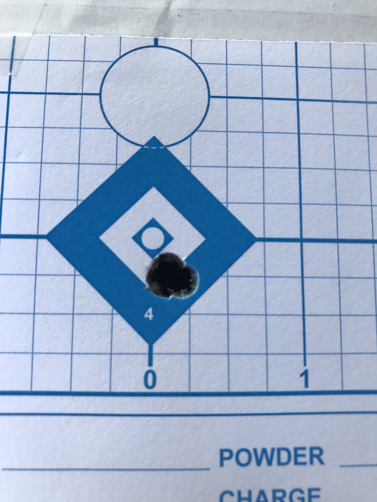

This is my best 4 shot group with a 6br. Sub.1 it will do this in 3 shots at least once a week
Thought the same thing, should stop shooting it and save it, but whats the fun in that. NONE
Just to add, all my groups are off a Atlas bipod and rear bag. Shoot as you would normally.

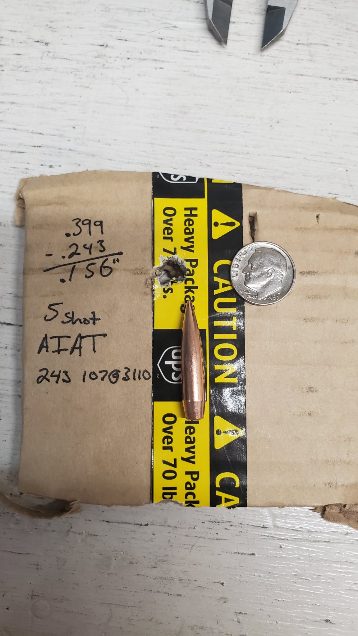

It's always exiting shooting a wallet group, isn't it! Got mine in the pocket right now, a .174 5'er. That was out of my first 6x47L barrel in my old MAK tubegun repeater. Lost count on the 3'ers that were smaller when checking zero.
Kinda funny but half the groups I shoot now with my 6mmBR are 5 touching, something my 6x47's wouldn't produce, but I haven't shot smaller than mid .2's yet with it.
What turns my crank is small vertical at a long distance, got 4.5" vertical for 12 shots at 1025Y with the 6mmBR which was awesome!!!
^^^ all the above off the Harris.
The 6mmPPC single shot bench rifles I had were just silly, the worst group I shot when working the load up was 1/2" and low .2's were common, that's 5'ers, eh that's to be expected with them off a proper rest. Actually after a while it's boring which was half the reason I sold them.

Load more of the same exact load you fired your tiny group with. Shoot 3 or 4 more groups of that combination back to back and post the target in this thread. My money is that your agg. will be right with the other groups on your original target that had multiple groups.
Not knocking your ability or saying anything bad about your rifle. Just saying that zero conclusions should be drawn from that single group.
