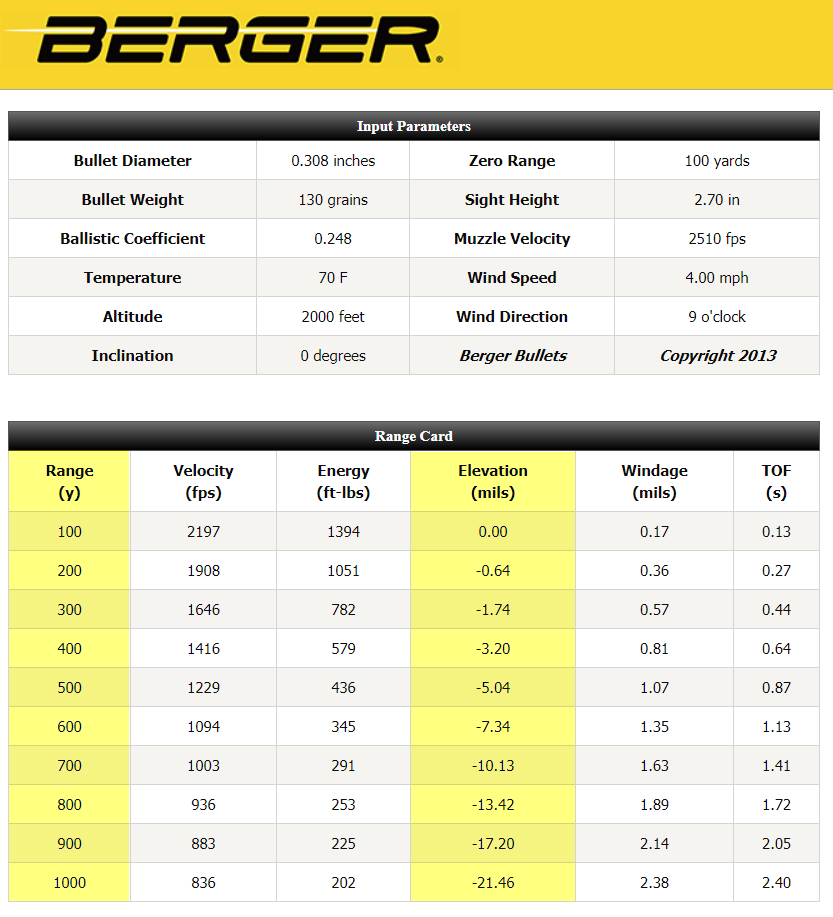

Just to clarify a bit more on my statement about inches vs. mils, I used the ballistics you provided above and ran some average atmospherics into the Berger calculator (https://bergerbullets.com/ballistics-calculator/) and this is what I come up with using the BC for the Speer Hot Core 130gr
Based on the above data, your theoretical maximum with a 0 MOA cant will be 900 yards (this will vary based on your atmospherics). I can see this from the column Elevation (mils) which shows drop at 900 yards of 17.20 mils and since half of the scopes total elevation (35 mils) is 17.5 mils as you said, this should give us a theoretical limit. I say theoretical because rarely are you able to zero perfectly within the middle of the elevation, even with 0 cant, there is usually some tolerance +/- so once you do zero your scope for your ammo, set the zero stop and spin those turrets to the top to identify just how much elevation you have from zero. But even at your elevation max, remember you still have the reticle to use as well

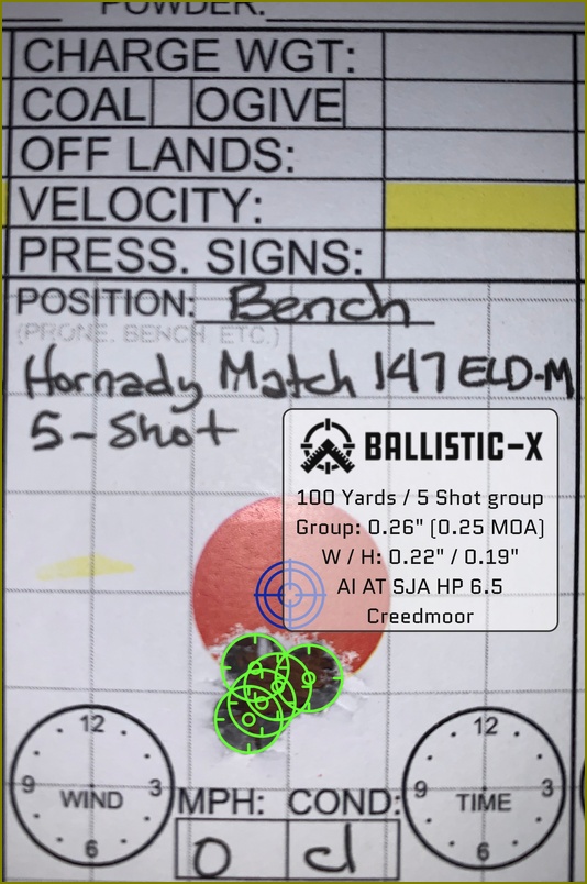

But if all you want is an app for now, Applied Ballistics is great. I think I have 5 different ballistic apps on my phone, but with the Kestrel and my Leica 2700.com I rarely use these apps anymore except for Ballistic-X, the reason I like this app is it has a feature that allows you to take a picture of your group on paper or steel and you can measure right on your phone, here is an example
(disclosure, this is the best 5-shot group I've ever shot and definitely not the norm for me, I'm usually a .5 - .75 MOA shooter :D)
