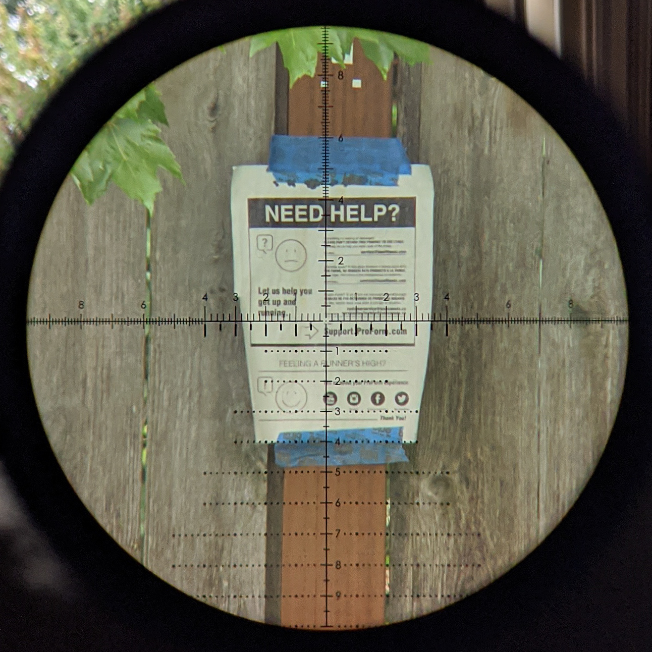

This is at 20x for a Razor AMG.

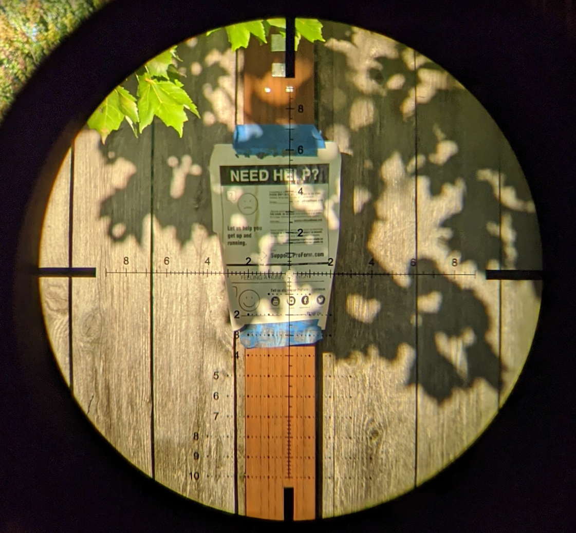

This is Ares ETR at 15x
