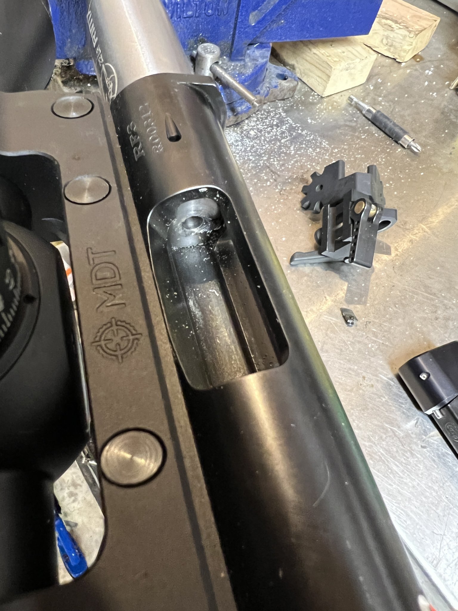

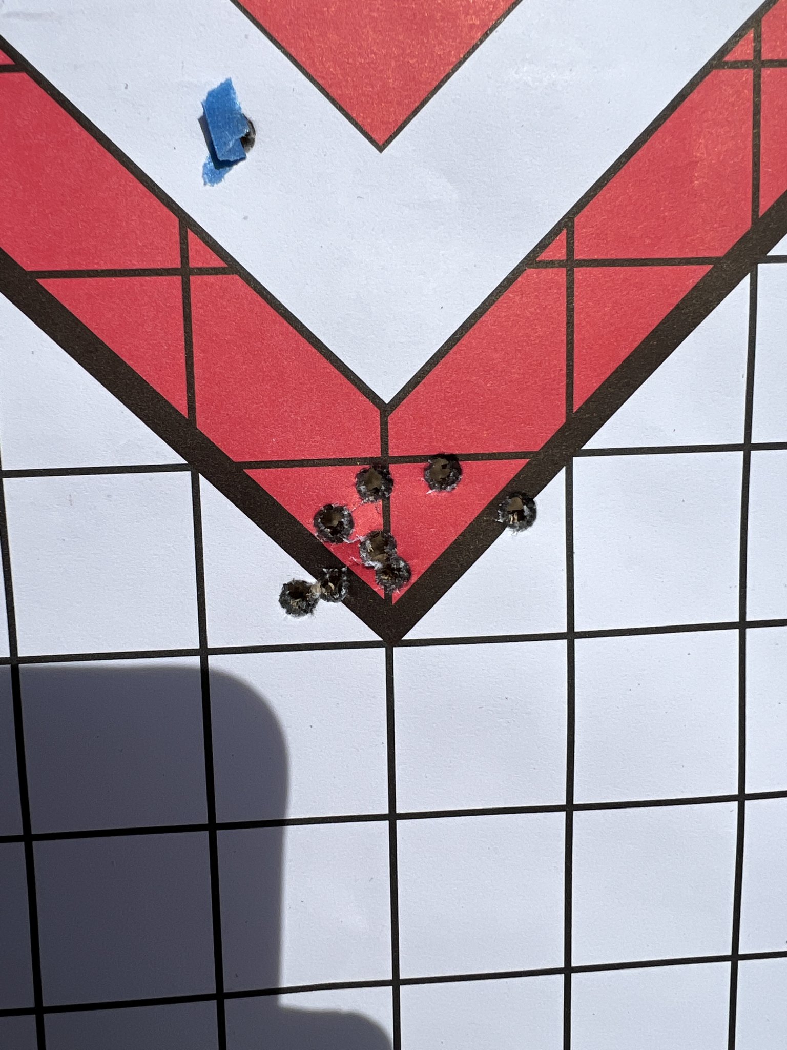

    After an absolute rediculious wait (I was told 6-8 weeks max and it ended up being 17) I final got my 1:12 RimX barrel. I chose the Padom chamber because I have 4 others barreled chambered with this reamer by Keystone and all are hammers.
    I wanted to try the 1:12 twist because I have heard it really makes a difference beyond 200 yards. I shoot Center-X and have 20k on hand and have no intention of switching.

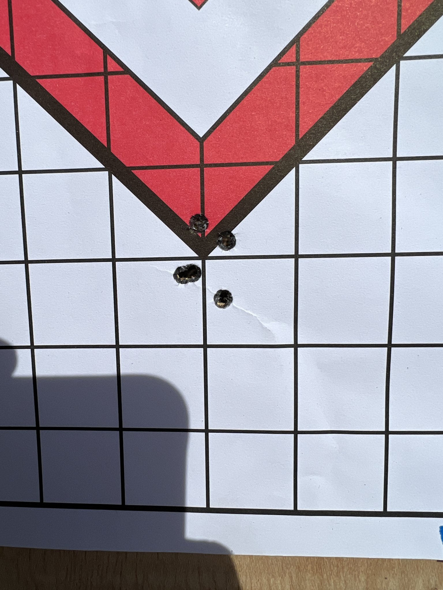

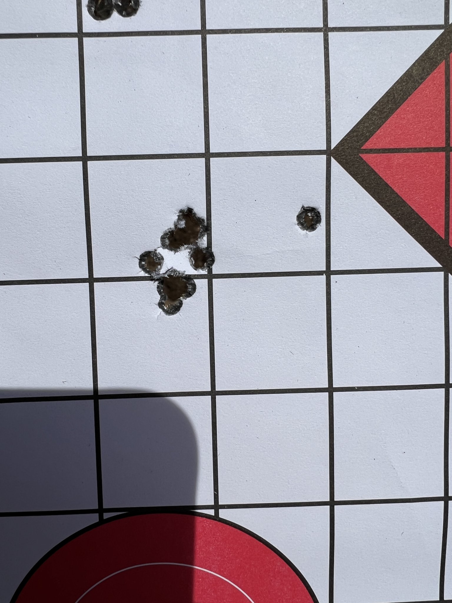

    As see in the pics, it groups like absolute shit. All of the targets were at 50 yards for a very secure rest. I tried with and without a suppressor and it made no difference. I also noticed that it was shaving a ton of lead from the bullets as seen I the action pic.
    I contacted the smith, (mind you that I am already pissed about the delivery delay) asked them for a refund and of course they told me to pound sand (way to stand behind your work) so I am probably going to ship the barrel to Keystone for a rechambering.
    Anyone have any suggestions as to why this would shoot so bad and shave lead?

    Yeah that’s worse than my buddy factory T1X with CCI SV.
    For my RimX, I went with Primal Rights 1.5deg chamber. Very very happy with the accuracy.

    At this point I’d out the smith so other don’t run into the same issue. And probably not what you want to hear but have you tried a tuner if all else fails? If John can’t fix it I’d hate to see a new barrel wasted you know.
    As for the shavings that’s really weird, no chance of a burr or something in there?
    Tuner or not- the lead shaving is a awful. It looks like my gsg16 after a 1000 rounds of crappy bulk 22lr
    Zoom in on the one photo. It's PVA.
    I shot 100 rounds yesterday and the 3 targets I posted were the best groups by far. The lead shavings created a feed ramp due to the buildup, which is just crazy. I put my keystone barrel back on today and it is one hole at 50, as it should be.
    I can't say that I have had the same experience my particular M24 12 twist PVA shoots well with several lots of Center-X and even better tuned. I have a friends here on the hide that can attest to it and another who bought one in the same batch I got mine and he's happy of how well it shoots. As for your shaving, I would check magazine ride height. I set the notch on mine as high as it will go to touch the bottom of the action and lock in the magazine catch then I drop it 0.010 of an inch. I take note of the gap measurements as I have 2 RimXs in 2 different chassis systems and only 4 mags, but depending on which gun I shoot will adjust a 3rd mag (from the other gun) to take with me.

    I have to forcibly seat the mag to get it in. There is no play or wobble with the mag.
    I would try cleaning the chamber then shoot some groups at 50yards but load the rounds directly into
    the chamber not through the magazine so the bullets to not get shaved.
    If it still shoots bad then you know its the barrel.
    You can't load rounds directly in a RimX. That's why mag ride height is important as well as ensuring the extractor plate cutout isn't compromised.

    I have the same barrel and I can’t say that I’m overly impressed. It shoots center-x worse than some bulk ammo I tried. I’m not going to bother calling them as each time I contacted them i was told something different that turned out not to be true.
    First thing I’d try is to slide them under the extractor by hand, skipping the mag, and see if you can get some that haven’t had a buzz cut to shoot acceptably.
    That said with respect to the refusing to try something else… try a different lot or a different bullet. In my Annie or win52 centerx shoots like shit just like yours and eley rules the roost. In both martinis the eley shoots like crap and the centerx is the go to. It’s not strange for rimfire especially to like something and not another.
    This reamer shoots Center-X like a laser in the 4 other guns I have, all RimX. I have too much Center-X to mess around with another brand. I have tried 5 lots of Center-X since I have loose ammo left from other lots and they all shoot about the same, which is like shit.

    Is it a possibility that this barrel just doesn’t like center x? Will having it rechambered improve accuracy or will this barrel still not like center x?
    I’m very new to the rimfire game but does the chamber have a lot of effect on the accuracy or is it more for reliable feeding on certain ammo?

    2 things I'd be curious to know if you have checked other than the mag ride level I mentioned prior. Is the extractor plate on the bolt torqued on properly and have you actually checked the headspaced on the installed barrel with the Zermatt supplied NOGO gauge? I mention these because I have experienced the one and know of another owner that experienced the other with different barrel. As much as I like the RimX design, I do believe that there as possible situation where tolerance stacking between the barrel and receiver can cause issues. So much so that the with next barrel I have spun, I'll be sending the action out to the smith so he can base the actual numbers as closely as possible for the best fit.

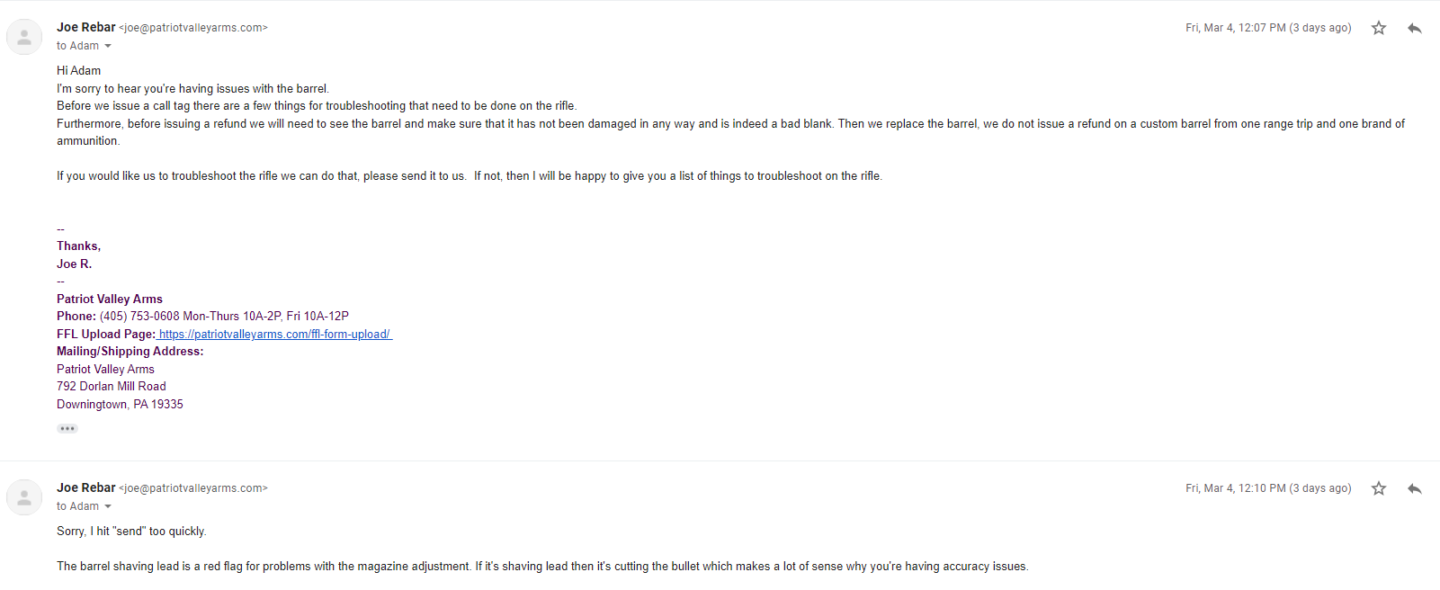

    This is one of our barrels. It was late, but that’s beside the point of the bashing here.
    The OP emailed demanding a refund. He stated poor accuracy and it was shaving lead terribly. I replied yesterday AM. I have not looked at the shop email today as it’s Sunday and I didn’t work today.
    What he failed to accurately state was what I replied. In fact, his statement is pretty far from what I said.
    We did not tell him to pound sand, I told him there was some stuff that needed to happen first, namely checking for adjustment and setup issues. Shaving lead indicates magazine height problems. Shaving lead is also going to cause accuracy problems. It does not indicate a bad barrel.
    I also explained that if the mag height wasn’t the culprit that there were other things to look for in the rifle assembly. We could do it for him if he sent the rifle in or we could step him through the process, his choice just let us know.
    If the barrel can’t be ruled out then we would bring it back, evaluate it, and potentially replace it. We do not simply refund a barrel after one range trip with one lot/brand of ammo, especially when the rifle is exhibiting signs of improper assembly (shaving lead).

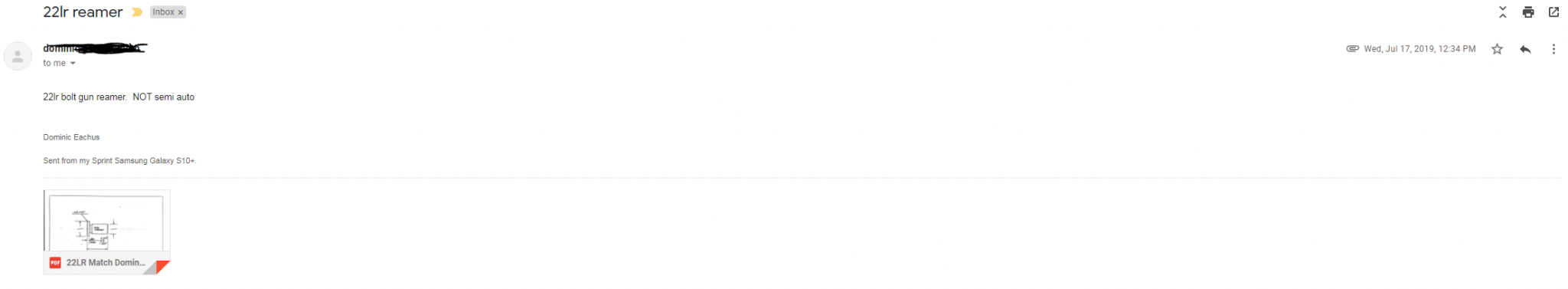

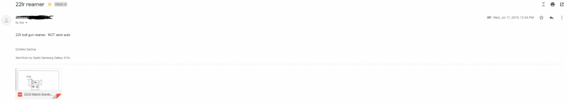

    As far as it being a proprietary reamer, that’s news to me. Padom handed the print to me himself and we sat in my office several years ago discussing the differences. We offered his chamber and a modified Bentz since we started doing RimX barrels.

    So @bohem what about this noise about you guys potentially not having the chamber reamer for the chamber the guy ordered? I’m assuming he ordered it that way and there is some order confirmation, but if not, could you clear that up too?

    If the lead shavings are only happening with the suspect barrel, and not the OP’s other barrels, on the same action, why would mag ride height matter?
    Unless he’s running the action in multiple stocks or chassis, shouldn’t the ride height be the same for all barrels?
    See above, I added that.
    I don’t know who told him that the padom reamer was proprietary and I wasn’t supposed to have it. I was given it by padom several years ago.

    I will make a note to post a screenshot of the email reply tomorrow. I emailed him back, said what I stated above, and went about my day with the weekend. We had friends in for the weekend and I have not been back to the shop emails since yesterday morning.
    We stand behind our products, but keep in mind: buying a prefit means people are buying one component, not a whole rifle. I have no control over what trigger, chassis, etc they’re putting it in. When fitment or assembly issues arise we always attempt to help but I do not simply give refunds because someone asks. I also told
    him we would replace the barrel of it was proven to be bad. There are a few folks out there who had a barrel replaced by us. It happens, and we stand by it. More often than not the problem isn’t in the barrel or the machine work, and I’ve learned a lot about helping people troubleshoot assembly problems via e-mail over the past few years
    Sometimes it’s as simple as a lot change or brand change in the ammo.
    Some ammo types have a very distinct, abrupt step on the bullet to dealing band. It is there for a few reasons, one of which is to cut a nice ring in the paper target. That abrupt step on the ogive to bearing surface transition makes for a nasty spot to catch on the mouth of the chamber, especially for a dead soft lead bullet in a 22
    There have also been a litany of problems with certain chamber jobs by certain smiths and the RimX. Many of them stemmed from the amount of chamber mouth chamfer that is cut. In fact the problem was so bad that in Q4 2020 I was asked by Zermatt if they could send customers to me to modify these barrels because there were so many ignition issues happening.
    We fixed over 40 barrels in a 3 week period.
    More chamfer on the mouth aids in feeding but hinders the ignition. There’s a fine balance to strike and that is “per print” from Zermatt. They have gone so far as to take one of our chamber/tenons and document it on the optical comparator to even confirm that what I have programmed is EXACTLY what the print says.
    We don’t have ignition problems but there are times when the lead shaving is an issue and that’s exactly why the RimX mags have a height adjustment in them

    Oh and let’s be clear, there isn’t a mag height issue. I have 4 other fucking guns with RimX actions and none of them exhibit this problem.
    So did you test this barrel on any of the other actions?
    Did you measure/compare the barrel which worked to the one which didn’t?
    Do you have pics of a chambered round which was ejected without firing?
    Lead shaving has a direct impact on accuracy as I’m sure you know.
    Did you try dropping a round in the chamber before mounting the barrel? The coned breech is delicate I’d imagine, and wouldn’t take much to change its shape.

    Lead shaving has a direct and detrimental impact on potential accuracy. Magazine adjustment is just one small part of what could be going on here.
    I am not a gunsmith, that is what I contracted PVA to figure out when I agreed to purchase this barrel from them.
    It sounds like you bought a barrel, not a full build.
    How could they ensure your action to stock interface if it’s not in their hands?
    It’s not the smiths job to fix your mag height for a barrel job and since you can’t claim to have actually checked it’s figment other than “but the other ones don’t” I gotta conclude you’re causing the issues.

    While I would agree with you the rub here is that I reinstalled the old barrel on the same action in the same chassis and it feeds perfectly and shoots one hole.

    Per the initial post: Here's a screenshot of the replies that I sent from Joe's email over the weekend. I was mistaken, I thought it was Saturday but it was Friday. We never said "pound sand"
    Like I said, the print was given to me by Dom several years ago.
    If he wants us to troubleshoot the barrel I'm happy to do that as I said in the initial reply email.
    This entire thread has been an accusation of "PVA screwed me" and "PVA doesn't have the reamer they claim to"
    Screenshots of our communications sure show otherwise. If the reamer has changed or Dom doesn't remember sending the me the print those are different than "they don't have it". Memories are a funny thing, this is why I try to write things down because I know that my own memory is fallable.
    Written communication in email, with a time and date stamp is pretty hard to argue. I've been caught out on things I thought happened until I read through my notes. It happens.

    So far in everything you've said, the only thing that was true was that we were late. I agreed with you in the very first comment I made.
    You told people we refused to help. That was not true.
    You told people we wouldn't support the product. Not true
    You told people that you contracted us to figure out the issue. Again, not true. Your email said that the barrel shot poorly and shaved lead and you wanted a refund. I just posted a screenshot of our reply so there is no ambiguity. We offered to give you a list of things to look at, suggested looking at magazine height and offered to trouble shoot the entire rifle for you if you wanted to send it in.
    Then there's the question of the reamer. I don't know where you got that information from but it's patently false as well. If you're getting information from the gunsmith you keep mentioning you might want to be a little careful with believing everything he tells you. There's an axe to grind there. He screwed up so many RimX installs in 2020 that he was almost black listed from buying the actions. At the request of the action manufacturer, I fixed literally DOZENS of barrels by that person.

    Just so the facts are straight, we were discussing 22LR chambers at your shop in 2019 before RimX was even released, I remember it very clearly, no I didn’t forget like you stated in your post. You told me you wanted to make a 22LR chamber using a BORING BORE and not a reamer as a fun test project like Aaron @ Zermatt had just done and you wanted a good chamber to go off of and asked me for my print. I gave it to you. Yes my chamber is marked proprietary at Manson. Did Manson make your reamer for you with my print?
    No, you NEVER asked me if you could have a reamer made and sell it at PVA just so we are clear. You never asked me that, you never contacted me and told me you had a reamer made off my print, you never asked me if you could sell it, you never told me you were selling it. You only asked me for my print to use to write a program off of to make a chamber using a boring bar like Aaron had done.
    So, when I see this thread, and get contacted and initially the smith was not posted/discussed and I know for a fact I only had 1 physical reamer made and gave it to Keystone after they were done cutting all my RimX test/review barrels and I know thats the only shop that has my reamer and has asked me to sell my chamber.... and my print is marked proprietary at Manson...... how would I respond to someone about another shop claiming to be cutting barrels with MY reamer??
    Is it a big deal, no. Especially if you asked or let me know... Did you ask me to have a reamer made and sell it at PVA? No. Did I know until this weekend that you did have a reamer made and were selling it at PVA? no... So hence why this guy was told nobody has my reamer.....
