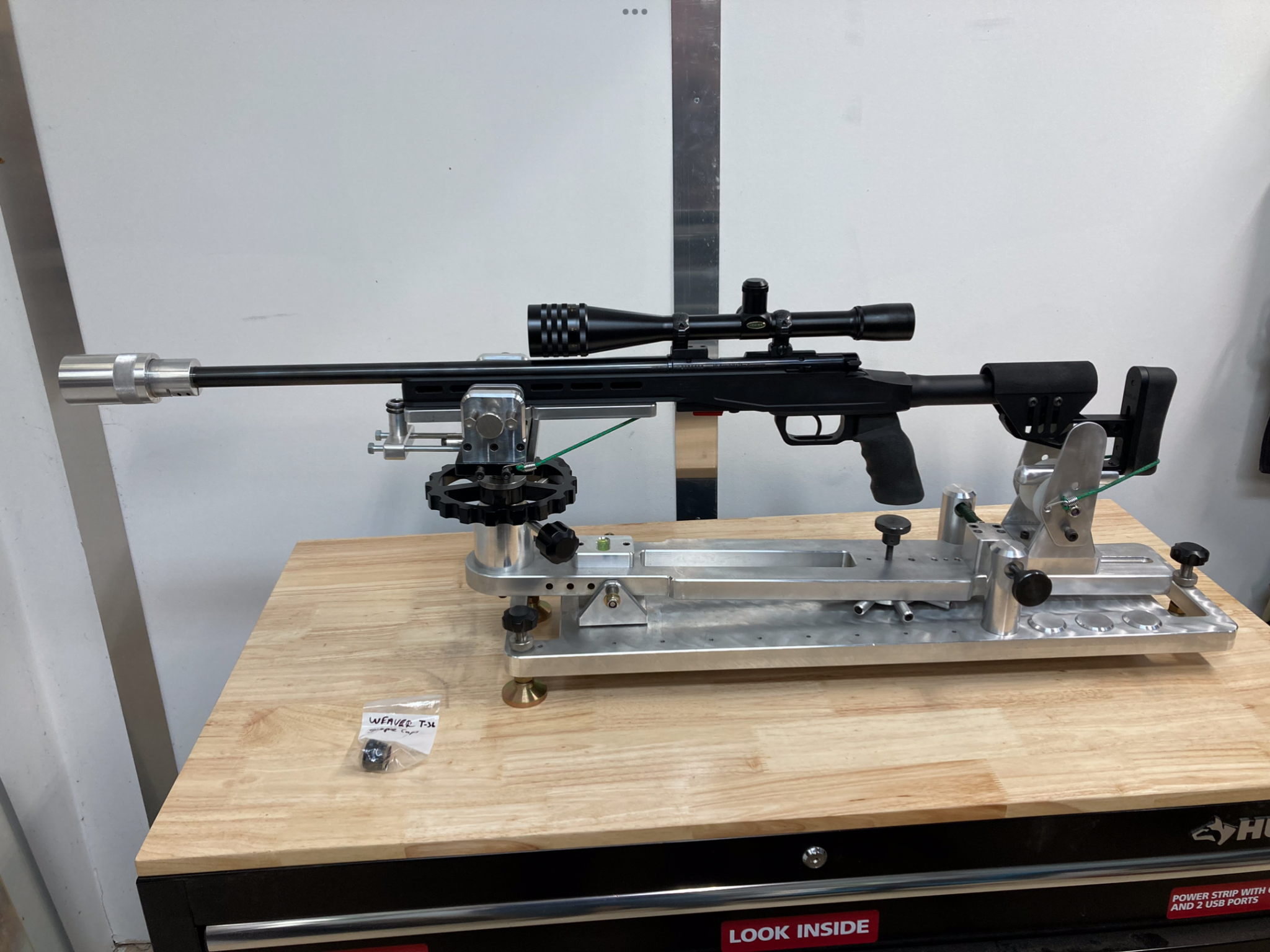

Will a barreled action shoot differently from a non-recoiling fixture vs a return to battery rail gun carriage?
I would think the more accurate of the two (if there is one) would be the starting point towards such a test.

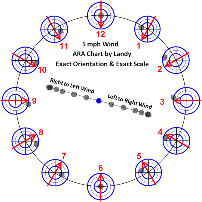

Because of the yaw. Initial angle of bullet yaw after it excits the muzzle is a parameter that deviates from shot to shot (within certian limits). Therefore, small initial differences in yaw affect trajectories, even thou everything else is kept the same. How big can these effect be at 100 meters range? For some low velocity ammo, the 10 shot group is the size of 2 caliber. At least that was the result of simuli for .32 acp . IIRC at 100 m, 10 shot group for such bullet is expected to be about 0.6" dia just because of yawing effects. I don't know about 22 LR

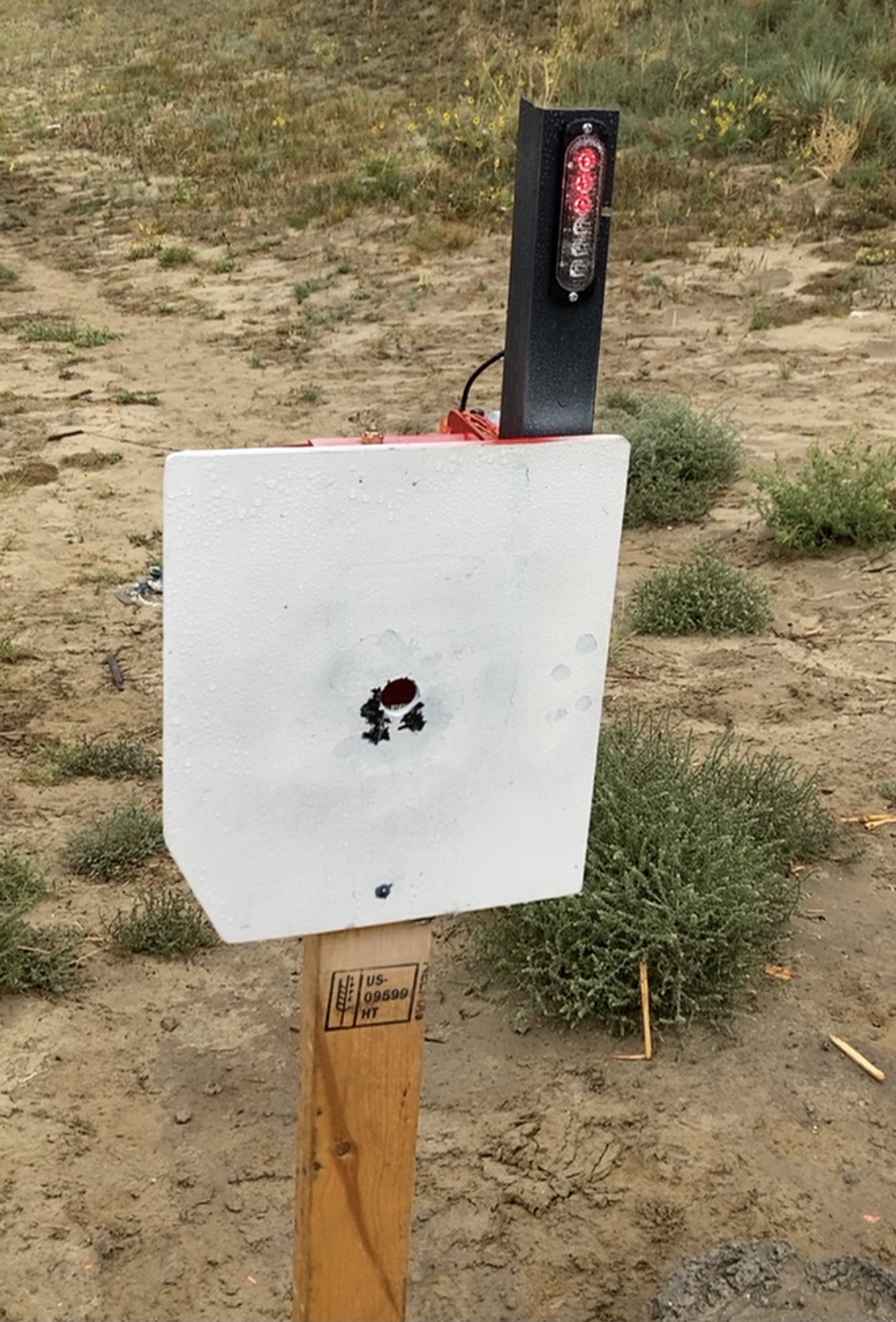

MOA challenge target is a 12x14” steel plate with a 1” hole in the center. Behind the hole is a paddle sw that activates a 5 second flashing LED on top, basically an electromechanical version of magnetospeed‘s electronic target hit indicator.
I will set up an after match side challenge using this target and a 2”-1/4” KYL. Usually have the KYL somewhere between 65-90 yards and the 1” challenge target between 100-200 yards. Competitors get ten rounds and must clear the first 4-8 gongs of the KYL (depends how gusty the wind is) and remaining rounds get to shoot at the 1” challenge target. My goal is to have the KYL knock out about half the competitors and the 1” be a hard, but doable target for the remainder.
Having the 1” challenge target at 200 yards has only resulted in 3 hits in 3 years. Experience has taught me that having the 1” target between 100-120 yards is the sweet spot for the 1-4 shots the KYL clearers have remaining. 1” target has a 15-30% success rate at these yardages. Last months COF was clear first 7 of KYL at 90 yards, 1” at 100. Two competitors cleared the challenge.
Too be fair, I did have one competitor @jefe’sdope clear an older challenge where I suspended a 1” diameter at 200 yards. He center punched a 1” target at 200 with his first shot, blasting it through the backing into the berm somewhere, we looked for 20 minutes and couldn’t find it, that would have been an awesome trophy!
Point is that rimfire ammo is so inconsistent from round to round in FPS that even the high end ammo isn’t going to produce the small groups you want at long range. Ever since a rimfire priming plant blew up a number of years ago, manufacturers changed their priming systems for safety and consistency suffered because of that

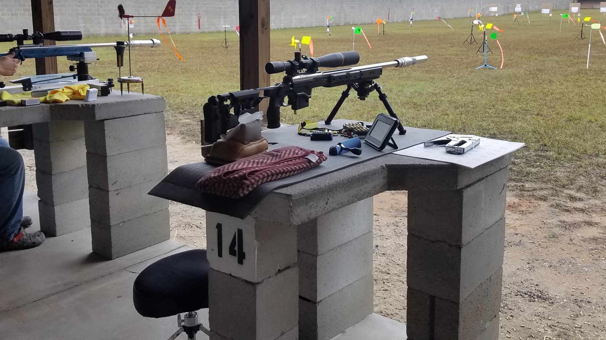

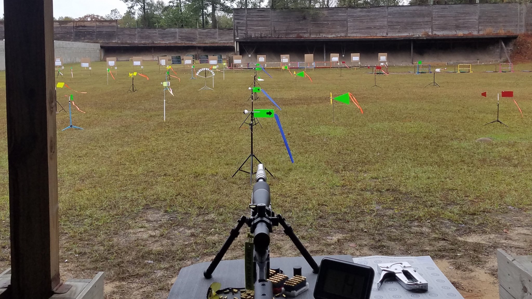

Thank you Sir, I'd be glad to share details with you. Seeing thing helps me sometimes so I'll start with a picture of my setup....rifle and flags.
Vudoo V22S, 26 1/4" Shilen Ratchet Barrel, Harrell's Tuner, Bob's Tube, Bix-n-Andy Competition Trigger @ .3 oz., MDT ACC Premier Chassis, Ergo TDX-0 Tactical Suregrip, Bag Bullet Bagrider, Leupold 40X Competition Scope, Burris XTR Signature Rings, Area 419 Weighted ARCA Rail, Internal and External forearm Weights, 5H Atlas Bipod. Total weight of complete rifle...just over 28lbs.
Graham Rimfire Ball Wind Flags....they come with surveyors tape for tails and I swapped them out for a set of sail tails. I also have a Graham Uppy Downy...It's the third one out. What you see in the picture is a 50 yd set for me and it goes 5yds., 10yds., 17yds., 25yds. and 35 yds.. This gives me a total of 5 flags and I'm going to be adding one more flag to my set.
As far as relative importance.......there are no exacts. The importance changes from day to day and range to range. I find it part of learning to read the conditions present when I'm shooting. Only way to tell for sure is to shoot a couple sighters and get a feel for what is going on. I started shooting over my Graham flags about a year ago and shoot about 1200rds a month. Shooting all kinds of crazy wind while watching my flags is how I learn.
I shoot several conditions while competing and shooting groups. My competitions shooting is timed so I can only wait so long for a shot. My point of aim will change with the conditions if the condition stays long enough.. Sometimes I will get 5 or 6 shots before it changes....sometimes only one.
I will say this about ammo....The fliers I get are mostly me missing a change in the condition and some ammo shoots better in windy conditions. If conditions are calm even my cheaper ammo shoots pretty good at 50 and 100yds..
Is he from the southeast?? I got this name from shooting archery.
Hope all this rambling makes sense. Any more questions, just ask. (y)

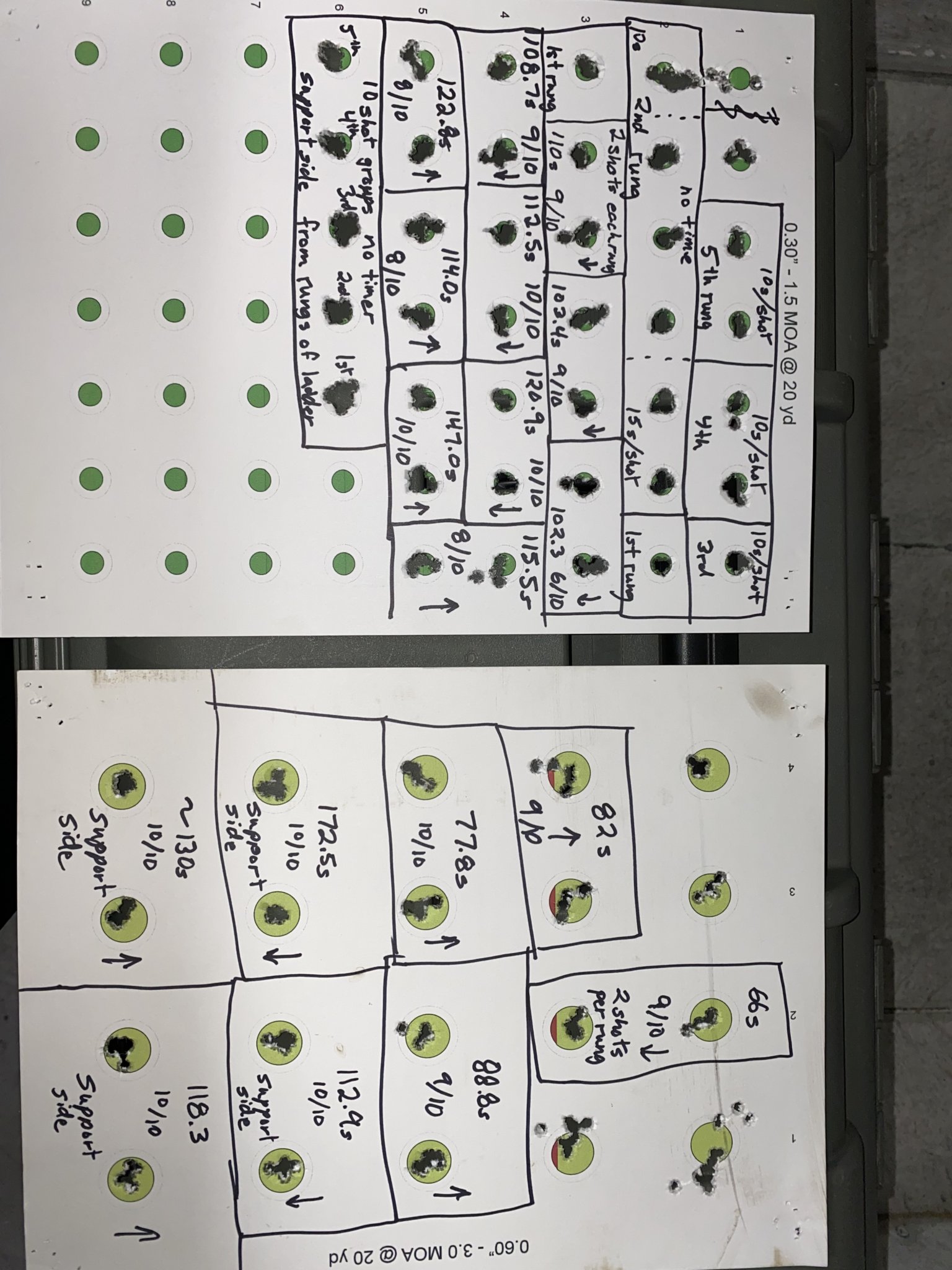

I have a similar set of targets with 1, 1.5, 2 or 3 MOA colored dots surrounded by a 0.223 diameter hairline, scored worst edge. I use them for positional drills at 20 yards. The aiming point is scaled to represent a target at distance, without the 1 MOA bonus of a 22 bullet diameter at 20 yards if scoring best edge. Even at 20x, the hairline isn't really visible at 20 yards, or at least not enough to be distracting.
These are shot off a 6' stepladder, mostly 2 shot per rung and arrow indicates if I was going up or down the ladder. Top of the 1.5 MOA target was starting 1 yard behind ladder, get into position and fire 1 shot within a 10 or 15s par time. Support side means entirely left handed. This really highlighted a weakness in my position on the 2nd rung, kneeing introduced too much vertical wobble so I was better off to take an extra couple seconds and build a seated position.

Wind keeps being brought up and I was assuming everybody knows how crosswinds affect bullet trajectories. That assumption is probably erroneous. Crosswinds have both a horizontal and vertical effect on the bullet path. There are several ballistic wind charts out there, some with conflicting information. I like to use this one by Landy, who is a well known rimfire benchrest shooter. This chart tracks pretty close with what I have experienced when I shot rimfire benchrest and the slanted line is easily to visualize in memory when you don’t have a paper copy in front of you.
Agreed, that is a good chart.

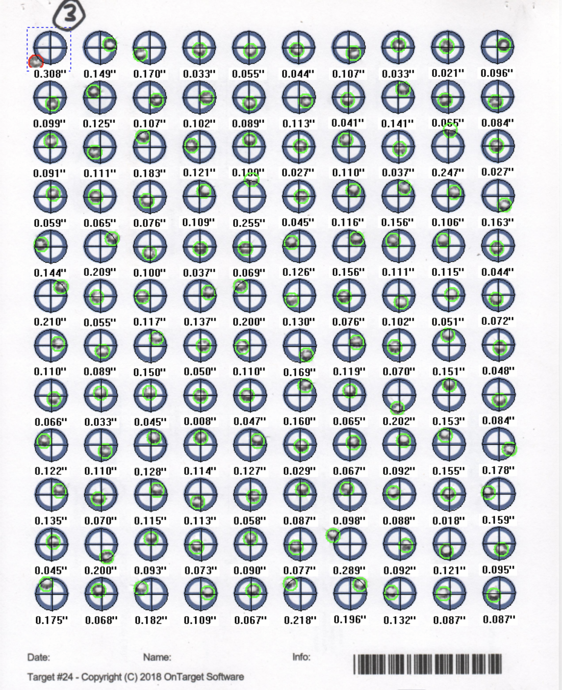

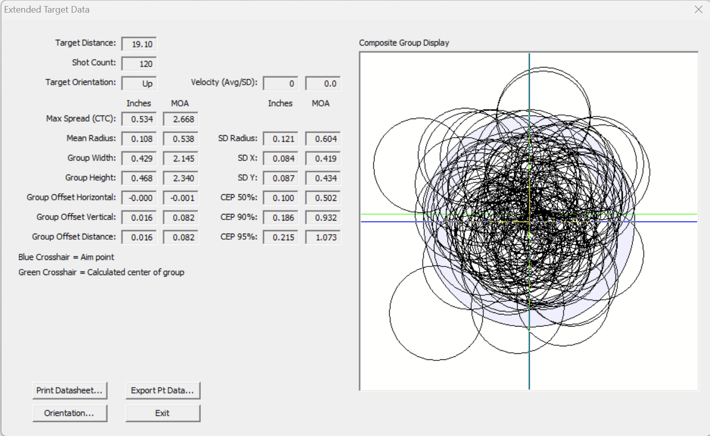

Although certainly tangential to the original post, I've been exploring OnTarget TDS and statistics beyond group size based on maximum center to center measurements. I'm not sure what I've learn applicable to comparing my groups to others on-line and I'm not sure what I'll settle on as performance metrics, but I am unlikely to use max CTC as a primary metric for ammo selection in the future.
I shot several of the OnTarget pdf's (printed on 67 lb paper) last weekend to try the auto shot detection, which I feel is the primary advantage of TDS verses GRT that I used earlier. I was initially disappointed in the auto shot detection of TDS but after several attempts, I found backing the target with brightly colored paper, scanning at 600dpi and adjusting the brightness generated acceptable results. I'd be happy to hear other tips and best practices for using this feature.
This was the only target which detected most shots without a backer, and really illustrates the power of composite groups. For reference the target was shot at ~19.1 yards, from 4 positions on a tank trap with an OG gamechanger, changing position each shot. 25 shots were support side as I was getting bored after dumping several mags at it.
There appears to be a lot to learn from both a system precision and shooter training perspective just from the presented calculated stats, with more to be gained from further analysis in Excel and combining with chrono data.
I also collected 2x 35 shot targets with muzzle and ~18.2 yard velocity but only compiled the raw data into an excel sheet so far. I don't expect to learn much about system precision from these targets (random lot of SK Std+ shot standing from tripod) but it's a data set to explore and think about what parameters can be extracted (BC variation, POI vs muzzle and downrange velocity, etc)
Jeff
Jeff

I shot 25 through the M2 at the muzzle followed by 25 at 100 yards to get an average BC and both Magnetospeed and M2 at the muzzle to get a correlation (several fps slower as the M2 is not truly at the muzzle and a maximum a couple fps random noise). At 18 yards measurement error is significant (and possibly magnified by trying to minimize moving the M2, "No Data" were errors from shooting close to the skyscreen supports), but at 100 yards it will be much less.
Jeff
Reactions: bulletbluesky
Jeff
Some differences are dramatic to put it mildly. Measurement errors are there for sure. LabRadar would be of big help to rectify that. But it's some start anyway
