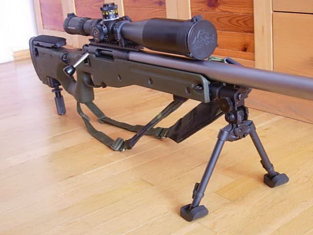

here is a pic, doesnt look too dainty.
Re: 1.250 straight 6.5mm barrel??
This was my RPA action, AICS 2.0 stock, Border 5R barrel - 32mm (1.26") diameter no taper, 28" long. Cal .260 Rem. It shot very, very well.
[/img]
Plenty of room in the AICS stock - the RPA action has a long tenion so no issues supporting the barrel (I think the m2008 action also has a long tenion).
