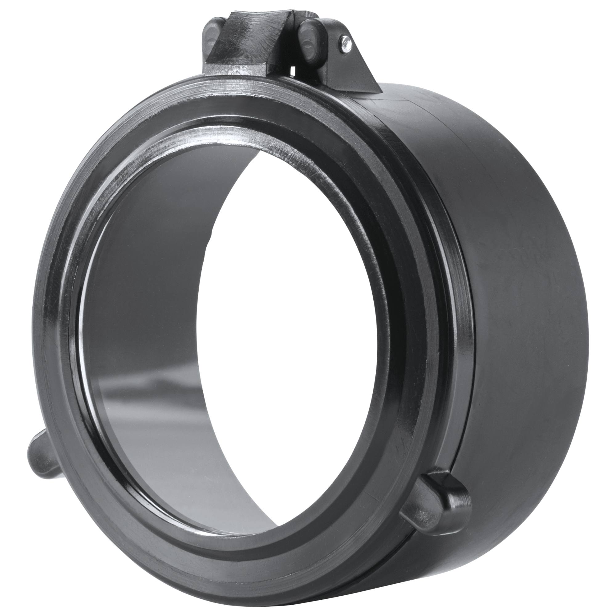

Does anyone make a set of see through flip caps? If not for the front for the rear. This is about to see some hard use and that lens if close to the edge.
Reactions: FatBoy
No clear lens for the front with Tenebrex. The rear is two pieces. I’ll just wait…
